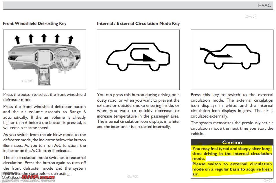

This is what the Car's owner manual says;
Car A/C in fresh air mode?-img_7774.jpeg

I checked the user manual and there seems to be no mention about the auto mode. But it is suggested not to use the re-circulation mode continuously for long drives.
Car A/C in fresh air mode?-hvac.jpg
