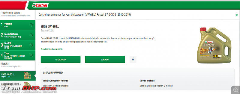

As the name suggests the “Castrol Edge Professional” is supposed to be used by “Professionals” in the service centres/garages. This range is only available in large package sizes such as 210 ltr drums. In some of the markets Castrol uses a dye to differentiate the product from the regular Castrol Edge.
As per Castrol’s global website, the VW 125KW, 2ltr. TDI engine is supposed to be serviced by Castrol Edge 5W-30LL or 5W-40.
Is your car equipped with a DPF? If so then this product should not be used if the package says so. It would be better if you ask VW India for the clarification regarding usage of this oil by the service centre.
