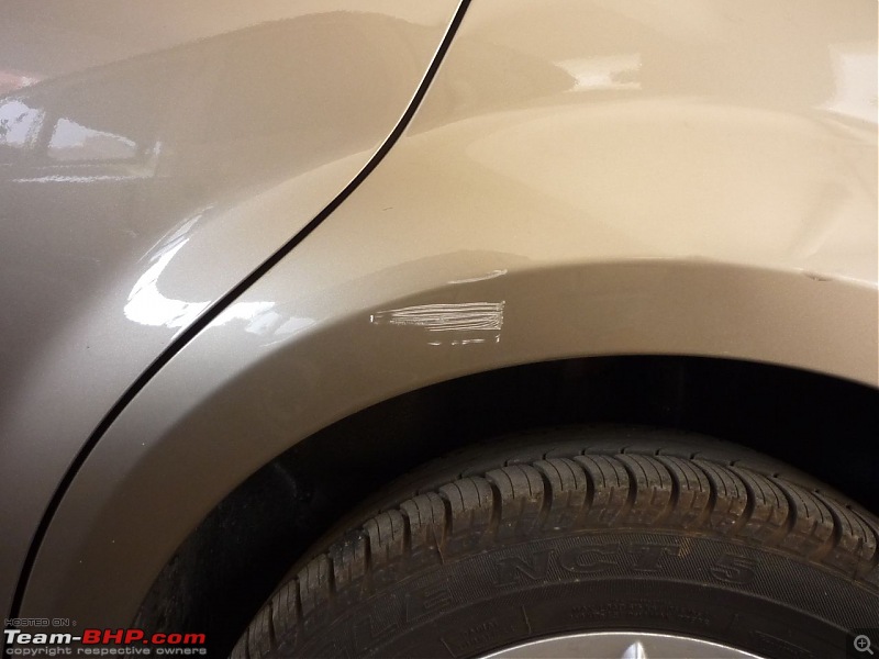

I ended up putting two small scratches on my car. Luckily, not on the metal. Both were my mistakes. One evening, I was a little distracted while parking my car and ignored the parking sensor alarm. Bump. Right rear corner of the bumper has a small bruise. My heart sank when it happened.
The next bump happened when I was trying to give way to another car and I reversed without looking into my rear view mirror. Again, I ignored the parking sensor screaming out and knocked down a biker. Now; I did not really hurt the rider. I barely moved and I heard a bump. Almost immediately, the riders voice could be heard even though I had all my windows rolled up. He was screaming and then, with his hand, with all his might, hit what sounded like the boot lit twice. The sound of it made me think there could be a ding in the boot. I parked the car on the side street, got out and picked up the gentlemans bike and apologized to him. He kept abusing me endlessly inspite of telling him it was my fault and apologizing to him half a dozen times. When he did not stop abusing, I felt like slapping him but felt it may lead to serious issues. I had no patience left and abused him endlessly. We were just yelling at each other. After a while, I felt this was going nowhere and waited for him to be done abusing. He had got onto his bike. When he stopped, I asked him, are you done, apologized once again and left. He still had words left in him. I walked away ignoring them. This incident made me sad. People today have no patience left in them. This man was not injured, no lid as usual, his bike was already in such a sad conditon that I could barely make out if I had actually caused any damage to it. He was so furious with what had happened, which was hardly anything.
