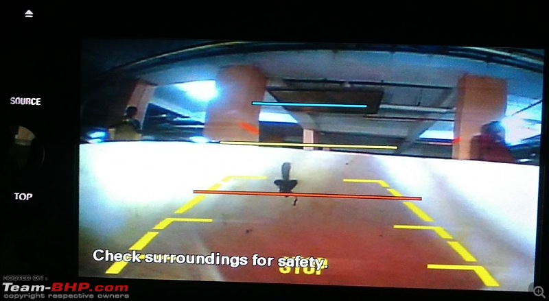

Upgraded my cars rear, brake and reverse lights to LEDs. I recently upgraded the headlight to 100/90W and this was done to reduce the overall battery drain during night drives.
Very simple procedure and took less than 20 minutes to swap the bulbs
1. Bought the bulbs from Aliexpress via china registered post, got the bulbs in 18 days delivered.
Store:S&D Official Store
Review: 1st-gen Maruti Ertiga-1.png
Review: 1st-gen Maruti Ertiga-21.jpg
2. Removed the rear back-light cluster by removing two screws and twisting/pushing gently the assembly with a screwdriver covered with cloth
Review: 1st-gen Maruti Ertiga-31.jpg
3. Swap the bulbs and check the working of bulbs. If not working swap the polarity
Review: 1st-gen Maruti Ertiga-41.jpg
In the below pics, left side bulbs are changed. Park light and brake light are slightly higher intensity, but reverse light is way brighter. You can see that from the below pics
Review: 1st-gen Maruti Ertiga-51.jpg
Review: 1st-gen Maruti Ertiga-71.jpg
from the rerversing camera, see the difference in intensity.
Review: 1st-gen Maruti Ertiga-61.jpg
4. Do the same to other brake light assembly
Final Result:
Review: 1st-gen Maruti Ertiga-81.jpg
Review: 1st-gen Maruti Ertiga-91.jpg
Overall very happy with the money & time spent. I didnt want a park/brake which was very high in light intensity and the one I purchased almost matched with OEM bulb. (I was planning to cover few LEDs if the brightness was very high)
