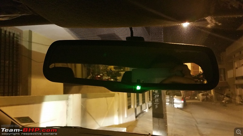

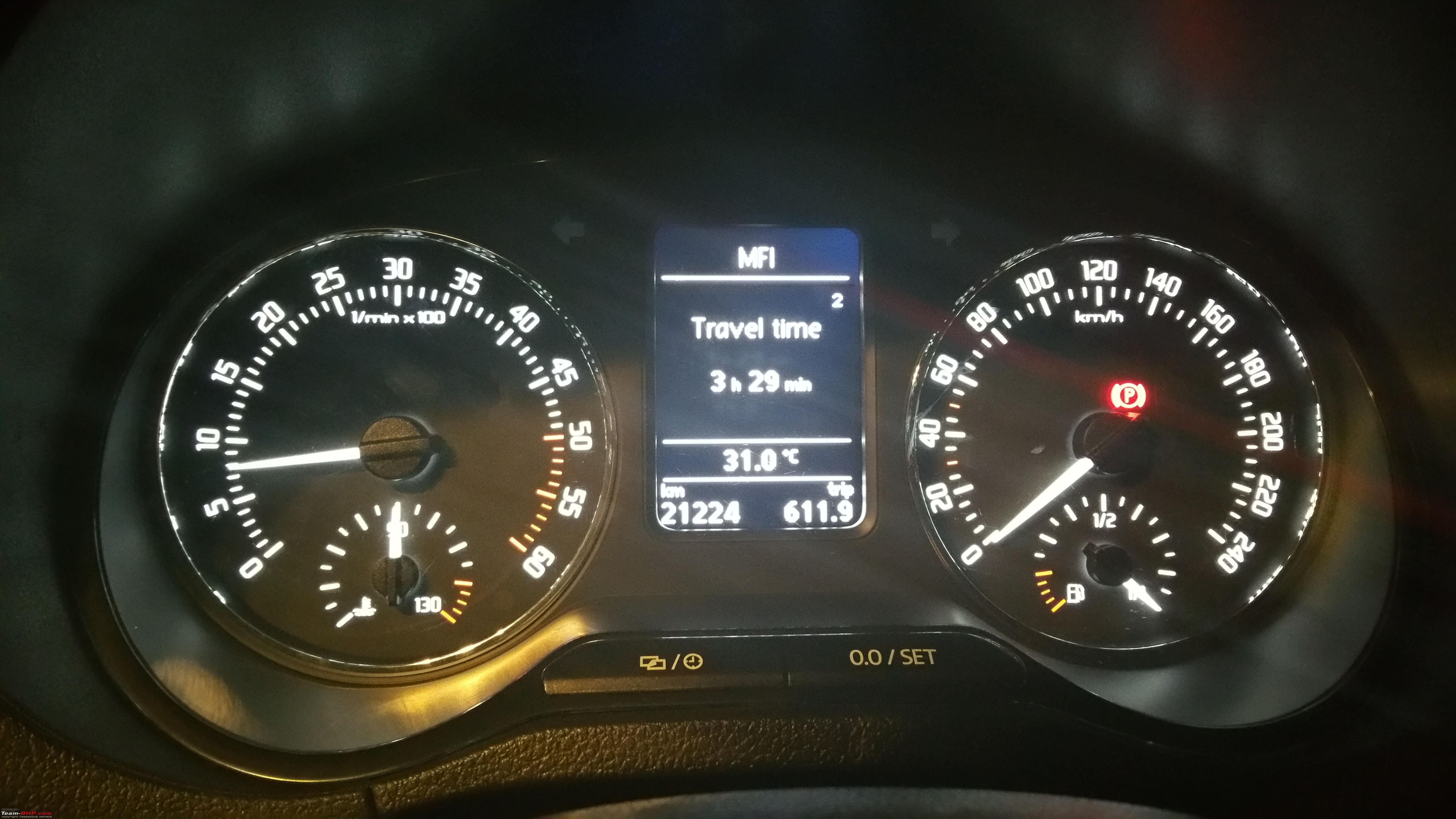

I have attached some pictures taken from my phone around a couple of hours back. Will ask my friend's DSLR to take some pictures.Sorry for the quality.
The Cluster suits fine. Only minor difference apart from change in the look is that when you start the car it shows up as Skoda Information System. Nothing else is changed. Apart from this, I have all the warning lights which were present in my Old Cluster. This is the major change compared to other petrol cluster since the maxi dot cluster installed in my car is from a diesel car. It is from a 2012-2013 Skoda Fabia Diesel .
I have not got any coolant connector from VW so just connected that corresponding pin to ground to avoid low coolant warning.
About the new clone cable,please send me the link tanveer and may I also know what are the new features added on top of 12.12?
Originally Posted by Vik0728 View Post
I think its about time you post the pictures and all the updates Suraj.
I remember the last time we spoke you were all excited about the parts arrival and were only waiting to head to Cochin for the fitment.
I could figure out all the other mods but a bit on "VCDS clone 12.12 Cable" !! What exactly is that and how does it help?
Not excited Vikram but at peace since everything fell in place finally. The plan was due from quite some time. The cluster was in Kochi in December 2015 itself. Either me or Mr. Sugesh were not free every single time. Finally things fell in place last week and completed the same.
VCDS clone cable is a cable which does everything that specific version of VCDS software does. The cable costed me around 20 USD to arrive home. I followed our GT TDI DIY Guru Gannu and got it from the same seller. I am slowly going stage by stage else I will empty the bank balance if I do every single thing I want to do in one shot. Also, I cannot only think about this car, I have to take care of the OTHER car also.
Also added the Automatic interior dimming IVRM. Sorry forgot to mention it in the last post. Visit to Madhus in this week for balancing and alignment as I just covered 5000 kms post last visit.
