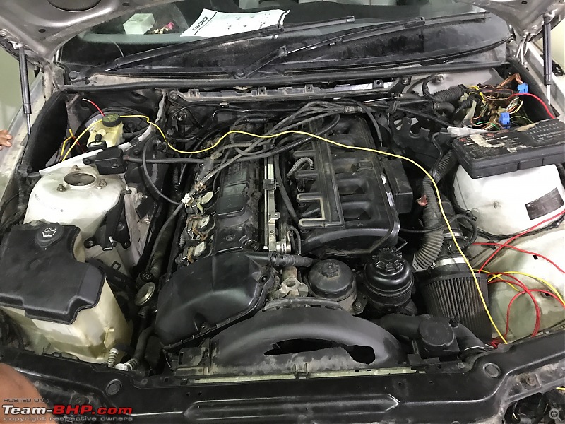

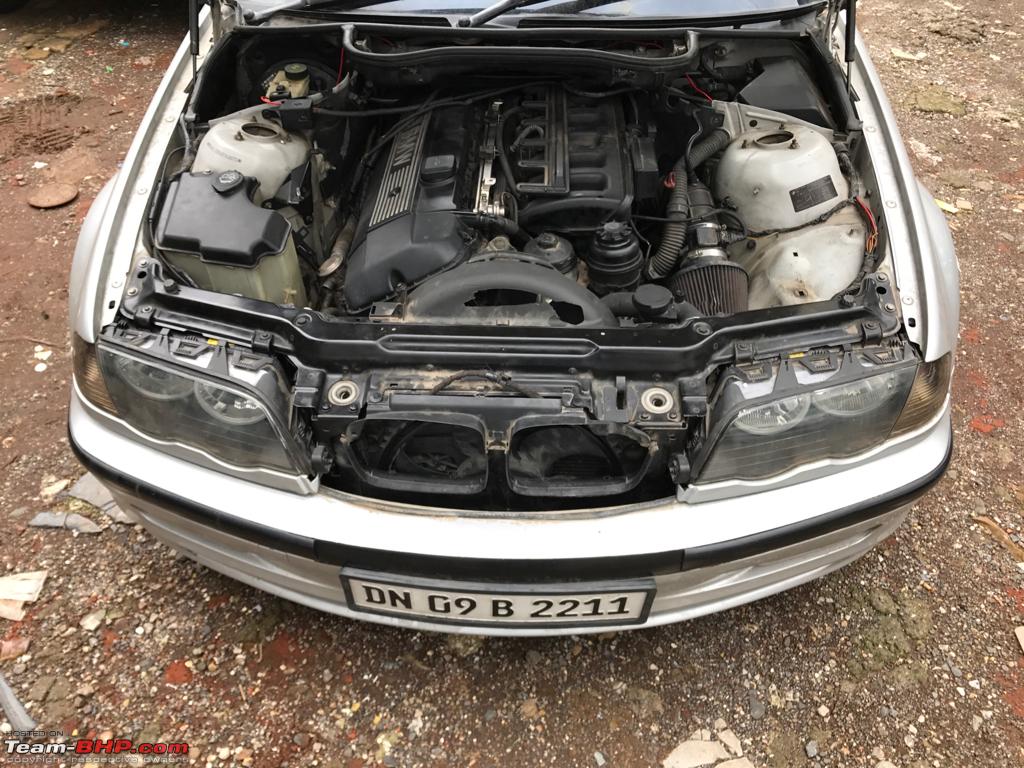

I am extremely happy to announce that the engine is in & the swap is successful :D
My 2001 BMW 328i (E46) build thread | EDIT: New video & upgrades on page 15-imageuploadedbyteambhp1505460889.303010.jpg
The swap was completed within 3 days without much trouble.

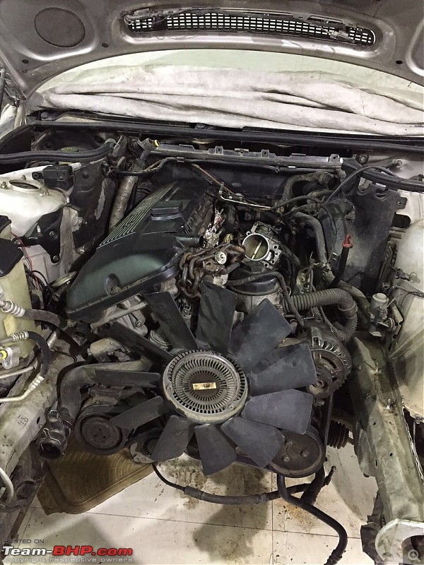

To get the engine out it was obvious we had to dismantle the front end completely and get the AC condenser, Radiator and other things out of the way.
My 2001 BMW 328i (E46) build thread | EDIT: New video & upgrades on page 15-3.jpg
After the front end was out, getting the engine and transmission out was easy as they are bolted on to the chassis majorly with only 4 bolts.

Having the car on jack stands is recommended here to ease access.

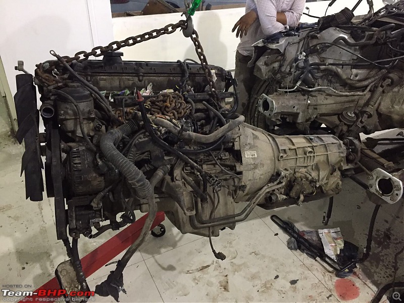

In the meanwhile we had already removed the bigger engine from the donor car and kept it ready waiting outside.
Engine Coming out of the Donor Car;

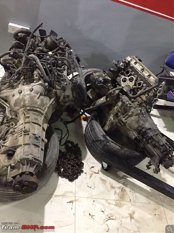

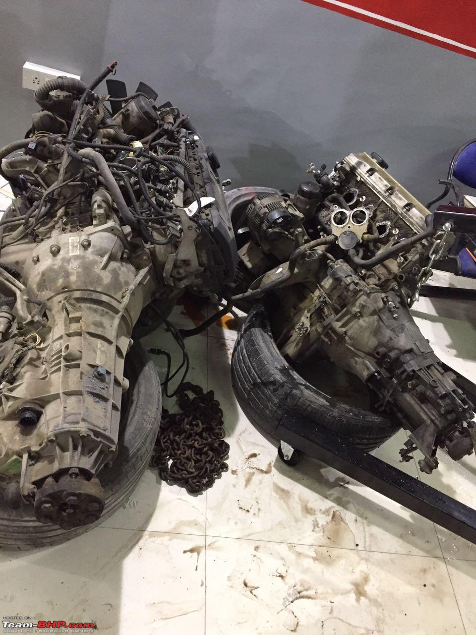

Both the Engines side by side;
My 2001 BMW 328i (E46) build thread | EDIT: New video & upgrades on page 15-img_0708.jpg
On Day 2 the manual transmission of the 318i was bolted on to the new engine and was ready to go into my car.

Once the engine was in the bay we had to use the ECU & the engine wiring harness from the donor car to make all this work in my car.
My 2001 BMW 328i (E46) build thread | EDIT: New video & upgrades on page 15-img_0802.jpg
This took only a few hours & the same day itself we were able to fire up the engine for the 1st time.

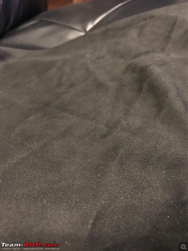

In the meanwhile got the Headliner Fixed from Orchis Powai.
The material selected was a Alcantara style micro suede fabric;
My 2001 BMW 328i (E46) build thread | EDIT: New video & upgrades on page 15-img_1195.jpg
^ The material was sourced by my wife :)

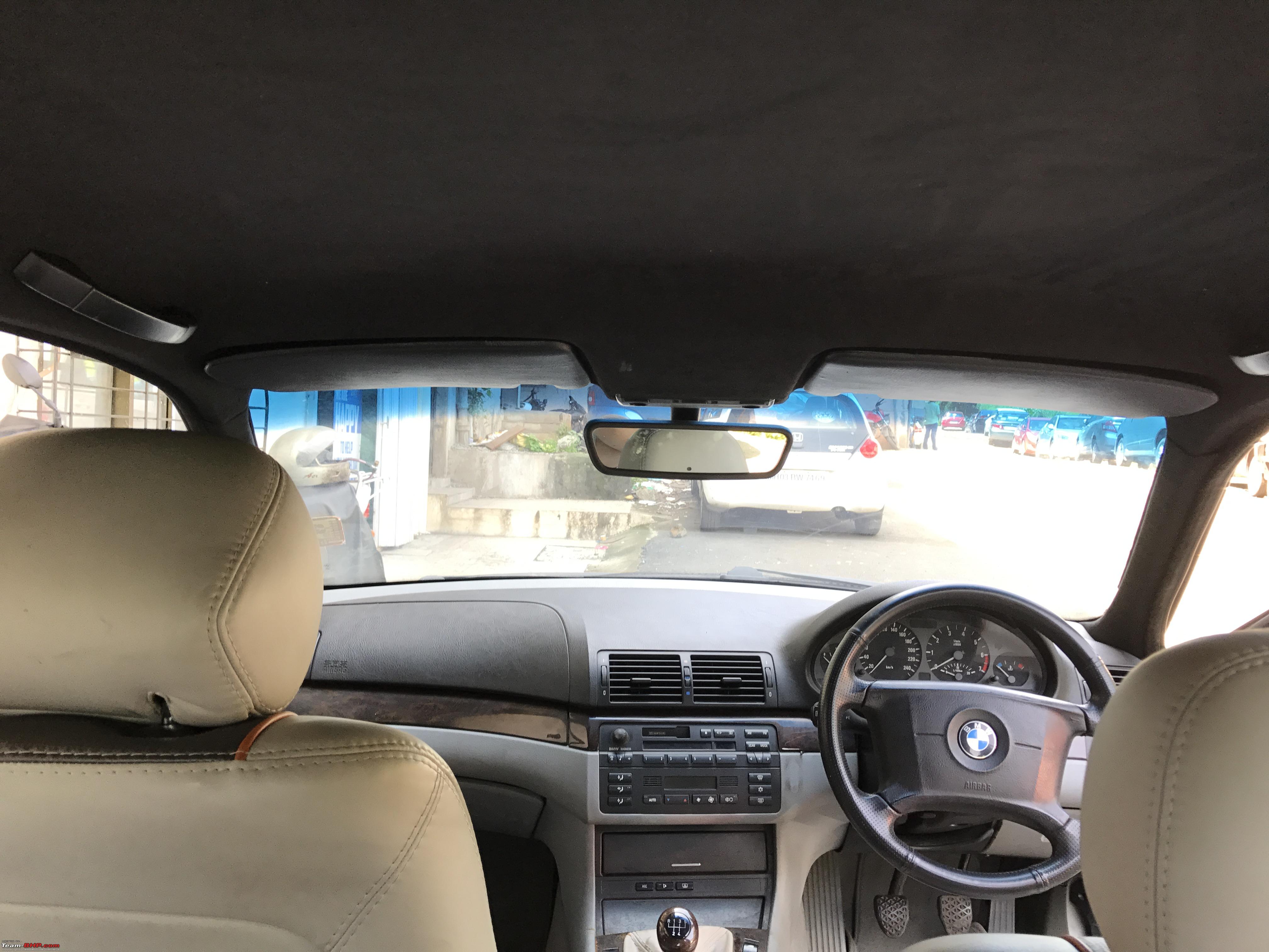

With the headliner got the pillar trims wrapped in the same material as well;
My 2001 BMW 328i (E46) build thread | EDIT: New video & upgrades on page 15-img_1571.jpg
Closer look;
My 2001 BMW 328i (E46) build thread | EDIT: New video & upgrades on page 15-img_1573.jpg
Got the grab handles & the sun visors painted black;
My 2001 BMW 328i (E46) build thread | EDIT: New video & upgrades on page 15-img_1557.jpg
My 2001 BMW 328i (E46) build thread | EDIT: New video & upgrades on page 15-img_1558.jpg
Fitting starts;
My 2001 BMW 328i (E46) build thread | EDIT: New video & upgrades on page 15-img_1581.jpg
Final Results;
My 2001 BMW 328i (E46) build thread | EDIT: New video & upgrades on page 15-img_1582.jpg
My 2001 BMW 328i (E46) build thread | EDIT: New video & upgrades on page 15-img_1585.jpg
The Orchis team was extremely professional with this work, also the owner was very accommodative of whatever suggestions were given to him & also flexible (specially allowing me to give the material as i did not want the conventional headliner fabric - though he had a few options) So a thumbs up to their job :thumbs up
I was charged approx 10,500/- for this entire job.
