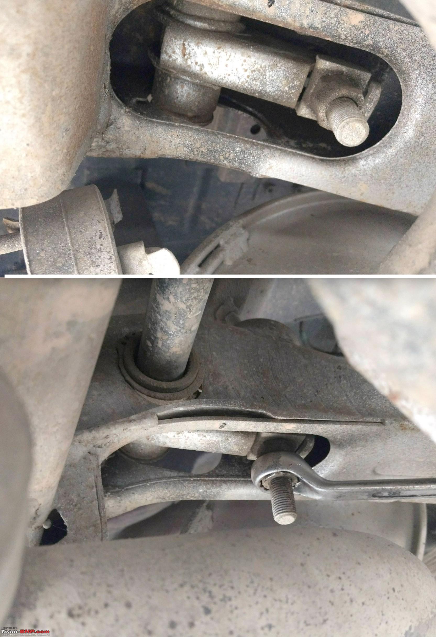

Been a long while since I updated this thread, in which time I've only driven the car about 5,500 km.
With the hard clutch, my wife and her painful left knee have point blank refused to drive it.
I love driving it around, more so because it's a lot more manoeuvrable in the city, and makes for much easier parking in congested areas than the Scorpio. Except, there was this one irritating problem of the suspension crashing very hard over potholes and bumps. So much so that the (Yi Ultra) dashcam crash detection recording got triggered frequently even on its highest setting.
I played around with the tyre pressures, and tried to modify my driving style - but no joy. Checked the dampers, they were working fine. Until I discovered, the suspension was raised to the extent that the upper bumpstop (on the upper wishbone) was in contact with the chassis, preventing the front suspension from extending (opening up) any further.
This meant that the front suspension needed to be lowered, to allow for a sufficient range of play (collapsing as well as extending) while driving over rough surfaces, potholes and bumps. And so it was done, hardly a 15-minute job.
Work involves adjusting the torsion bar via these two bolts, one on either side...
...resulting in the gap between the upper bumpstop and the chassis opening up...
...and the stance of the car changing a bit (from 0.4 degrees tilt to the rear to 0.9 degrees tilt to the front).
Net result: The car rides softer now (but still certainly no match for the Scorpio), though body roll has increased marginally (again, nothing compared to my Scorpio). Handling in a straight line and under braking remains the same, but the car leans a little more on fast curves (though not uncomfortably so).
Work involves adjusting the torsion bar via these two bolts, one on either side....
Hi SS-Traveller, Glad that you have sorted your ride. I adjust the torsion bars on my Thar every 5000kms if I feel that they have gone out of whack. After experimenting all these years I have found out that the ideal gap between the upper control arm of the IFS and the upper bump stop should be the width of your thumb or roughly an inch. Also, I keep the driver side gap a little more than co-driver side as mostly I drive alone. Once adjusted I drive over 100-200kms so that the twisting forces on the torsion bar settles in. If the gap changes I will adjust them and wait for them settle in. Once the bars settle in I get wheel alignment done.
Please make sure that front end of your Thar doesn't sag too much. If it does, there is a chance that your tire will hit your fender flares while turning on the move over uneven terrain especially if you are running on tires that have taller sidewalls.
Changing the ride height via the torsion bars should not change wheel alignment values AFAIK.
Originally Posted by KA09_BIKER_GPER View Post
...there is a chance that your tire will hit your fender flares while turning on the move over uneven terrain especially if you are running on tires that have taller sidewalls.
Nope, nothing of the kind happening. My tyres are stock size.

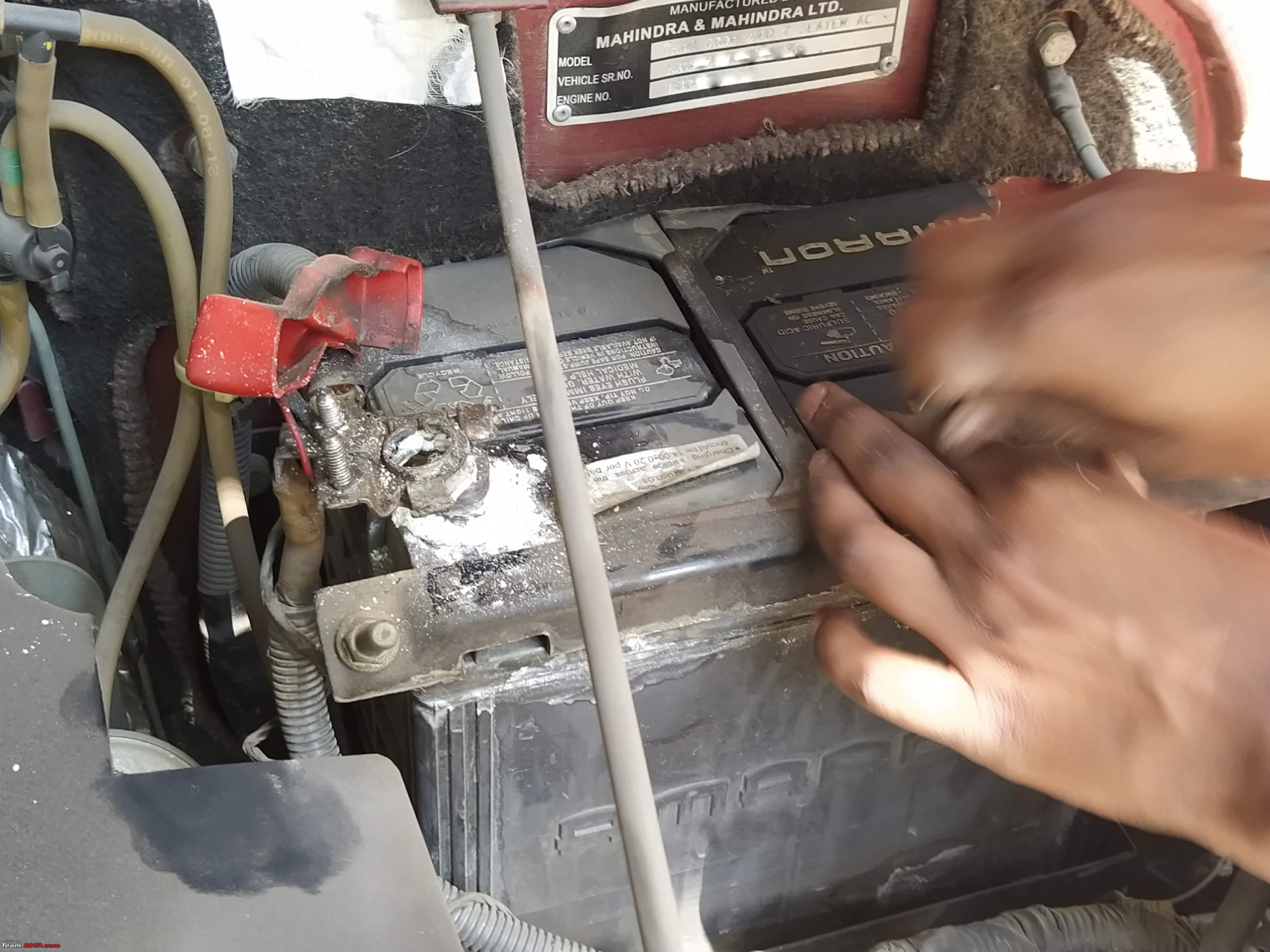

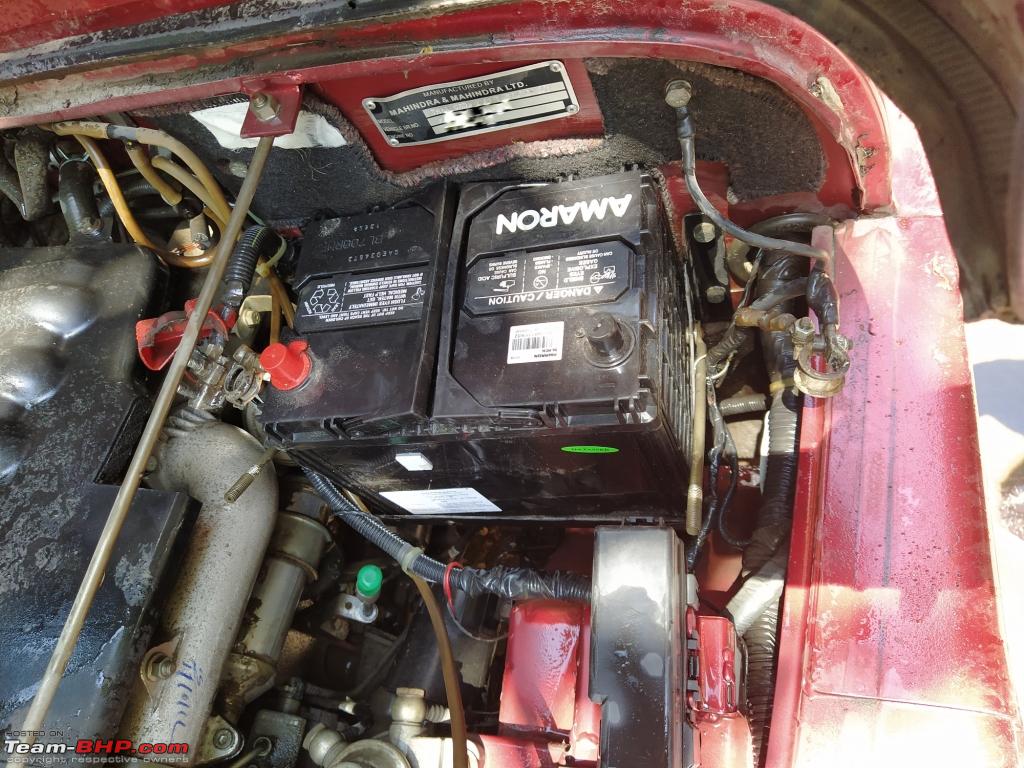

I'm hoping this will pull through the lockdown phase. For a battery to last 7+ years is a new personal record for me, IIRC.
So the battery finally died... and left me stranded in the middle of the road.
I was so happy when, in the end of May, the car fired up on first try, with the voltmeter at 11.0v. We'll pull through the lockout, it seemed.
Nope.
The engine stalled and gave up the ghost when the car was running in 2nd gear, about 6 km away from home! As unbelievable as it might sound, the battery was totally dead - the voltmeter showed 5.2v. This was an entirely new experience for me, even as the time was past 6 pm, and we worried about getting back home before the 7 pm curfew.
Managed to get hold of BHPian JKDS, and he came over at short notice within 15-20 minutes. He had a heavy-duty jump start cable (mine was at home), and we got the engine started from his Bolero's battery.
Had the battery replaced through a local auto store-cum-battery dealer the next morning.
Out goes the old (7 years 7 months old to be exact)
In comes the new (same Amaron Black AAM-BL-0BL700RMF battery)
Price: Rs.4000 including refund for the old battery. This was way cheaper than what Batterywale / Batterybhai quoted, and this battery was home delivered and fitted as well.
