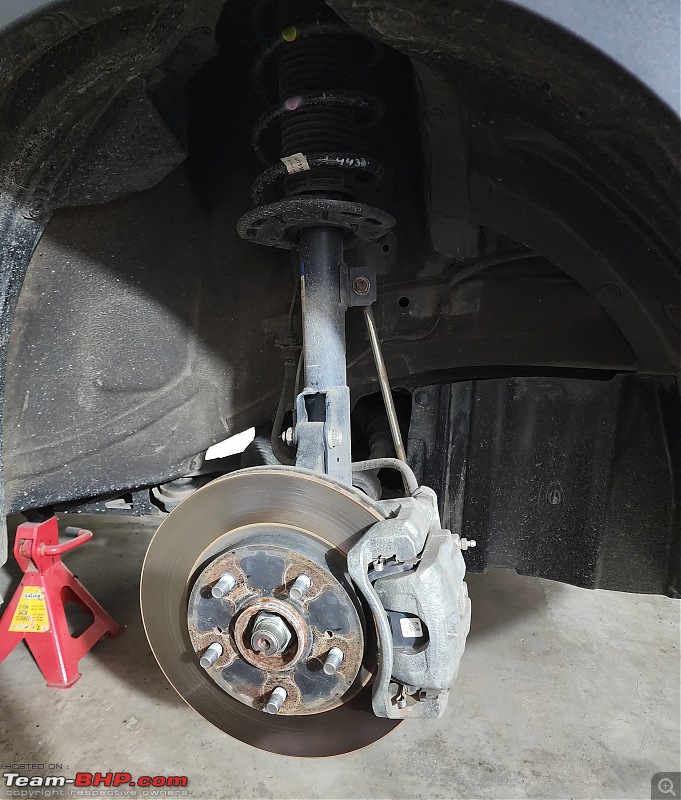

Front Brakes cleaned: There was a minor squeal from the brakes and found a small debris stuck between pad and disc, took this opportunity to clean the brakes as I was not entirely satisfied with the way it was done during last service. Didn't feel the need of lubricating the sliding pins as it felt quite smooth and the Toyota grease seem to be doing it's job well. Largely it was a cleaning exercise. Some pics:
Found the bleeder cap missing on RHS side, was replaced
My first car: 2020 Maruti Suzuki XL6 Alpha MT Review-20221231_114122.jpg

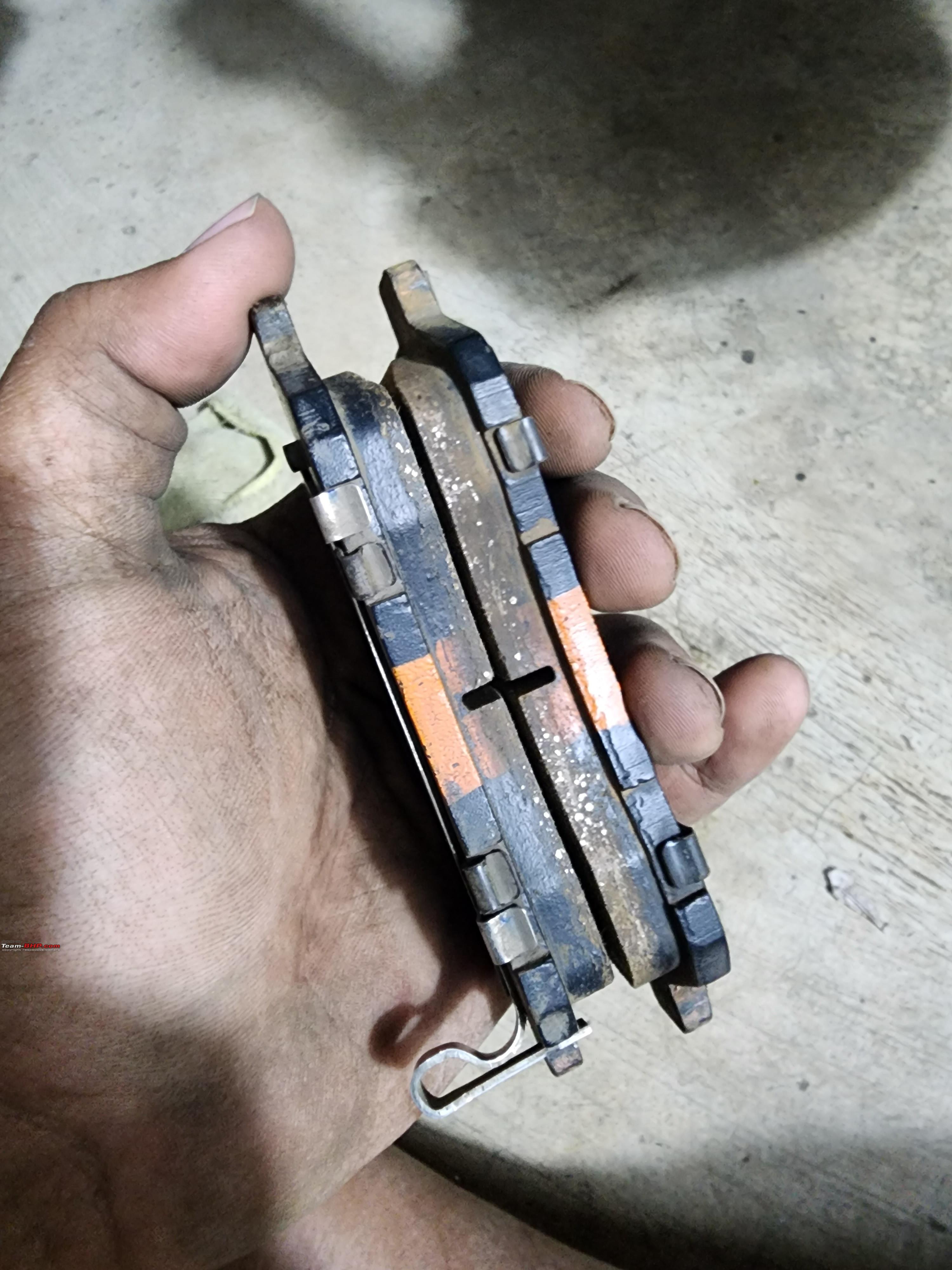

Pads had decent life at 34k Odo:
My first car: 2020 Maruti Suzuki XL6 Alpha MT Review-20221231_114815.jpg

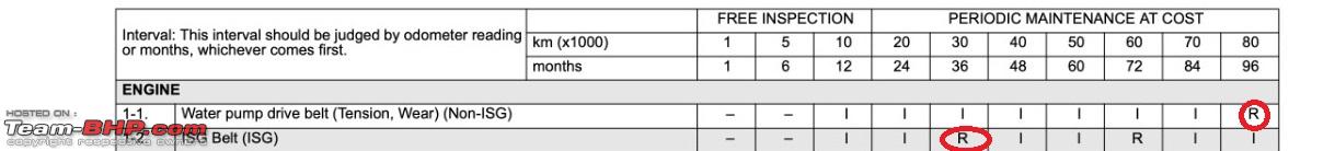

PMS 30 Done: Got the 30k service done, albeit at 31.5k km due to the Jaisalmer trip. Nothing special, just the usual stuff of Engine Oil change, Air and Cabin filters cleaning, brakes cleaning and wheel rotation. Excellent experience at M/s Hilltop Motors, specially due to SA Mr. Nazir.
An update on 30k PMS: BHPian Sumitsinha0280 got his June 2020 Ciaz's 30k service last week, and the system promptly showed ISG belt change for his car. This was a shock to me since in my owner's manual, it's recommended to change at 80k interval, and also during the 30k service, it wasn't changed.
I spoke to WM and he said they have been changing ISG belt at 30k for all the cars, and requested me to get it changed whenever possible.
Decided to dig deeper, and here is what I found: Maruti earlier recommended change at 80k, but they had revised it to 30k later.
XL6 2020 with K15B owner's manual:
My first car: 2020 Maruti Suzuki XL6 Alpha MT Review-screenshot-20230106-131433.jpg
XL6 with K15B's old service manual:
My first car: 2020 Maruti Suzuki XL6 Alpha MT Review-screenshot-20230106-131249.jpg
XL6's with K15B's revised service manual:
My first car: 2020 Maruti Suzuki XL6 Alpha MT Review-screenshot-20230106-131332.jpg
Vitara Brezza with K15B owner's manual states it clearly:
My first car: 2020 Maruti Suzuki XL6 Alpha MT Review-whatsapp-image-20230104-12.49.53.jpeg
S Cross Petrol with K15B:
My first car: 2020 Maruti Suzuki XL6 Alpha MT Review-screenshot-20230106-140727.jpg
It's clear they have revised/edited the interval for ISG equipped K15B models. For older diesels and newer K15C models, it's always been 30K.

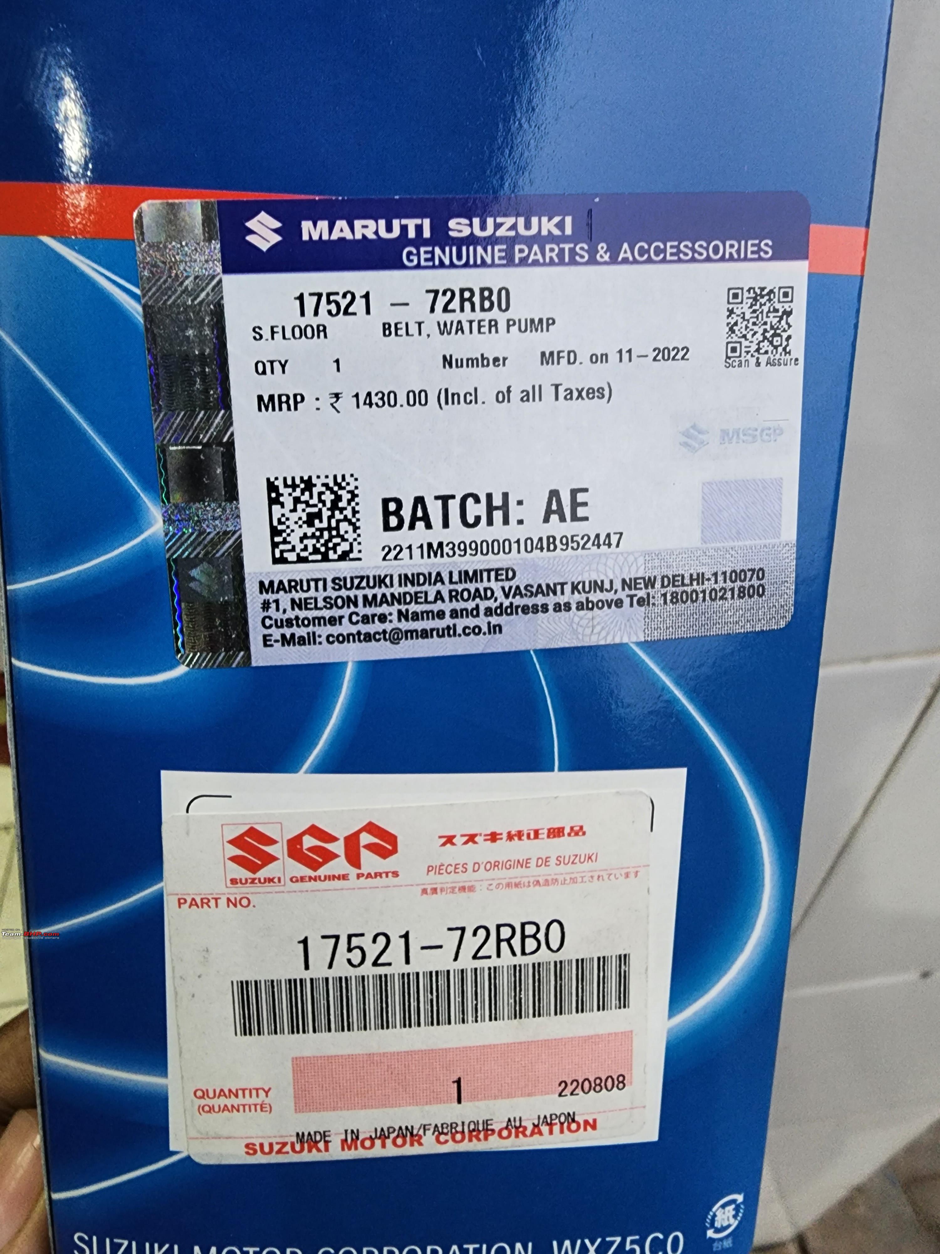

New belt's PN and price:
My first car: 2020 Maruti Suzuki XL6 Alpha MT Review-20230105_171859.jpg

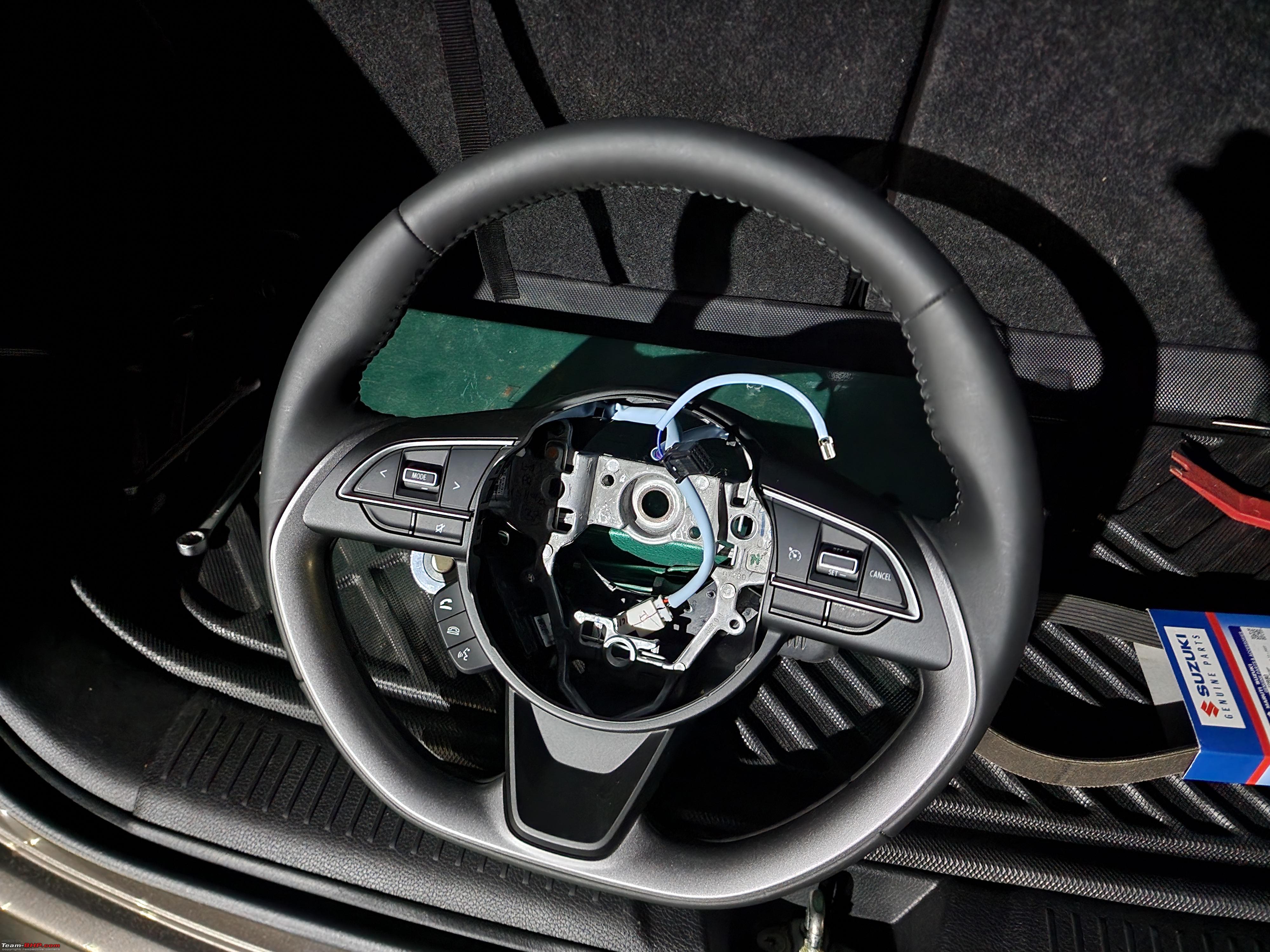

Leather Wrap steering wheel for my brother's XL6 Zeta: The OE steering wheel of XL6 Alpha costs 9.5k, and my brother wasn't ready for such an expense.
My first car: 2020 Maruti Suzuki XL6 Alpha MT Review-screenshot-20230109-221620.jpg
However we soon found out that steering wheel of 2022 Brezza costs a mere 2400 rupees for the leather wrapped version. I don't know how Maruti is managing it, but we decided to order it on Boodmo since we weren't sure if it would fit.
Link to Product: Link
My first car: 2020 Maruti Suzuki XL6 Alpha MT Review-screenshot-20230109-221543.jpg
Thankfully installation was simple standard affair, and my brother is loving the new upgrade. For someone looking for leather wrap on their simple wheels, this is an excellent option. Heck, most high end shops charge more than this amount for a simple wrap!

New Wheel:
My first car: 2020 Maruti Suzuki XL6 Alpha MT Review-20230106_185933.jpg

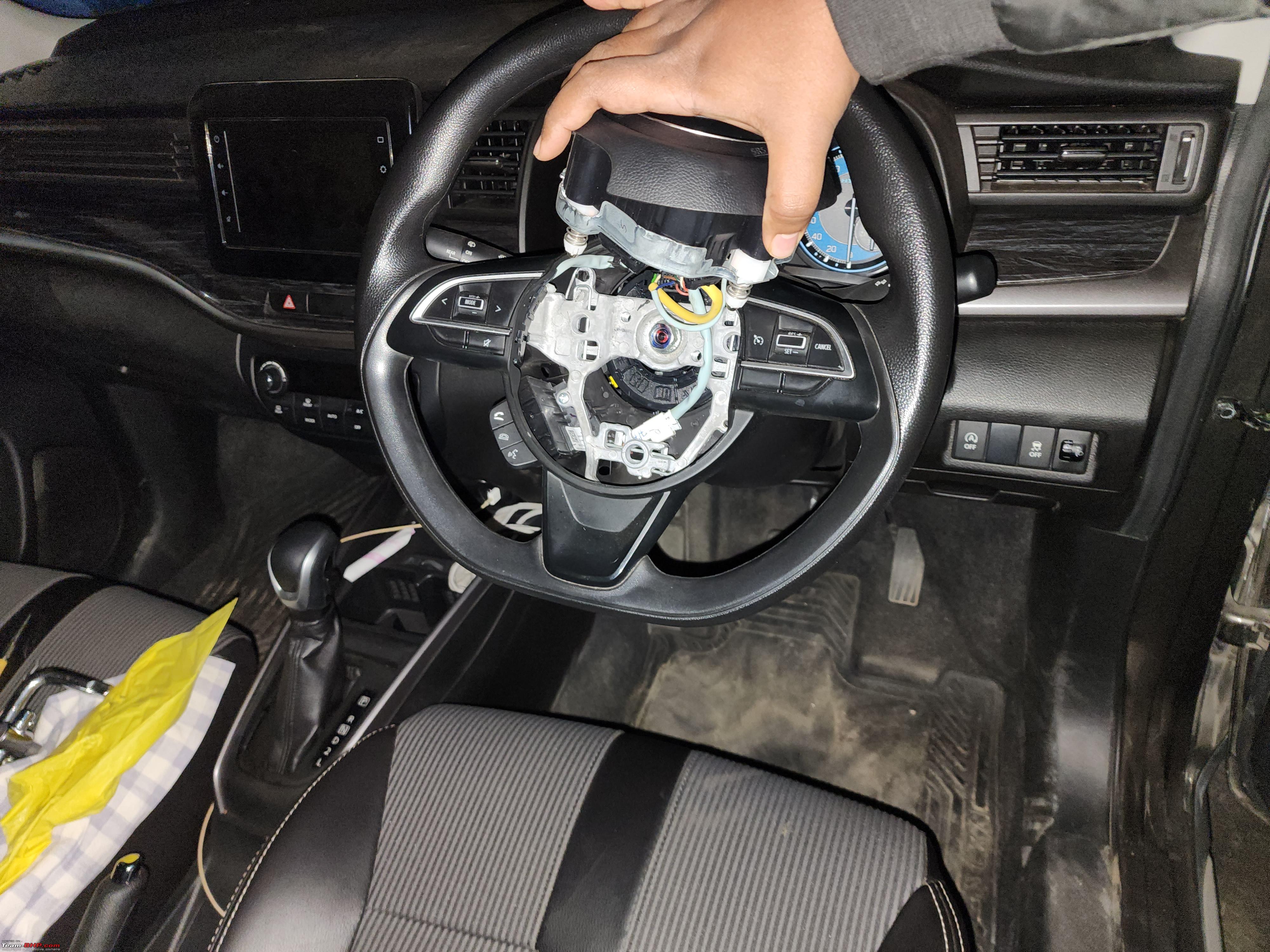

Removing the airbag module:
My first car: 2020 Maruti Suzuki XL6 Alpha MT Review-20230106_190314.jpg

Old vs New:
My first car: 2020 Maruti Suzuki XL6 Alpha MT Review-20230106_191609.jpg
