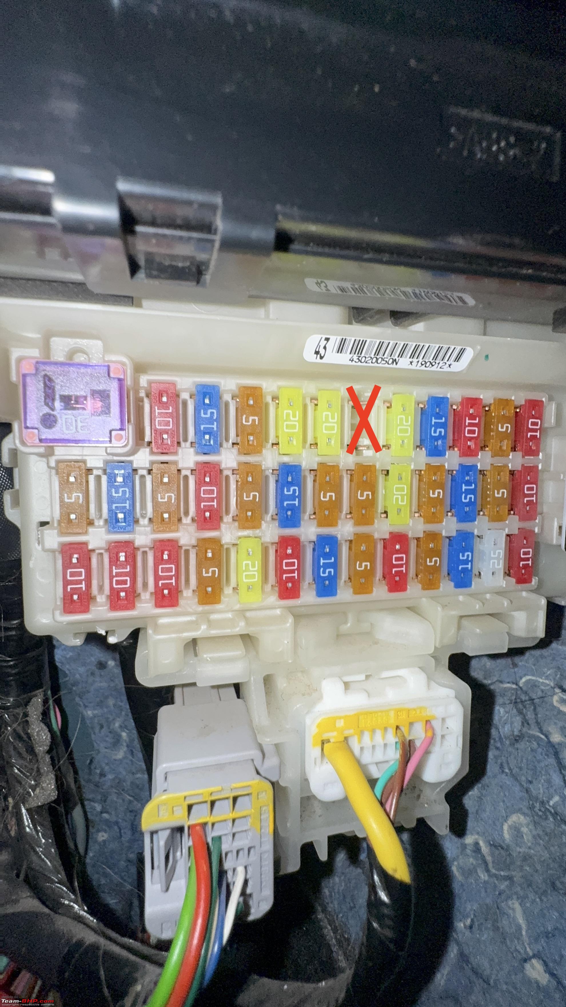

Fusebox of my car
There’s an empty fuse slot which runs live even when the ignition is off, so I chose to tap power from this.

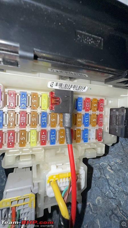

My first car: 2020 Maruti Suzuki XL6 Alpha MT Review-img_5062.jpg
Since I don’t have a 5A fuse with me, I'm using the 10A fuse that comes with this fuse tap kit, will replace this in the future with a lower rating. The total power drawn is usually 10W with halogen bulbs but since I swapped the bulbs with LED ones, it comes out to be around 2W. Ideally should be using a 1A or a 0.5A fuse for this setup but in the future I may add more lighting through this line.
