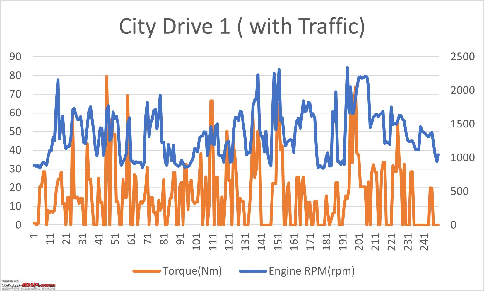

Took some reading, with the help of OBD2 scanner and Torque Pro app, to see how much I generally demand from the engine while doing city drives. Probably amateur for Tbhp standards , however thought of sharing it here. I also plan to do same on a highway drive.
All data collected in AMT auto mode.
Drive 1:Office hour drive with decent amount of traffic
Mahindra XUV300 AMT Automatic W8 : Ownership Review-speedvsrpm_trip1.png
With avg speed around 20 Km/h
Mahindra XUV300 AMT Automatic W8 : Ownership Review-torquevsrpm_trip1.png
Averaging around 25 Nm

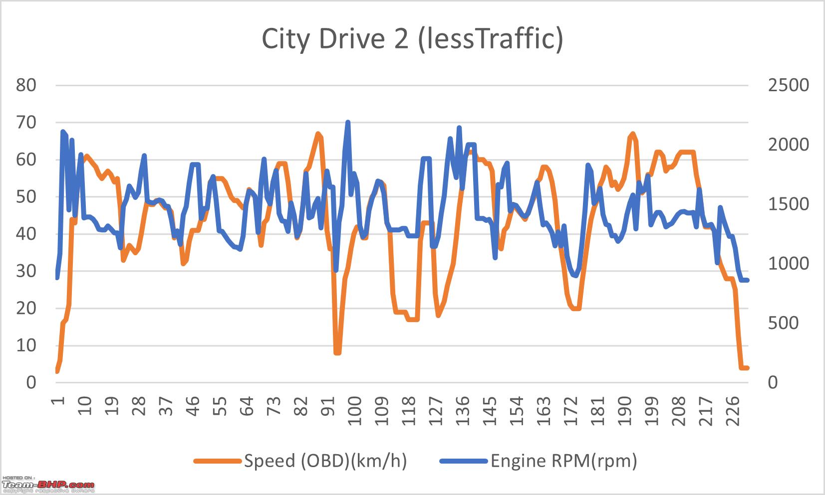

Drive 2: Similar city road, less traffic
Mahindra XUV300 AMT Automatic W8 : Ownership Review-speedvsrpm_trip2.png
With avg around 50kmph

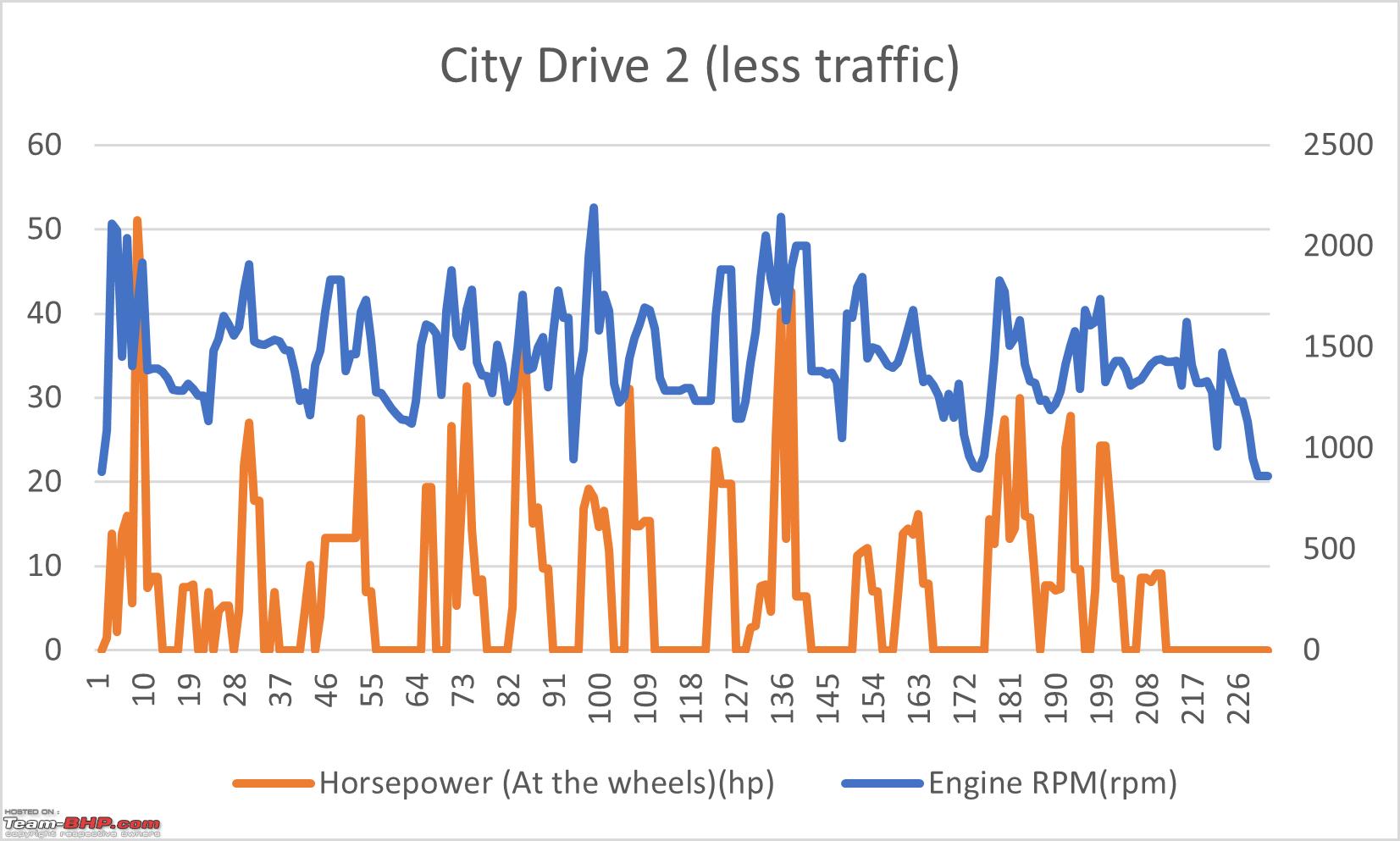

Mahindra XUV300 AMT Automatic W8 : Ownership Review-hpvsrpm_trip2.png
Average Horsepower around 17-18 hp
