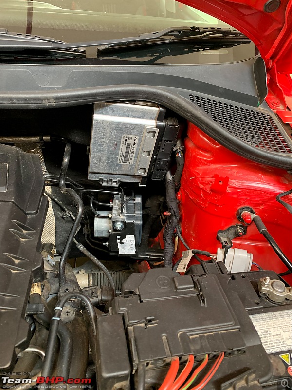

I started some discussions with Nikhil of N2 Autotech to get the stock ABS pump replaced with the Euro spec pump with ESP which would help enabling traction control, hill hold and TPMS. I knew another BHPian friend VivekCherian already placed a similar order with Nikhil for his Polo 1.0 TSI MT (along with tons of other mods) and I hit him up with so many questions. Big thanks to him for all the help offered. Eventually, I too placed the order towards end of July 2021 and then the wait started. By first week of October, Nikhil managed to source all parts required for the retrofit. Vivek’s car had quite a lot of mods to undergo and Nikhil wanted to work on our cars back to back. In the end, we agreed upon later half of December for the mods.
Finally, Nikhil is in the city and Vivek’s Polo was being worked upon. I handed over my Rapid to him as he dropped the Polo at my place where he managed to complete some minor work which was pending. Nikhil kept on updating me on the progress by sending pictures and videos even without I asked for, much appreciated.
Here are a few pictures as he progressed with the retrofit.
Parts required for the retrofit
Review: Skoda Rapid Monte Carlo 1.0L TSI – A Little Beast!-parts.jpg
That's the Euro ABS pump now fitted
Review: Skoda Rapid Monte Carlo 1.0L TSI – A Little Beast!-abs-pump-fitted.jpg
Steering to get the slip ring with angle sensor
Review: Skoda Rapid Monte Carlo 1.0L TSI – A Little Beast!-slip-ring.jpg
The switch to turn ON/OFF Traction Control is installed
Review: Skoda Rapid Monte Carlo 1.0L TSI – A Little Beast!-traction-control-onoff-switch.jpg
Apparently, the car was delivered next day morning and we tested ESP in real time by stomping the A pedal, indeed it kicked in and warning flashed on the cluster. An OEM switch was added on to one of the empty slots on the dash so that traction control can be turned off if there’s a need and we verified it’s working too.

Wonderful safety mod.. does this require any SW override to the existing system as that would void the warranty of the entire car.
Also, from what I see, you have replaced/swapped the ABS motor with the ESP and this will have different mounting which you added in addition.
And how does it gets integrates with ECU/ECM, do we need to do a different wiring for this?

The warranty on suspension (and probably the associated components) is void for sure. On the pricing, I paid £500 for B6 including shipping. But for the ESP retrofit, the prices could vary based on the availability of parts and one’s requirements. I’d say, best to check with your VAG specialists.
On the wiring, as I wanted to have a switch added to enable/disable ESP, this required additional wiring. Also, the coding was required to get the system running.
