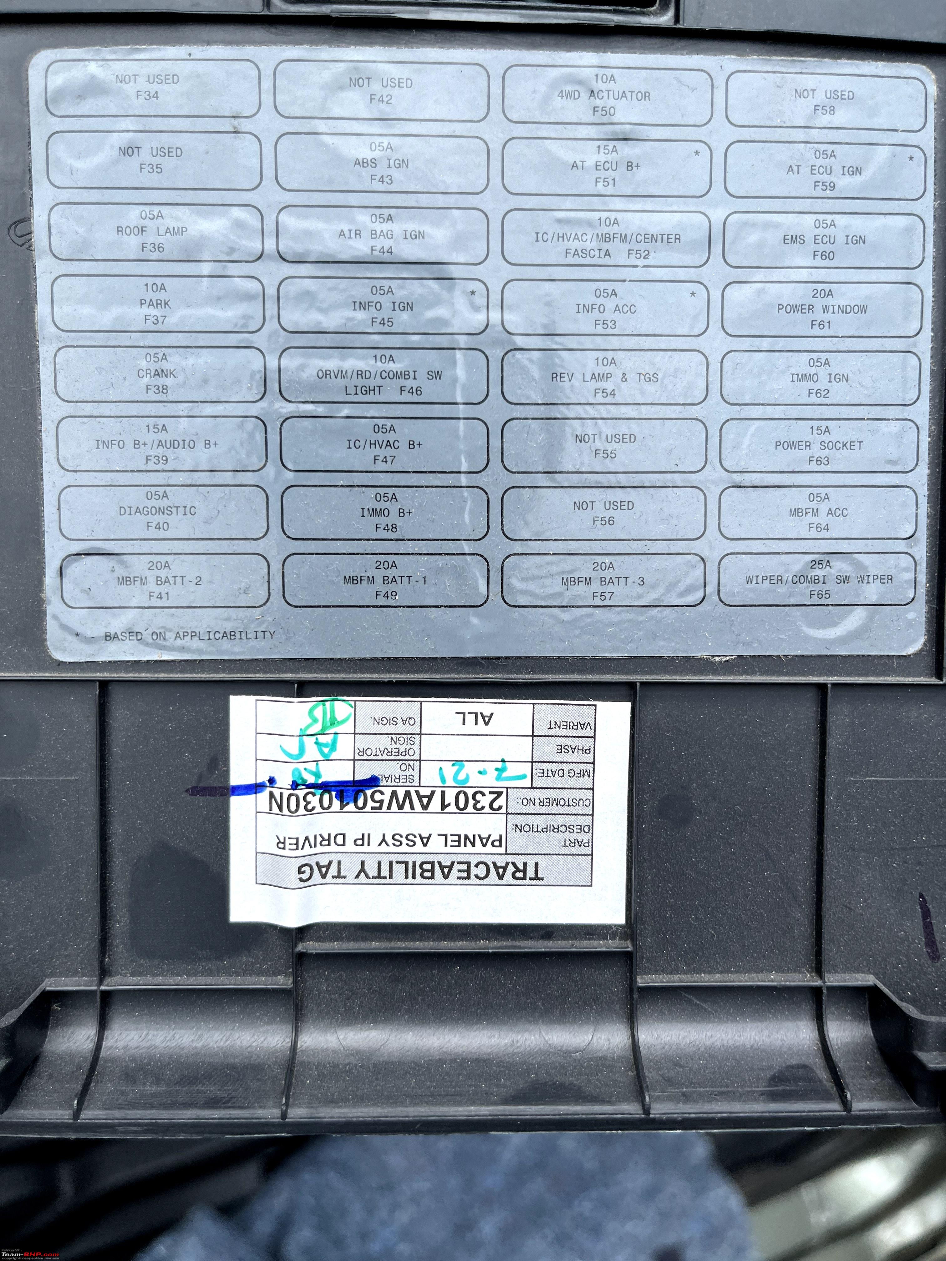

The hardwire kit comes with fuse taps like these -
Its needs two taps - a regular fuse (I tapped the cabin lamp fuse (F36) for this), and ACC power fuse (I tapped the MBFM ACC (F64) for this).
I am hardwiring my dashcam (wolfbox 840h) with the hardwire kit they sell. For the cam to work in the park mode (does 1 fps recording when parked), it needs to be hard wired such that:I think am going to use F64 for the ACC power but am not sure which one to tap for the constant battery power. Any guidance is much appreciated.
Originally Posted by fjcruiser08 (Post 5783214)
...but am not sure which one to tap for the constant battery power. Any guidance is much appreciated.
For the continuous battery supply, I have used the cabin light's fuse (F36) - works perfectly!
I was wondering if that would be the safe bet but thanks for confirming, so F36 it is! BTW, do you happen to know what MBFM ACC F64 is actually for?

...do you happen to know what MBFM ACC F64 is actually for?
I just recently installed the Wolfbox 840H and its been good so far.
The best part is the WiFi connectivity! And it works even better if you have a spare phone or ipad.
The BFM in MBFM is body function module, M + I'm guessing - is Mahindra.
The other fuse option to tap for power supply when the key is on (running or ACC) will be the power window fuse...
I've gotten an 840H too, will be switching to it shortly - good to hear it's a worthy buy!
I guess the Power Window F61 fuse is a safer bet because there doesn't seem anything else drawing power from it. Who knows what all that MBFM is powering?!
Do post your reaction on the 840h once you have had some time to play with it. Last few days I have been doing some driving in direct rain and in that case the inside mounted rear cam is not gonna be much help. So if you expect to drive in the rain a lot, you must install it outside.
Be mindful of the fuse rating though.. I'm not in town to check this in my Thar, but I picked the MBFM ACC coz it was 5amp rated, while power window fuse was 10amp or 20amp rated - and the fuse in the hardwire kit was a 5amp for the dashcam, not sure if piggybacking it on a higher rated fuse will have any adverse impact.
Also, proof in the pudding - I've been using these two fuses for 4 years or so now, no issues!
Thats a good point! The Fuse in the HW kit for WB 840H is 15A. But the way I thought about it is that the load can draw as much power it needs (upto 15A in this case) but no more than that. In effect, I thought that the 20A socket for Power Windows F61 is designed to deliver upto 20A for the Power Window circuitry, but no more than that. Thus, if I add the WB which is a 15A max load, it can draw upto 15A but no more (restricted by the fuse in the fuse tap).
But then, the constant power BATT terminal cannot be fuse tapped into the Roof Light which is only 5A, so the WB wont be able to draw any more than 5A from F36?
I think I dont know what am talking about now LOL ... here's a picture of the fuse box layout.
I need an auto electrical expert to weigh in on this before I burn shit down :)
