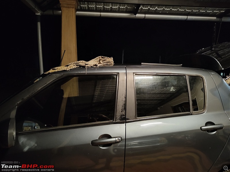

Wrapping the B Pillars
I had a roll of carbon fiber vinyl and time in hand during a weekend, Thought of wrapping the B-Pillar since the OEM wrap on the pillars was wearing out, removed them and applied the CF vinyl using my trusty heat gun. Fairly easy. Only time will tell how long they will last. It’s been about 4 months since I applied and they have held up pretty well. Maybe on another lazy weekend I will wrap the A pillars as well.

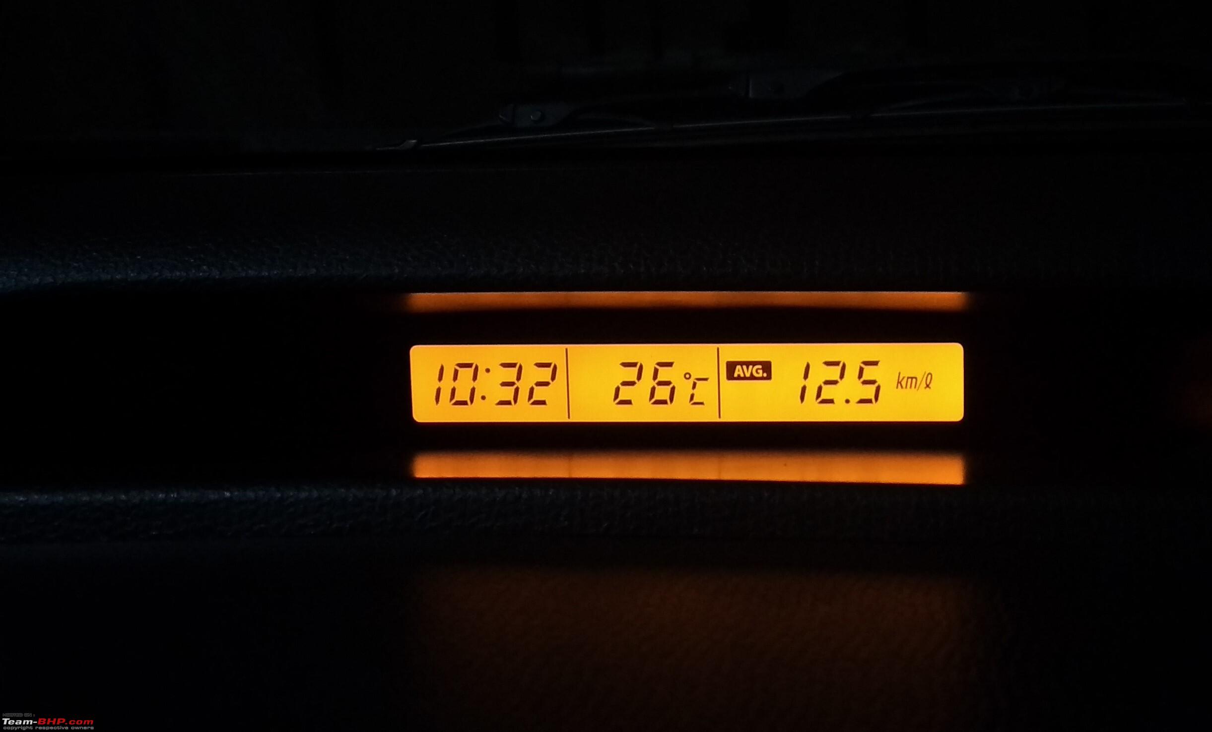

1. Installing JDM(Japanese Domestic Market) Swift Clock Monitor
The International Swift came with a Monitor that displays Time, Ambient Temperature and also the Fuel Efficiency ( Instantaneous and also Average Fuel Efficiency).
I went through another Forum where a member had installed this in his Swift which was PKDM(Pakistan Domestic Market) running a M13A Engine and it had a basic clock which displayed only Time. Lucky for him he did not have to swap the BCM for it to read and display Ambient temperature on the JDM Monitor. He only had to install the Ambient temperature sensor and put the pins into the BCM and install the JDM Monitor.
Link to the thread mentioned
Any way I can get this JDM clock bro? �� I own a 2010 Swift ZXi with the K12 engine.. have been searching for this clock with temp and mileage and had no luck.. Any way you can be of help?
The clock is not available in India. I had to import it and later sold it to my friend. Will let you know if there are possibilities but the chances seem slim :sadface

Thanks! I actually found a website in pakistan but it only ships out to Pakistan and USA so no luck there.. https://www.autokings.pk/products/su...erature-sensor
What about the clock from Dzire that you use now? Can you share the part number? Is it plug and play for the ZXi model Swift?
Akhil
Regards
Ashton Castelino
I actually found one in Ireland but the part number is 62J51 and another one was 62J50.. Will that be an issue? The parts on European Swifts look identical but don’t know if they are cross compatible. Attaching the pic for reference
Thanks,
Akhil
It's available on Boodmo currently. Part number: 34600-74K00
They are cross compatible. The ones ending with J50 series have the option of AVG Fuel Efficiency in addition to the instantaneous Fuel efficiency. The one which I procured earlier did not have the AVG Fuel Efficiency option but just the Instantaneous Fuel Efficiency. So getting the Clock ending with J50 series is a better option. Yes, it's plug and play for your ZXi since it's a K12M engine.
Also that clock photo which you have posted looks a bit odd, how come the display is black. Do note there are two types of clock, one with orange backlight and another one with red backlight similar to what Previous generation GV's got. Looks like the photo of the clock what you have posted has the Red backlight.
Regards
Ashton Castelino
Regards
Ashton Castelino
Aah yes good catch.. Will enquire on that. Love your writeups and DIYs bro! Beginners like myself gain the confidence to experiment from BHPians like you! Keep them coming
Thanks a ton!
Akhil

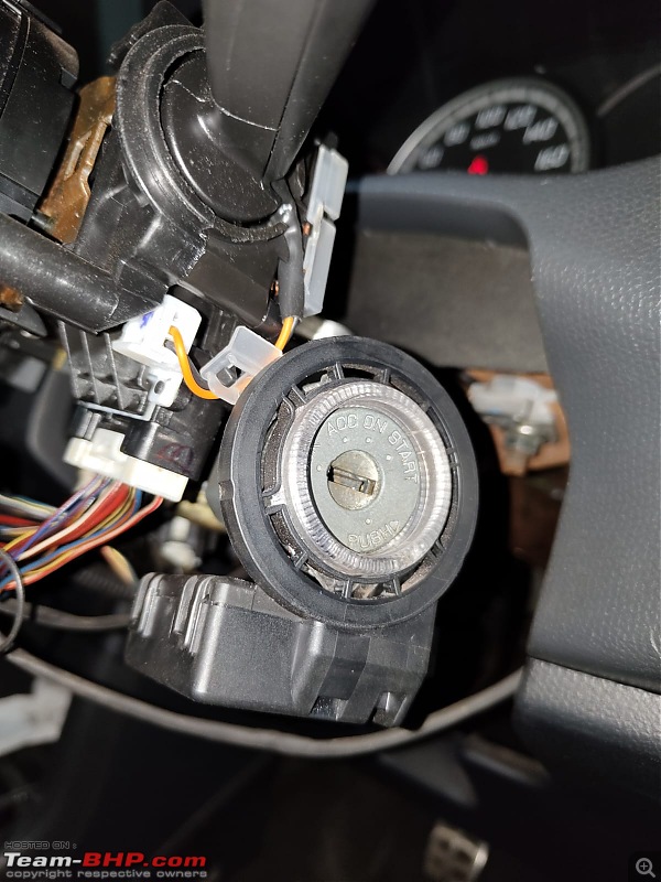

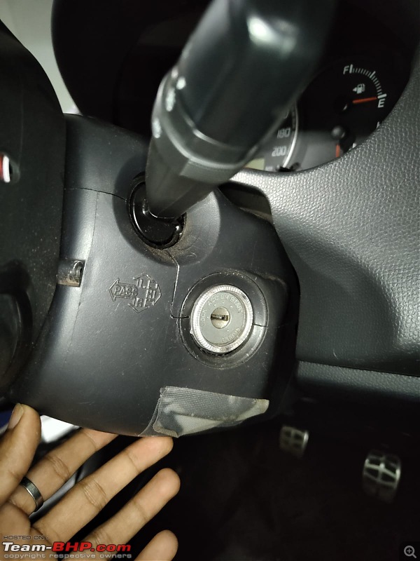

Adding Keyless Entry System
The type 1 Swift 2005-2007 models did not get immobiliser and only the ZXi got the Keyless entry system from factory. I began to learn about how the remote central locking system works. So as per the Service manual, the central locking module just acts as an intermediate device between the door actuators, door switches and the BCM.
The BCM controls
• Power door lock
• Combination meter
• Interior light
• Warning buzzer
• Rear end door window defogger
• Tailgate opener
Since the Locking Unlocking of the doors is done by the BCM, it just needs the central locking module connected in between the wiring.

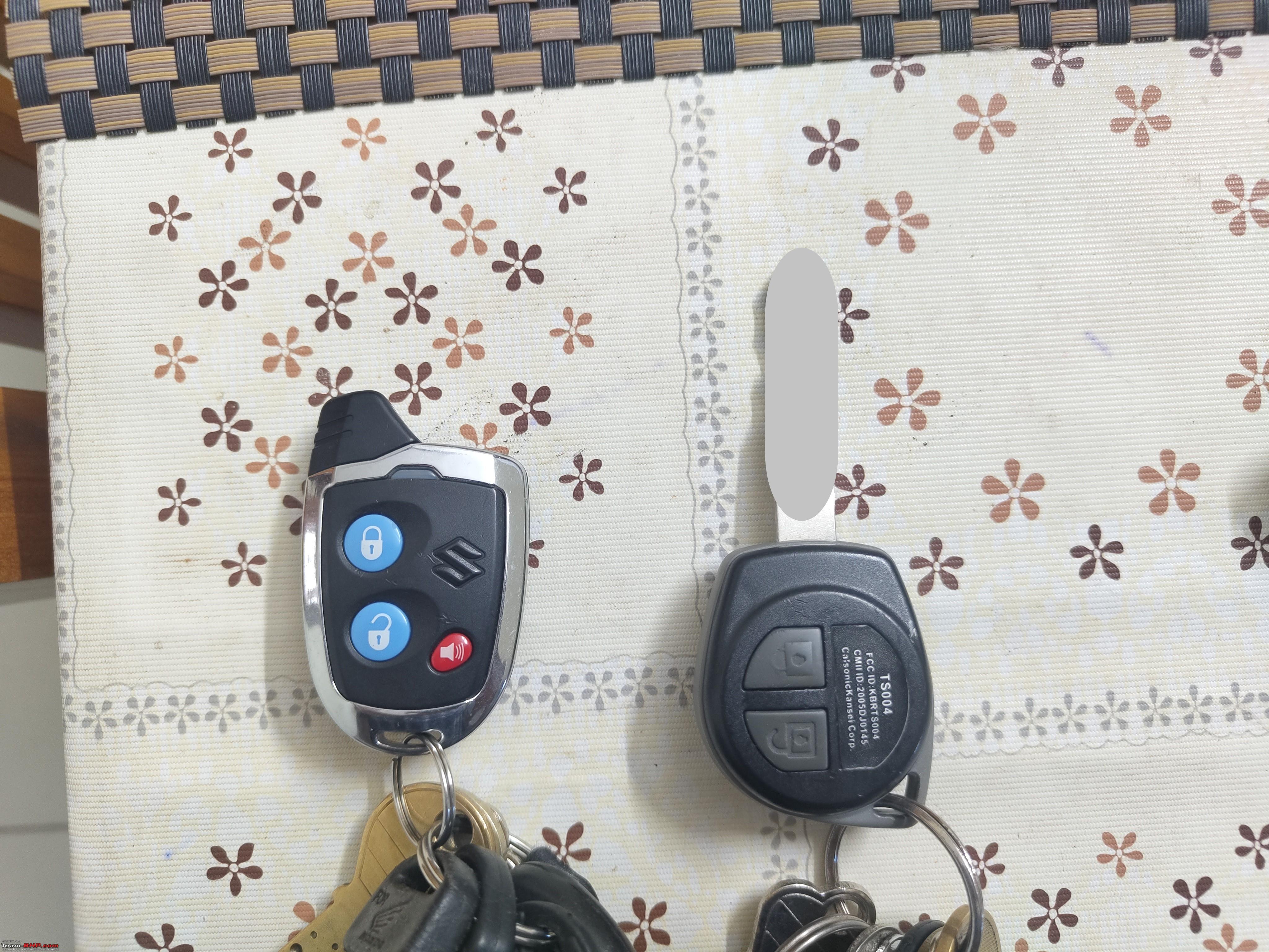

Whilst I was always on the lookout for adding this into my Swift, the entire kit for the Type 1 Swift was out of production and no where in stock.
Part number: 990J0M75JF0-020
Price- 5546
Bummed out, I decided that I would go for the OEM Central locking system ONLY whatever the cost. I also observed that the facelifted Swift / Swift Dzire gets an updated dashboard wiring harness that contains the 24 pin connector and immobiliser wiring as well. This same 24 pin connector is present in all the Swift’s / Dzire, Ritz (2009-2011), and SX4, A-star. So getting the security controller box and the wiring was the only thing left.
Parts required to complete.
•37187M75J00 TRANSMITTER ASSY,SECURITY
•37220M75J00 SWITCH ASSY, SECURITY
•37225M75J00 HOOD PIN SWITCH ASSY
•38521M75J00 CONTROLLER ASSY,SECURITY
•38522M75J00 SIREN ASSY, SECURITY
•36602M74K10 HARNESS ASSY INSTRUMENT PANEL
So total expense looked to cross the 10,000rs mark
I managed to source the security controller box, Remote key and also the dashboard wiring harness from the scrapyard for super cheap. The rest of the stuff was procured from Boodmo.
Azure Grey 2006 Maruti-Suzuki Swift VXi | Ownership Review-img_20230729_155642144.jpg
Azure Grey 2006 Maruti-Suzuki Swift VXi | Ownership Review-img_20231204_210300269.jpg
Clarity Car Audio based in Goa was kind enough to send the Suzuki ISO connector for the head-unit.
I also had to transfer the rear wiper wiring, steering audio controls wiring from my old wiring harness into the new one. Modified the wiring harness at home and kept it ready for the Swap. I had to make sure that the security controller box and remote was working before attempting to install it on my car. A good friend lent me his Swift 2009 VXi to try this and I managed to pair the remote and the controller easily. Speed locking was also working perfectly at 25kmph.

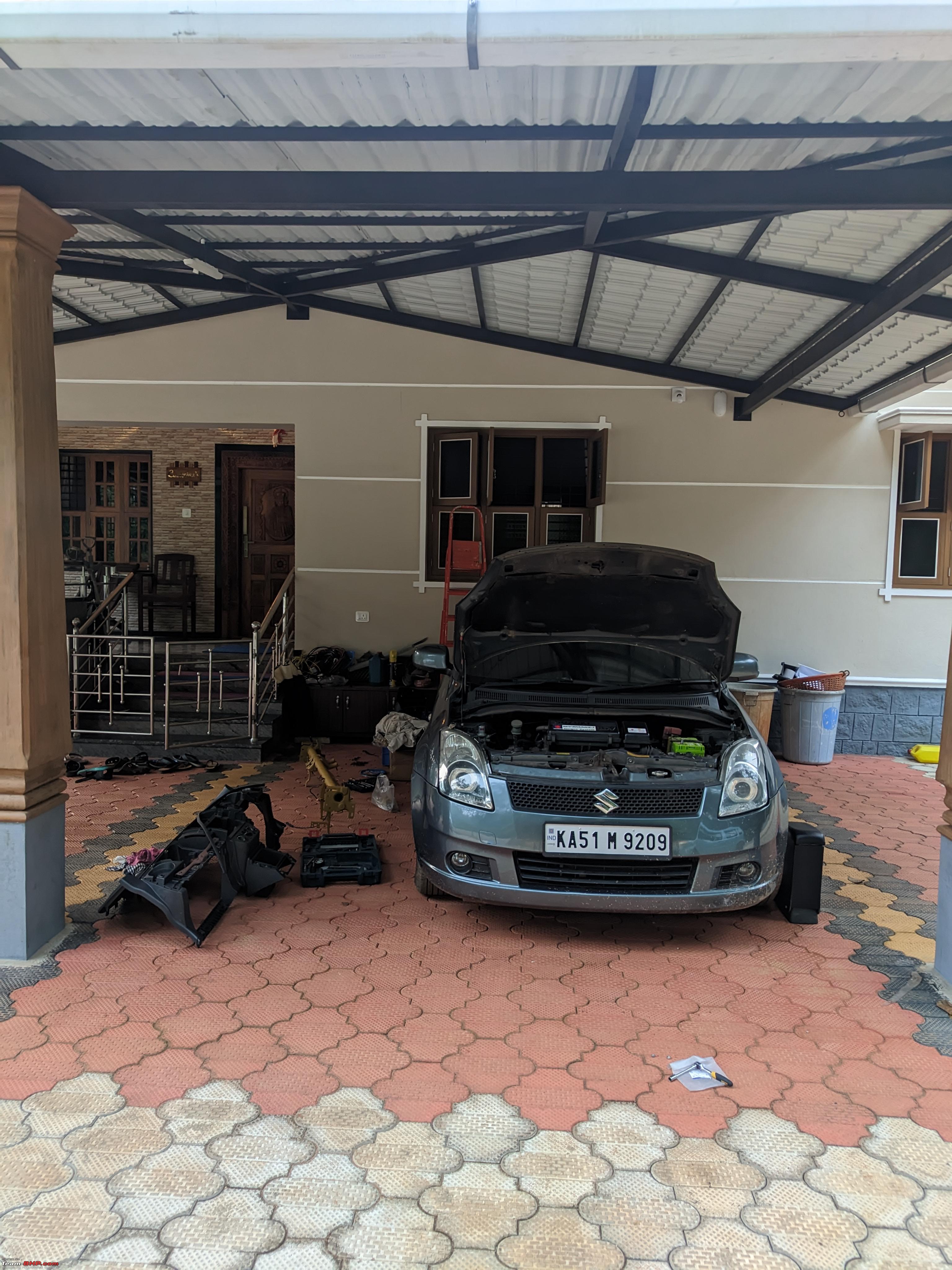

I undertook this swap over 3 days since I was doing this alone in my village, dashboard was out again and made sure all was perfect. My engine bay wiring harness already had the connectors for the bonnet switch and the siren.

Wiring harness part number
The dashboard wiring was clamped back onto the crossbar and fitted onto the car but to my horror the lock unlock feature via remote was not working and the car wasn’t starting. At this point I got chills up my spine and also was wondering where did I go wrong or what did I miss. As I turn the key to start the car, the starter relay clicks but the car doesn’t crank. Back to referring the service manual, I realised that in the facelift models the ground to the starter motor was wired differently. I compared it with my previous stock wiring harness and noticed one pin was missing in the new wiring harness.
Azure Grey 2006 Maruti-Suzuki Swift VXi | Ownership Review-img_20231213_221700340.jpg
I slid a suitable pin in it and grounded it to the chassis and turned the key over. The car cranked and was back to life. Sign of relief !! next was to assess why the lock unlock feature was not working via remote. I realised the type 1 floor wiring has the door wires on the right rather than on the left where the dashboard wiring attaches. Unfortunately I had to resort to using scotch locks here and used tessa tape over that point to absorb the vibrations and reduce rattles. Post this the lock unlock started working flawlessly.

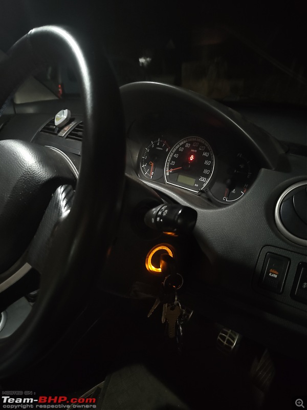

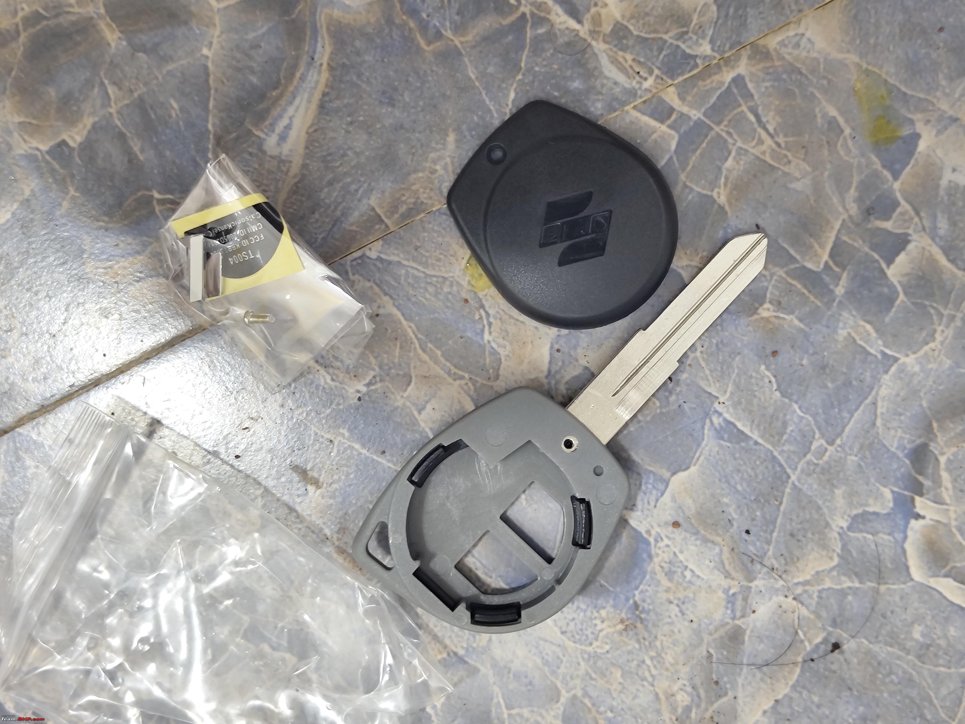

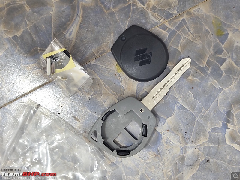

I also sourced the SX4 immobilizer, which contains the illuminated key light. Now since my car doesn’t have an immobilizer it could easily install it since the provision on the steering column was already present and the new dashboard wiring already had the immobilizer connector, inserted pins into the connector to give it a signal via the cabin lamp.
Azure Grey 2006 Maruti-Suzuki Swift VXi | Ownership Review-whatsapp-image-20240221-4.42.18-pm.jpeg
Azure Grey 2006 Maruti-Suzuki Swift VXi | Ownership Review-whatsapp-image-20240221-4.42.17-pm.jpeg
Azure Grey 2006 Maruti-Suzuki Swift VXi | Ownership Review-img_20231214_191600791.jpg
