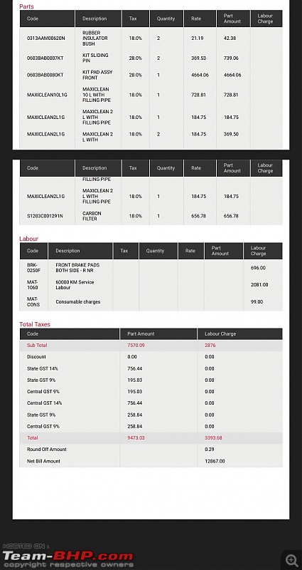

Long overdue, but here are my 60K and 70K updates.
60K
Checked in for a routine service at CAI Mahindra. Did not have any complaints. The SA called me back after a while to inform me about a leak in the radiator core.
I hadn't noticed any warning lamps, and the fluid levels were always within the operating levels (I make it a point to check every morning). So whatever leak was there should've been minimal.
They investigated the external impact angle. I denied anything of that sort and was okay to bear the cost of replacement if they could show me proof of impact. Later, the SA told me that they'll cover the replacement under warranty.
The total bill came out to 12,867/-
