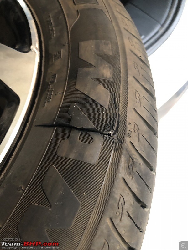

Accident
Let me begin by clarifying that there was no personal injury but that there was damage to the car. No more than 3 days after I got my Wheels Wisdom subscription, I met with a minor accident. At a large roundabout with traffic signals at all exits, my signal was green. I proceeded into the roundabout entering almost in a straight line, preparing to take an exit that would put me in a 2 o’clock direction from the point of entry into the roundabout. The exit was some distance away, so I was roughly where the middle lane would be (lanes weren’t marked, if my memory serves me right). At this point, a young man on a motorbike had entered the roundabout apparently from (on the same figurative clock) a 3 or 4 o’clock position, intending to exit onto the same road I was heading towards. The roundabout is so large that it has a playground with walls in the middle with even a cricket academy in it. I was driving at about 25 kmph. From beyond my line of sight on the right, he approached at speed (I suspect ~40 kmph) and hit the front right fender of my car. He ought to have been on the right lane from which he began his turn, but somehow cut across a lane and a half to my position – on the (imaginary) middle lane – resulting in the collision. It appears that he was intending to cut across to the left lane in preparation for his exit. It seemed to be rather irresponsible and somewhat aggressive driving. I can’t think of anything more I could have done to prevent this. My instinctive checks of looking around just at or before the stop line at the signal didn’t show his entry. Obviously not, because he would have passed in front of me, had he been visible then.
The collision had resulted in the sidewall of the tyre tearing, all the air escaping from the wheel. There was even a small scratch on the alloy. The panel above the wheel arch had a few dents and scratches.
Mahindra XUV300 TurboSport | Ownership Review-1.jpg Mahindra XUV300 TurboSport | Ownership Review-2.jpg
Mahindra XUV300 TurboSport | Ownership Review-3.jpg Mahindra XUV300 TurboSport | Ownership Review-4.jpg
Mahindra XUV300 TurboSport | Ownership Review-5.jpg Mahindra XUV300 TurboSport | Ownership Review-6.jpg
In any case, my parents and I were in the car. We are not interested in confrontations or arguments, and, in circumstances like this, are happier to ensure that peace ensues rather than fight over who was right or fight over who pays for what. In about two minutes of talking, the rider of the bike began crying a little. He was a Zomato delivery guy and seemed like he was on the first few days of his job. He also seemed like he was new to the city. His bike had an L-sticker and I suspected that he didn’t have a licence. He kept saying “what to do now” and asked why I hadn’t put my indicator on. I kindly pointed out to him that I was going in a straight line at that point and asked what indicator I could have put on, that my signal was green, and that he cut across a lane or two and was fast. I quickly realised that he wasn’t of the unruly goonda breed who would call fifteen friends and threaten violence. At that point, since we were en route to a hospital with more important tasks to achieve, I let my parents continue the conversation with him. My priority then was to change the front right wheel. I spent about 10 minutes changing to the smaller steel spare wheel, and then went about the rest of my day.

The accident occurred on one Saturday. It made sense to get the second service done as well. On the same day, I booked an appointment on Wheels Wisdom for the following Monday (two days later) on which day the car was picked up. The Wheels Wisdom guy came to pick up the car with the insurance claim form in hand. The survey was conducted on Tuesday and the work was complete by that Friday. The only time-consuming task in the repair work was the painting and curing of the new panel. By Friday evening, the second free service was also complete. The car was, however, with the service station until Tuesday as there was some delay in the correspondence between the service station and my insurer to issue the liability letter which sets out how much I would have to pay and how much the insurer would bear. Besides this delay, I had no hassle whatsoever with the insurance claim. The only minor complaint I had with Wheels Wisdom was that on my asking 3 times, I was told by my point-of-contact not to speak to the insurer at my end to hasten the process on the liability letter. His superior later told me I could do so. Once I reached out to my insurer thereafter, things worked very quickly. I could have saved a couple of days if I was properly advised.
The bill for the second service was ₹3,001 contributed to primarily by engine oil (₹1,915.98).
For the repairs, the total cost was ₹29,041 of which I had to pay ₹1,000. The alloy (₹11,938), the tyre and (₹8,840), labour (₹4,661) and the fender (₹1,950) were the main contributors. The other replacements were the TPMS sensor and the wheel arch. All figures include GST.
The service station concerned was the India Garage at ITPL. Thanks to Wheels Wisdom, I didn’t really have to deal with them directly except for the fact that, amusingly, I got three calls from them on Friday, Saturday and Monday asking how the car was performing after the service. I kindly informed them each time that the car was still with them.
