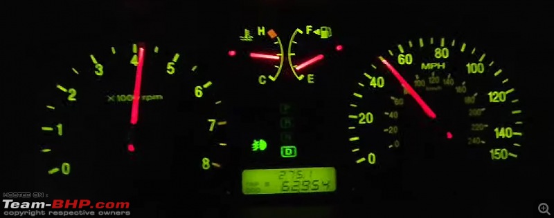

While searching for spares for the Sonata, I came across a website that sold Korean car parts.
While a lot of it was cosmetic stuff applicable on the outside of the car, I saw a very cool speedometer console that totally changed the look and feel of the speedo. I ordered it for ₹7k and it arrived about 2 weeks ago.
Old speedo console:
My Pre-Owned 2005 Hyundai Sonata 2.7L V6 | Ownership Review, Restoration & TLC-speedo-old.jpg
New speedo console:
My Pre-Owned 2005 Hyundai Sonata 2.7L V6 | Ownership Review, Restoration & TLC-speedo-new.jpg
To be clear, none of these pics are mine, just sharing to give you an idea. The panel will go onto my car once the rest of the parts arrive.

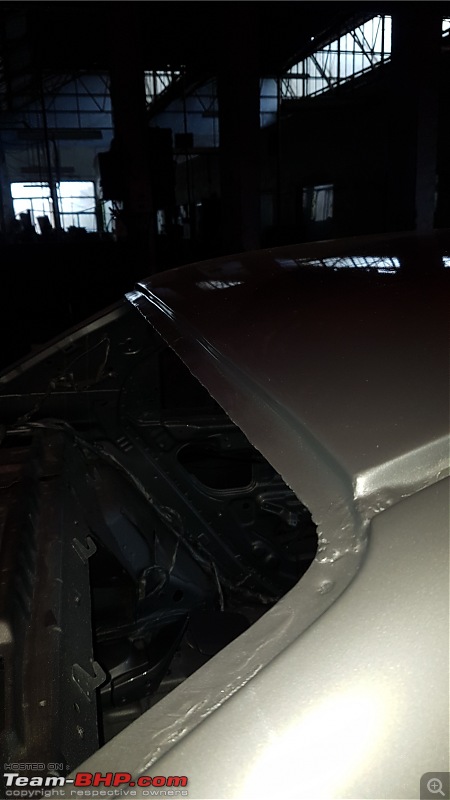

Work started on Monday, 12th Feb '24 for paintwork.
As it stands, the car's old paint has been sanded off and the body is now free of any dents whatsoever.
My Pre-Owned 2005 Hyundai Sonata 2.7L V6 | Ownership Review, Restoration & TLC-1.jpg
My Pre-Owned 2005 Hyundai Sonata 2.7L V6 | Ownership Review, Restoration & TLC-2.jpg
My Pre-Owned 2005 Hyundai Sonata 2.7L V6 | Ownership Review, Restoration & TLC-3.jpg

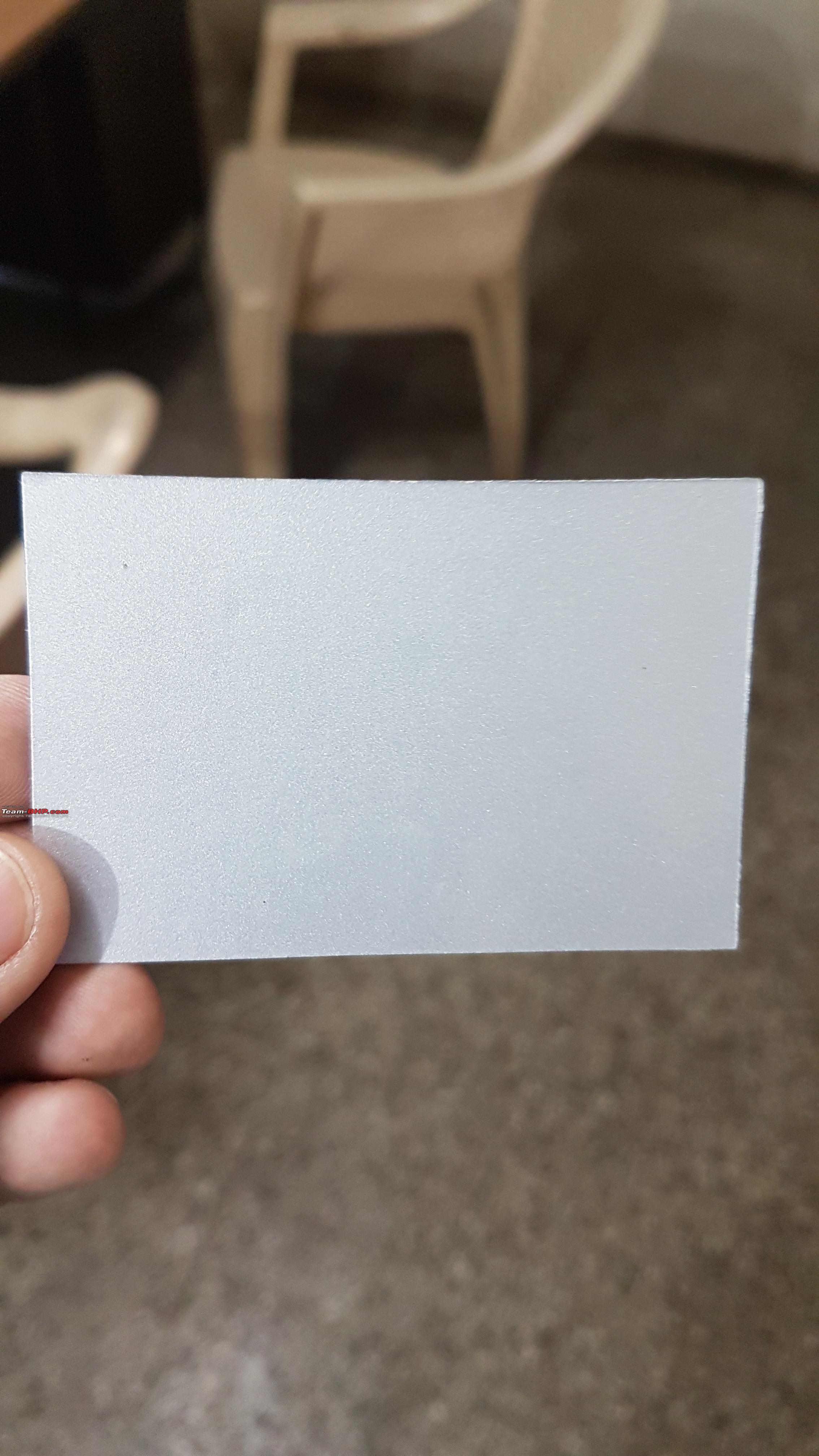

Today was the last day I had to choose the new paint colour. After much agonising over whether I should go for black, I eventually selected silver. Black was my first choice but I decided against it for the usual reasons - it's hard to maintain, has to be cleaned frequently to look good, and mostly because there are many chrome body trims that won't look so good on black.
Below is the paint code I chose.
It's nearly pointless trying to show the shade itself, because it doesn't look much like the real thing, but I'm giving it a go anyway.
My Pre-Owned 2005 Hyundai Sonata 2.7L V6 | Ownership Review, Restoration & TLC-paint-card-1.jpg
My Pre-Owned 2005 Hyundai Sonata 2.7L V6 | Ownership Review, Restoration & TLC-paint-card-2.jpg

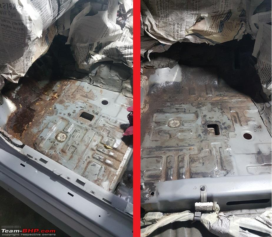

The last bits of surface rust are now being cleared away using a grinder. Here you can see before and after pictures of the front passenger footwell. Everything will now be sprayed in an anti-rust black coat and then body colour paint.
My Pre-Owned 2005 Hyundai Sonata 2.7L V6 | Ownership Review, Restoration & TLC-before-after.jpg

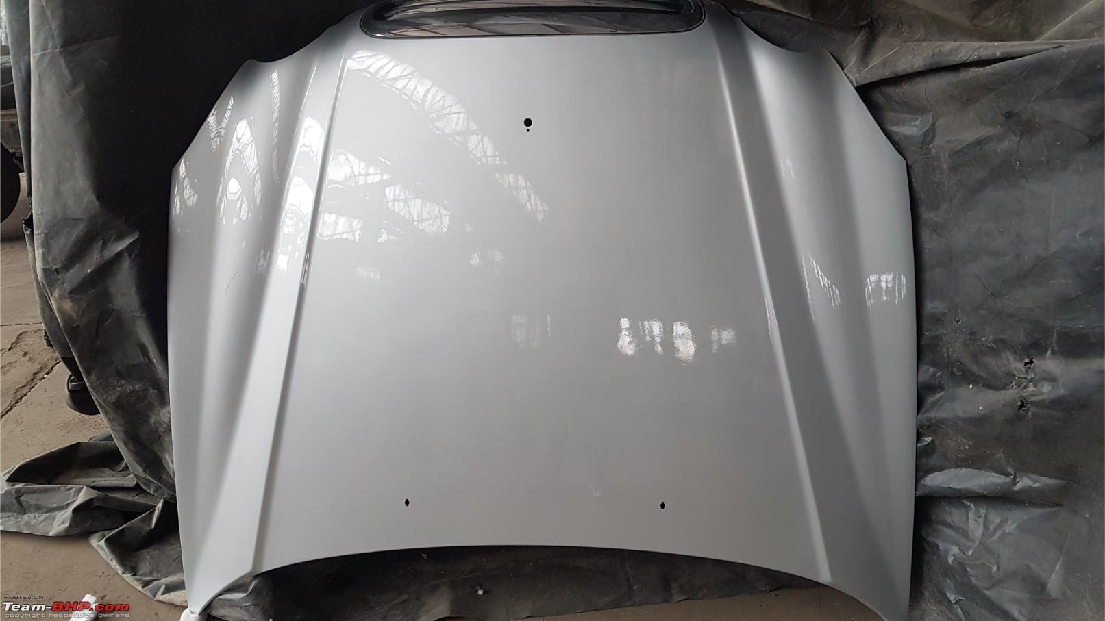

The paint process technically completed on Thursday, 29th Feb, 2 days ago. The car has been drying since. What's more, it rained heavily today here so we got the paint done just in time!
Decided to resize images prior to upload this time around to make it easier for everyone.
Pic of the car as it stands today.
Water drain area had slight surface rust. Cleaned up and painted. (Red is just a reflection)
My Pre-Owned 2005 Hyundai Sonata 2.7L V6 | Ownership Review, Restoration & TLC-2-ac-vent-cleaned-up.jpg
Entire interior sprayed, including the boot area.
My Pre-Owned 2005 Hyundai Sonata 2.7L V6 | Ownership Review, Restoration & TLC-4.jpg
My Pre-Owned 2005 Hyundai Sonata 2.7L V6 | Ownership Review, Restoration & TLC-5.jpg
All the old rust spots are now no more. The car is good to go for the next decade!
My Pre-Owned 2005 Hyundai Sonata 2.7L V6 | Ownership Review, Restoration & TLC-6.jpg
My Pre-Owned 2005 Hyundai Sonata 2.7L V6 | Ownership Review, Restoration & TLC-7.jpg
My Pre-Owned 2005 Hyundai Sonata 2.7L V6 | Ownership Review, Restoration & TLC-8.jpg
My Pre-Owned 2005 Hyundai Sonata 2.7L V6 | Ownership Review, Restoration & TLC-9.jpg
My Pre-Owned 2005 Hyundai Sonata 2.7L V6 | Ownership Review, Restoration & TLC-10.jpg
My Pre-Owned 2005 Hyundai Sonata 2.7L V6 | Ownership Review, Restoration & TLC-11.jpg
