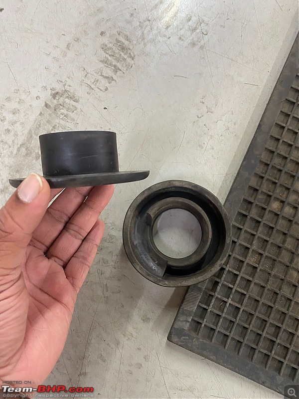

Oh, and before I forget, I took the liberty of removing the small little spacers (from the base of the rear springs) that comes from the factory on all India-spec 328i / F30 models.
Removing these spacers drops the ride height of the car ever so slightly by about 3-4 mm and cleans up the stance of the car without the need to install lowering springs while retaining near-stock like ride height for practicality and drivability.

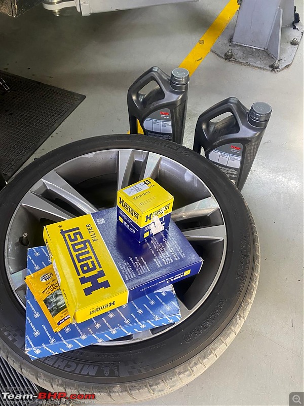

General Service:
Since acquiring the car in September 2023, I had put on about 7000 km as on April 2024. As per previous service records, the car was last serviced at 40,xxx km. Being a 12 year old car, and with summer hitting hard, it seemed prudent to get an oil change done.
Along with the oil change, I requested a coolant change (fresh coolant) since it hadn't been done in the last 5 years, and the usual consumables - oil filter, fuel filter, and more importantly the AC filter - which was also not done for a long time and has helped cut down the foul odour coming through the vents to a great degree! The oil was BMW specific 5W40 by Fuchs, supplied by AS Motorsport (Hyderabad).
