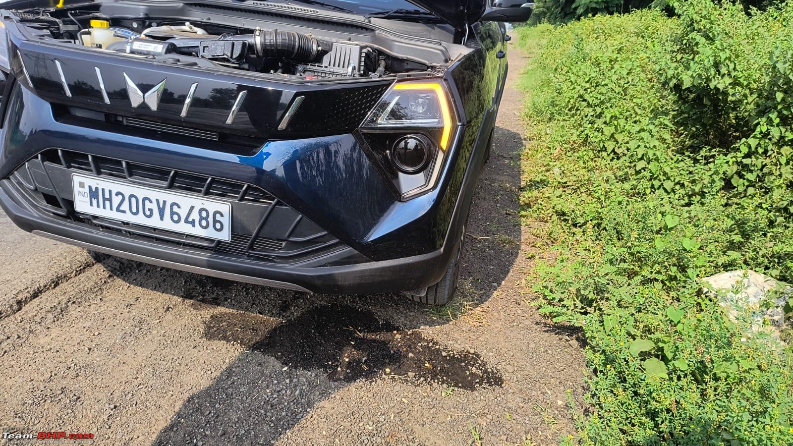

Breakdown Incident On First Long trip:

In the morning around 8 AM, I got call from Service Advisor asking the problem with the vehicle so I told them the situation and he assured that the issue will get fixed on the same day. At around 10 AM, I personally went to the SC to get details about the issue and they told me that the radiator has a leakage and they are checking and he also mentioned he is checking with authorities if this is manufacturing defect. After 20 minutes they called me near the vehicle and showed the leakage and said it is due to physical damage (I was really surprised by this statement as there was not even a single scratch on the vehicle and I also had captured video of under body as proof when coolant was leaking and there was no damage there). I had a lot of discussion with different authorities (Service Advisor, Supervisor, Service Manager) and everyone was asking me to pay for the repair cost or claim my insurance. I even tried contacting the dealership from where I had purchase my vehicle as the vehicle was just 15 days old but they didn't even bother to get the details of incident and asked me to check with service centre where the vehicle is dropped.
After all this disappointing experience, I decided to leave vehicle at SC only and escalate the issue with Mahindra support so I came back home without any resolution. I sent a mail to Mahindra support and attached Dashcam footage (if this wasn't there then definitely they would have refused to listen) and all the videos that I had captured. After lot of followups and seeing the footage they finally agreed to replace the radiator free of cost on 3rd day (they did not accept that this is manufacturing defect and rather asked me to write a letter to repair this as Goodwill)
Replacement & Quality Concerns:
On the 4th day when they actually started the repair work, I decided to personally go to SC and get it done in my presence. They replaced radiator and and filled the coolant and took around 20KM test drive (I went for test drive to ensure that everything is fine). After the radiator replacement, there was a burning smell coming from engine bay but the SA mentioned that this is due to spilling of coolant while filling and would go away in 2-3 days so I took the delivery of the vehicle and came back home.

After all this frustrating experience, I again went to the previous SC where the radiator replacement was done for the first service and the experience was again very disappointing. I just asked them to check for coolant level, engine oil level check because of the previous breakdown (also these are standard checks in first service). After waiting for 7 hrs, they finally delivered the vehicle and to my surprise, they didn't even bother to open the engine bay (I have video proof of the same) and they didn't even reset the service due warning coming in instrument cluster. I was very furious after seeing the service due warning in the instrument cluster and immediately called the SA and he mentioned I will guide you on call and you can remove it on your own but I insisted him to come near the vehicle and reset and after 10 mins he came and reset it. This shows how unprofessional the Mahindra staff is.

Originally Posted by mkmandar123 View Post
the coolant was leaking with heavy flow so decided to call directly to RSA....
Do you have any pictures where radiator damage is visible either from the time of the incident or at the service centre? Is it possible that something had hit the radiator, like a flying stone? Most radiators are pressure-tested before being cleared, so there has to be either a hit or a defect in manufacturing. Any hit will mostly leave a mark, whereas a leakage from the joint in case of a defect due to manufacturing probably will not have such damage.
Yes, I do have video of the damage. I have added it in my detailed video and the damage was not from front side, it was in the inner side and even if we consider that flying stone has hit the radiator then I feel that the manufacturer should give enough protection under body so that this doesn't happen as small stones will always hit our vehicle.

Thanks for your review. From your narration and images, it appears pretty sure that the said damage to the radiator is a manufacturing defect and not due to any road incident.
The SA should have been smart enough to realise the same and do the appropriate replacement without much drama, which they unfortunately didn't. Had they accepted that it was a manufacturing defect and got it replaced, it would have been a better experience and bolstered your confidence in Mahindra. Manufacturing defects do happen and then , identifying and accepting the same at the earliest is the way, the manufacturer makes good the loss of confidence and reputation from the customer.

If the damage to the Radiator was from the inside then how were they saying that this is due to damage by the OP? These are exactly scenarios where the dealers and service advisor's job becomes so so important. If they had handled this professionally instead of trying to save a few bucks, this entire episode would have been written differently by the OP. We all understand that any product as complex as a modern car can have issues. But if the client faces problems while getting these resolved then it leaves a lot to be desired from the manufacturer.
