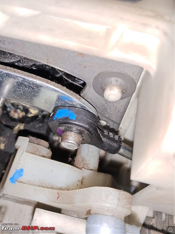

I was reversing my car in to my parking slot at home and was shifting between Reverse and Drive a few times. Suddenly the lever became free and started moving without resistance. Car was stuck in Reverse and was not parked yet.
Switched off and opened up the center console of the car. Just had to open up the cup holder and then two screws to remove the panel.
Mitsubishi Montero Review | My lateral upgrade from a Hyundai Tucson-dscn0199.jpg
The 4wd lever is screwed on the stick. The Gear lever is held by 2 screws at the bottom and the screws are covered by the garnish.
Found the linkage popped out of its slot. I forgot to take a photo so this one is from the ebay item i purchased.
Mitsubishi Montero Review | My lateral upgrade from a Hyundai Tucson-disengaged-lever-.jpeg
Found traces of the bushing under the linkage.
Mitsubishi Montero Review | My lateral upgrade from a Hyundai Tucson-disintegrated-bushing.jpeg
I put the linkage back without the bushing and parked the car.
Mitsubishi Montero Review | My lateral upgrade from a Hyundai Tucson-without-bushing.jpeg

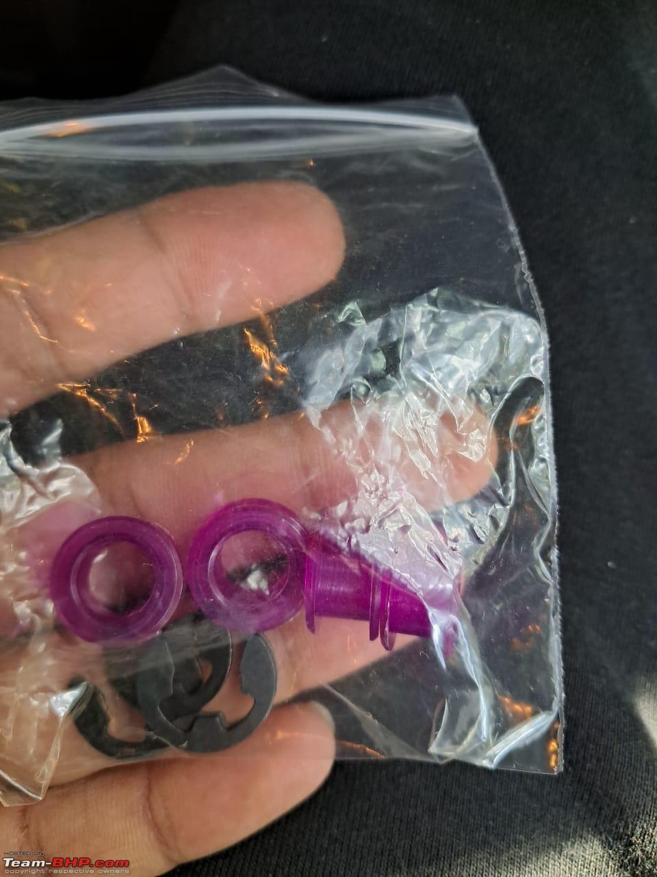

I could not find this part locally so had to order it from ebay. Lead time was 2 to 6 weeks. The ASIN gearbox is shared across many car manufacturers and the dimensions in this item matched the one i needed.
So I was driving around with the central console open much to the amusement of my kids. The linkage usually popped out whenever i try to put it in Reverse or Park from Drive. I popped it in manually and continued.
Received the bushing today after 3 weeks.
Mitsubishi Montero Review | My lateral upgrade from a Hyundai Tucson-bushing-lock.jpeg
Fixed it up and all is well now.
Mitsubishi Montero Review | My lateral upgrade from a Hyundai Tucson-all-fixed.jpeg
I have a few more bushings and if you need one for your car, hit me up.

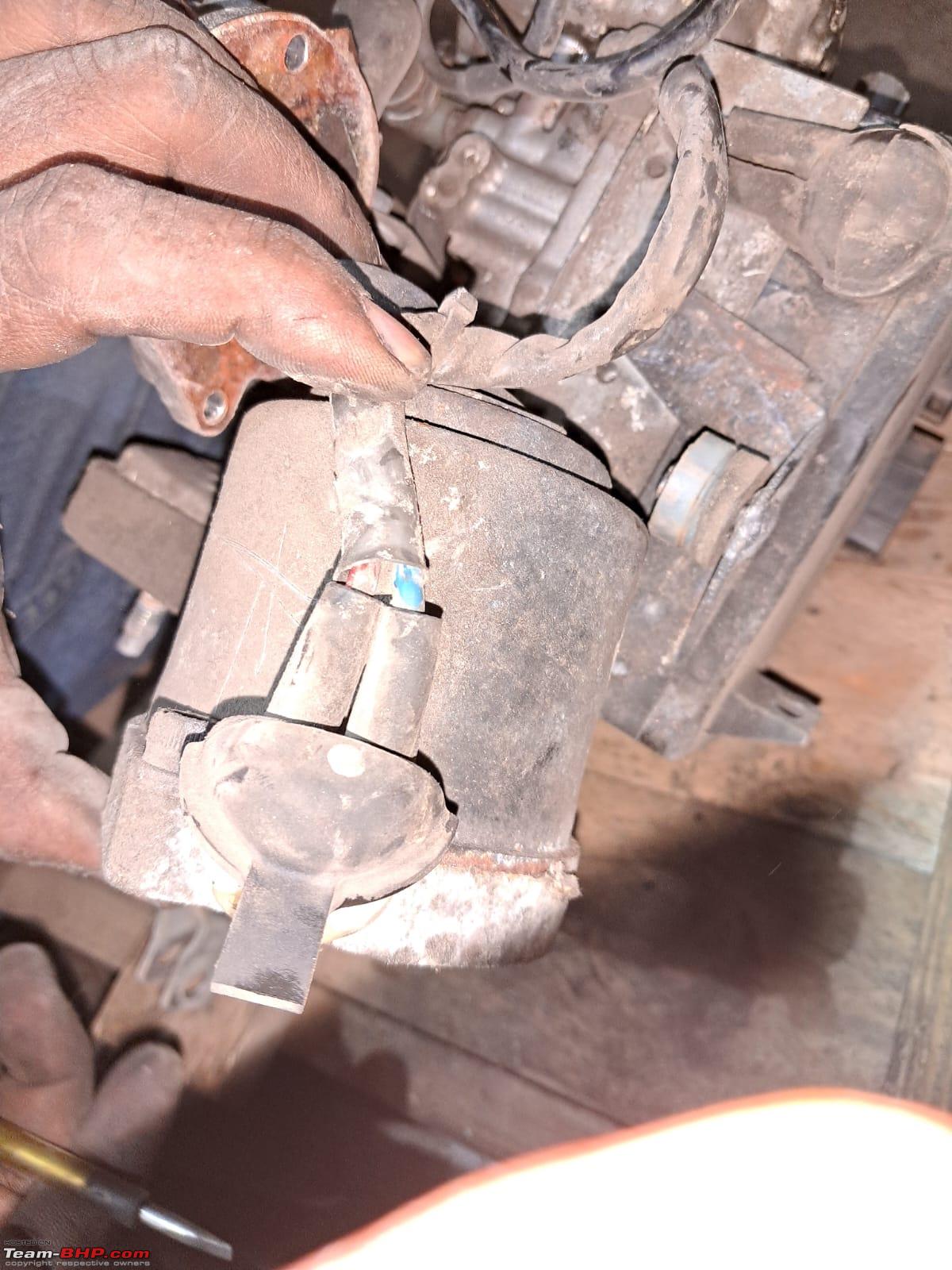

Refurbishing the ABS Brake Fluid Accumulator Motor

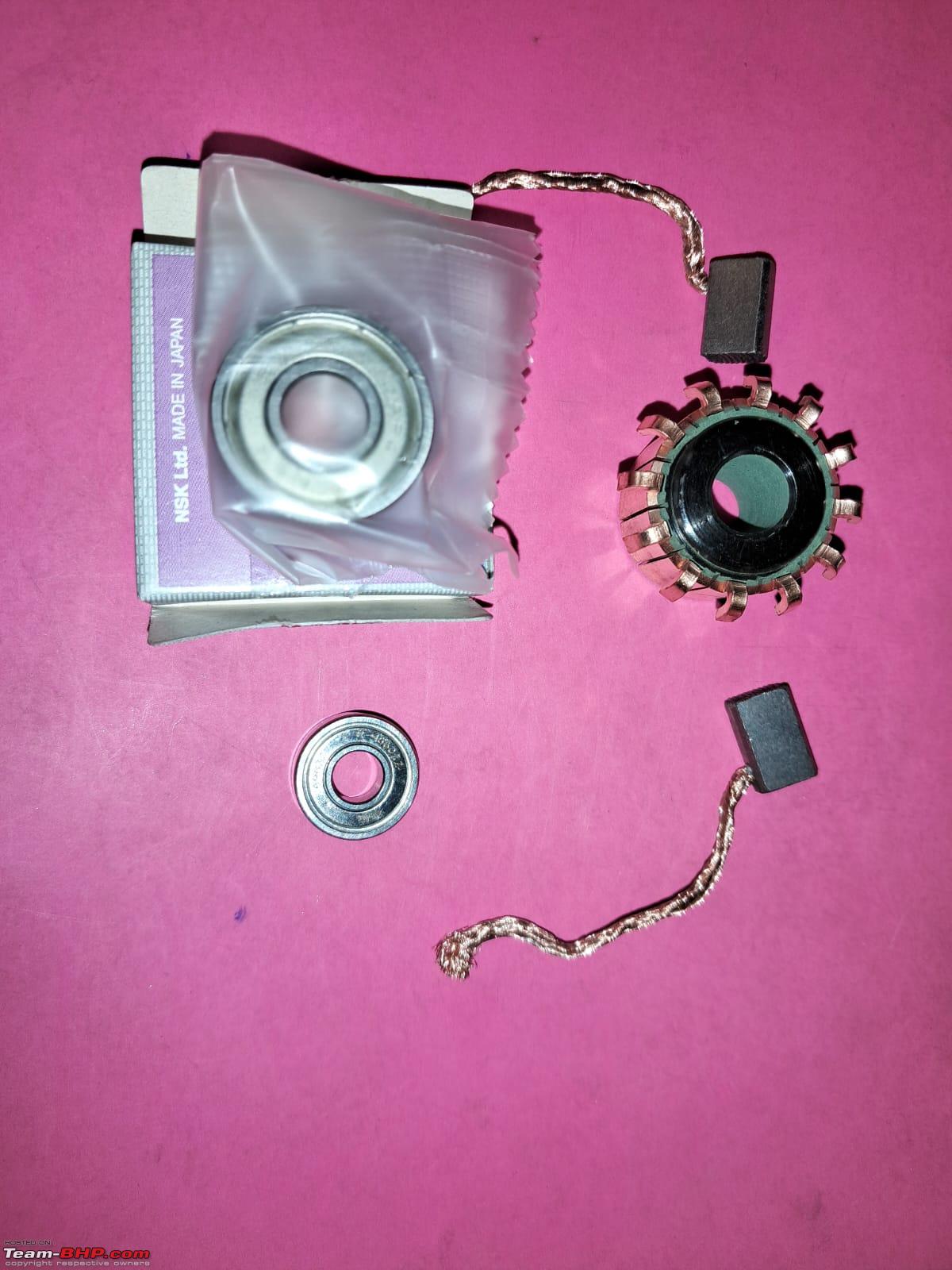

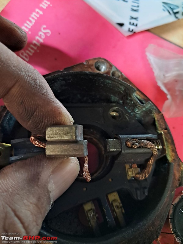

The car was munching miles over long trips and was performing well for a few months. Slowly, the brakes started feeling weird. The Montero's brakes are amazing and are pretty strong. The pedal started sinking on quick successive braking, I was not feeling confident to drive like this. This had to be fixed.
The Montero comes with the ASIN's Brake Booster unit similar to the one on the Toyota Land cruisers. This is an ABS Module + Brake Fluid tank + Brake Fluid Accumulator and the Accumulator's motor all combined into a single unit. The Brake Fluid accumulator is a pressurized metal canister that holds the brake fluid under pressure and a motor feeds the fluid into this canister. This keeps the brake fluid at constant pressure and boosts the brake. Every time the brake pedal is pressed, the fluid from the accumulator is passed on the brake lines, the pressure decreases in the accumulator and the motor is switched on immediately to pump the brake fluid from the tank into the accumulator.
Mitsubishi Montero Review | My lateral upgrade from a Hyundai Tucson-montero-brake-system.jpg
Since the accumulator holds the fluid with high pressure, the brake pedal feel is consistent and pedal never feels hard even when the engine is switched off. Compared to normal brake booster setup where the pedal gets hard by pressing it 2 or 3 times when the engine is off, this system will need you to press the pedal 30 to 40 times for the it to feel hard. When the brake pedal is pressed 30-40 times, the brake fluid from the Accumulator will all get released into the brake fluid tank by then and only then the pedal will start feeling hard.
There are only 2 failure points in this unit.
1) The Accumulator - Overtime, the pressure drops and it starts making chirping noise. That's the time to replace this.
2) The motor that feeds the accumulator - This is a simple motor with carbon brushes and over time, the brushes dig into the contact surfaces and finally it stops working. When its about to fail, you can hear this motor struggling to build pressure and it will run longer than usual. Its important to catch this before it fails, because if this fail, there wont be any pressure in the system and the car will crash.
The accumulator was not making chirping noises yet and our problem was diagnosed to the motor. So I ordered an motor rebuild kit from ebay.
Mitsubishi Montero Review | My lateral upgrade from a Hyundai Tucson-1-repair-kit.jpeg
The kit consists of 1 commutator, 2 copper-graphite brushes and 2 bearings
Mitsubishi Montero Review | My lateral upgrade from a Hyundai Tucson-2-repair-kit.jpeg

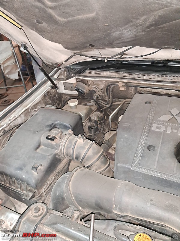

Let the pictures tell the story!
Mitsubishi Montero Review | My lateral upgrade from a Hyundai Tucson-4-remove-air-box.jpeg

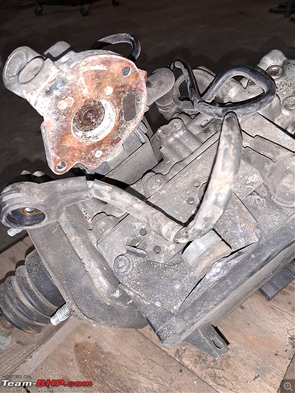

Mitsubishi Montero Review | My lateral upgrade from a Hyundai Tucson-4.1-drain-brake-fluid.jpeg
Mitsubishi Montero Review | My lateral upgrade from a Hyundai Tucson-5-disconnect-brake-fluid-level-sensor.jpeg
Mitsubishi Montero Review | My lateral upgrade from a Hyundai Tucson-6-disconnect-brake-lines.jpeg
Mitsubishi Montero Review | My lateral upgrade from a Hyundai Tucson-7-disconnect-brake-pedal-remove-unit.jpeg
Mitsubishi Montero Review | My lateral upgrade from a Hyundai Tucson-8-motor.jpeg
Mitsubishi Montero Review | My lateral upgrade from a Hyundai Tucson-9-disconnect-motor-power-connector.jpeg
Mitsubishi Montero Review | My lateral upgrade from a Hyundai Tucson-10-remove-motor.jpeg
Don't loose the metal wedge connecting the motor and the accumulator
Mitsubishi Montero Review | My lateral upgrade from a Hyundai Tucson-11-dont-loose-metal-wedge-connecting-motor-accumulator.jpeg
Mitsubishi Montero Review | My lateral upgrade from a Hyundai Tucson-12-closer-look.jpeg

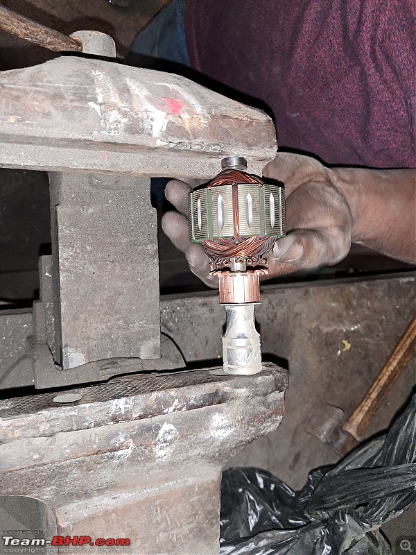

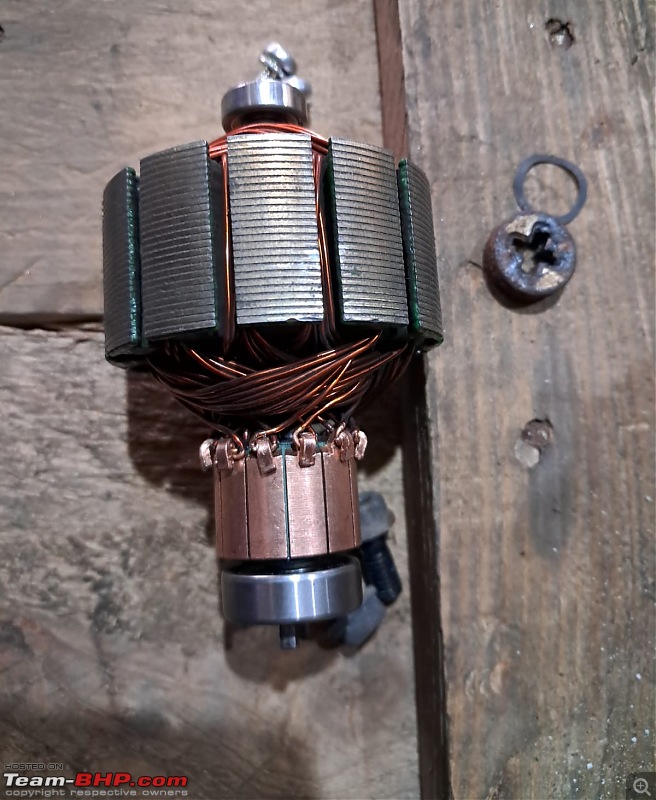

Mitsubishi Montero Review | My lateral upgrade from a Hyundai Tucson-12.5-dismantle-motor.jpeg

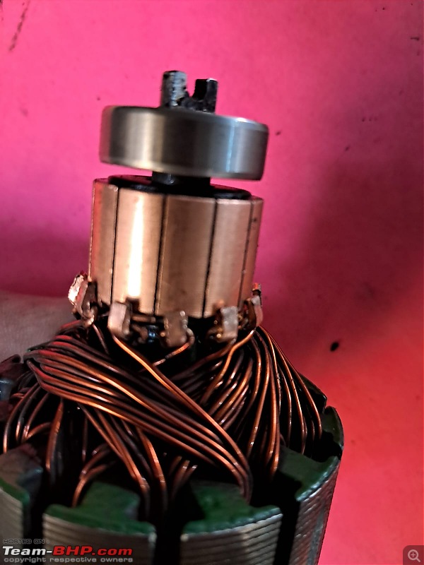

Inside the motor was too dirty and the commutator was worn thin. Glad I caught this on time.
Mitsubishi Montero Review | My lateral upgrade from a Hyundai Tucson-13-inside-motor.jpeg
Mitsubishi Montero Review | My lateral upgrade from a Hyundai Tucson-14-wear-commutator.jpeg
Mitsubishi Montero Review | My lateral upgrade from a Hyundai Tucson-14-.5-remove-old-commutator.jpeg
Old vs New commutator.
Mitsubishi Montero Review | My lateral upgrade from a Hyundai Tucson-15-comparison.jpeg
