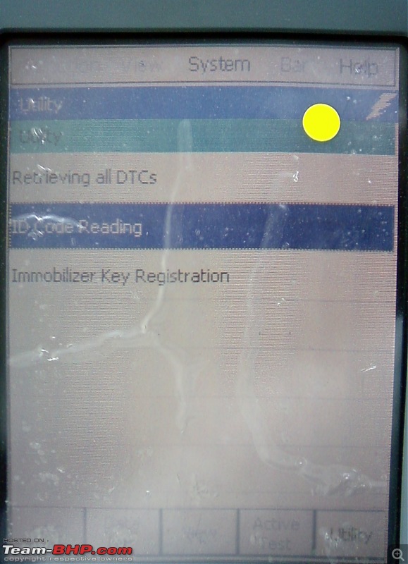

The engineers at Rana Motors connected the following device to find the error codes:
Ritz Vdi (ABS) gone bust in 7 days. EDIT : Solved. PICS on pg. 3-29082009122704.jpg
The device indicated injector No. 3 is not getting power:
Ritz Vdi (ABS) gone bust in 7 days. EDIT : Solved. PICS on pg. 3-26082009184623.jpg
The maruti Engineers team zeroed in on the ECM as the culprit.
Ritz Vdi (ABS) gone bust in 7 days. EDIT : Solved. PICS on pg. 3-29082009123136.jpg
The ECM costing arnd Rs. 20000 was replaced under warranty.
After changing the ECM, the real process of recalibrating the vehicle starts. For this various codes, etc have to be detailed from the factory. An interesting point was that the ECM change also disabled the AC and other electronics and all had to be recalibrated.

Also the ECM change necessasitated the recalibration of the car keys with the ECM ID. The ECM ID keeps changing every few hours. So the codes sourced today will not work tomorrow. (happened with my vehicle as the codes fetched by the workshop from the factory for Key calibration failed to work today and had to be resourced by sending the new ECM ID.)
Ritz Vdi (ABS) gone bust in 7 days. EDIT : Solved. PICS on pg. 3-29082009122717.jpg
So in short, the ECM is the brain of your car and doing a brain transplant is hell lot of work (and costly too though in my case warranty took care of that!)
