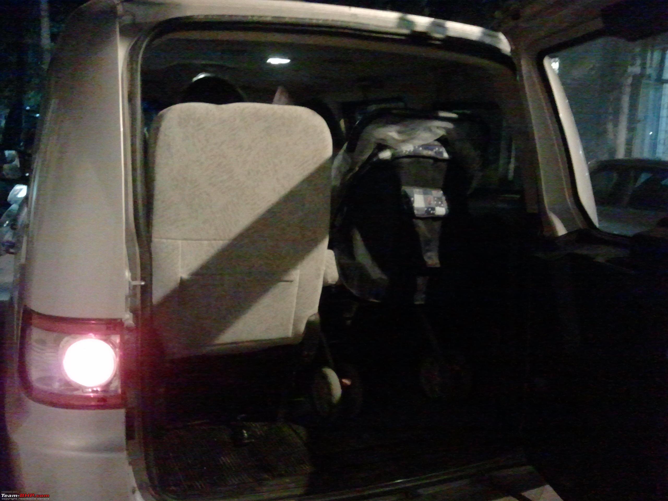

My father is been trying to work around the problem of luggage space with the third row of seats up. After talking with the service centre, he finally decided to procure a single seat which could be used in place of the bench on the third row. We discussed the options and narrowed down to the single tumbling and reclining seat of the middle row and the other was the front passenger seat.
A little insight into my engineer father’s passion with seating comfort can be found in our 96 Tata Sumo. It was a 10 seater with fixed bench seat to accommodate two passengers. First of all he procured a reclining mechanism from a Gypsy and got it retrofitted into the fixed bench seat which made the seat reclinable and enhanced the seating comfort for my mother. Next he set his sight on the middle row bench which was not reclined at a very comfortable angle. He got new holes drilled in the ‘L’-shaped bracket at either end of the seat and bolted them anew at a comfortable angle, but at the same time allow the side-facing rear bench seats to fold without being hampered by the reclined backrest of the middle row seat.
Continuing with the Grande, my father finally ordered for the front passenger seat after confirming about the mounting mechanism with the head service person at Autolinks with whom he has quite good relations. We had decided on the front seat as against the tumbling single seat from the middle row because, firstly the front passenger seat was larger and more comfortable and, secondly, even though the tumbling seat could have been more useful, but the entire recline, fold and tumbling mechanism was a bit complicated and not very easy to operate / user friendly, so we decided against it. The seat finally arrived at the service centre after about 15 days and it was for around Rs 10k.
I believe Tata Motors should offer the option of third row split folding seats and even Captain seats in the middle row. Considering the cost of a seat, the third row split folding seats shouldn’t cost more than Rs.20k more, keeping in mind that they are already offering a bench seat which also might be costing atleast Rs 5k. Dad finally set about designing a mechanism for mounting the seat in such a manner that there wasn’t any requirement of drilling any holes in the vehicle’s metal body. This required fabricating metal parts and the whole idea was to fix the seat at two main points:
  1. At the mounting notch on the side/wheel hump, where the front part of the bench seat rests. It is to be noted that the bench seat itself has been cleverly designed and the notch mounting allows one to fold and remove the bench completely without having to undo any bolts
  2. The second mount point is the ‘U’-shaped metal clamp welded on the vehicle’s floor. Another U-clamp (bull-dog clip) was used to secure the seat at this point, thereby having an inter-locking mechanism with the two ‘U’ clamps. The bull-dog clip was bolted on to a metal strip that was welded to the seat’s base metal frame.
This was a brilliant and innovative way of mounting the seat that Dad had thought about intelligently. I was specially pleased as no holes were drilled and no messy / half baked job was done.
Advantages:
  • Extra space for luggage
  • More contoured & comfortable seating with lumbar adjustment
  • Better under-thigh support
  • Built-in armrest
  • Adjustable head rest (can’t really use, due to visibility issues for the driver)
  • Seat can slide forward & backward (pictures with seat pushed furthest back)
  • Seat back pocket
Disadvantages:
  • Less headroom – I’m 5’7”, but with my turban I’m 5’9” and cannot sit comfortably as my turban hits the roof if I move my head.
  • Slightly less space/room to keep stuff as compared to a full bench. I’ll try to explain - even when luggage is kept on half the bench, we could keep cushions, food items on the bench, next to the luggage and there for still place for one person to sit. With the single seat, a person completely occupies that seat and the odd and ends may will need to be kept securely on the luggage – still have to try out that scenario, which shouldn’t be a long-time coming, as he goes on an outstation trip with friends / family every 3-4 months or so.
This new arrangement has been tested successfully recently. The entire family (parents, sister, grand-mother, myself, my wife and our 7 month old son) went to a club for an outing. We were easily able to fit in the full-sized pram/stroller in the empty space next to the newly installed seat on the third row. There was comfortable seating for 6 adults and 1 infant along with a pram (kept open, no need to fold it now). Excuse the camera phone picture:
