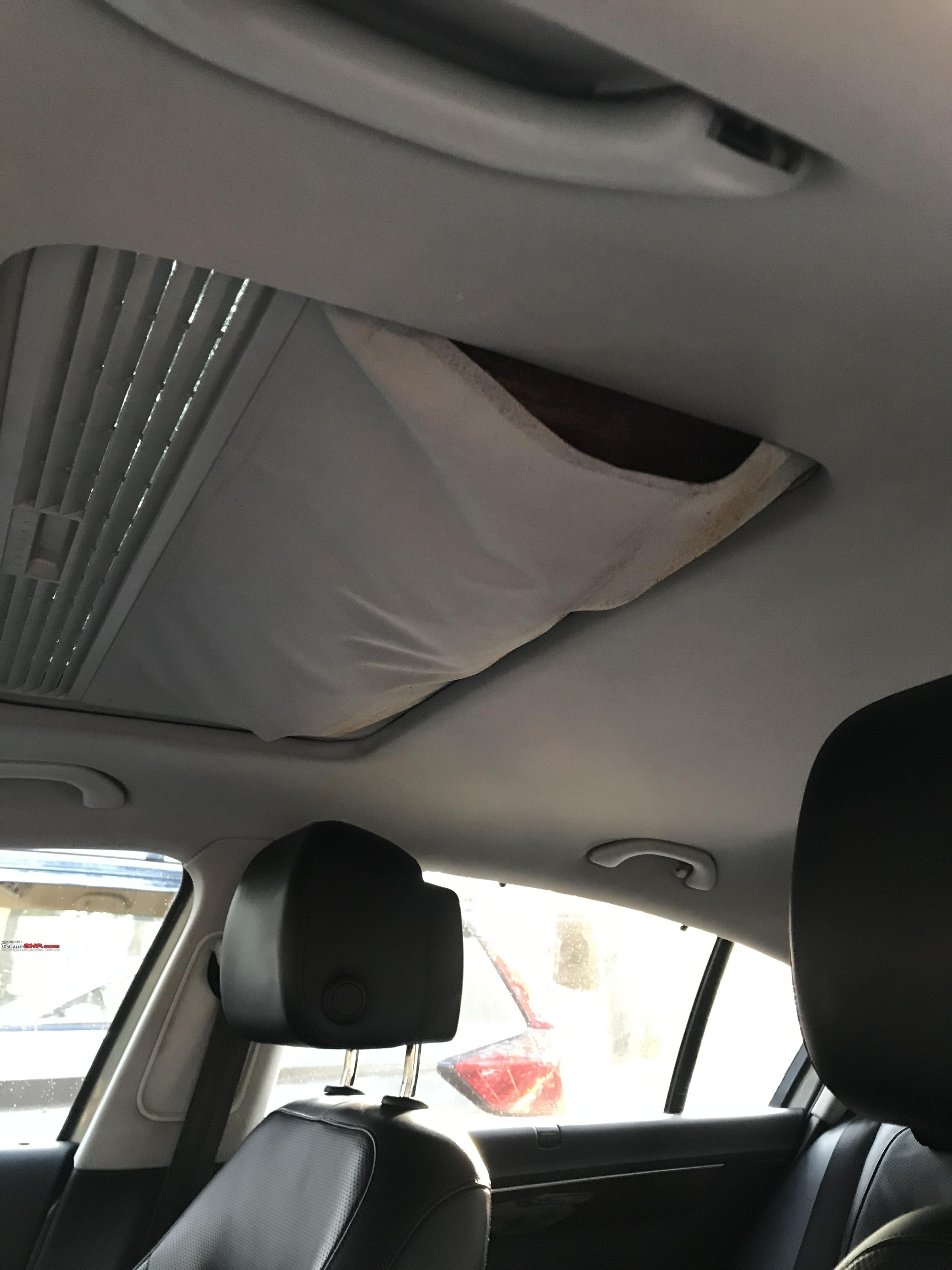

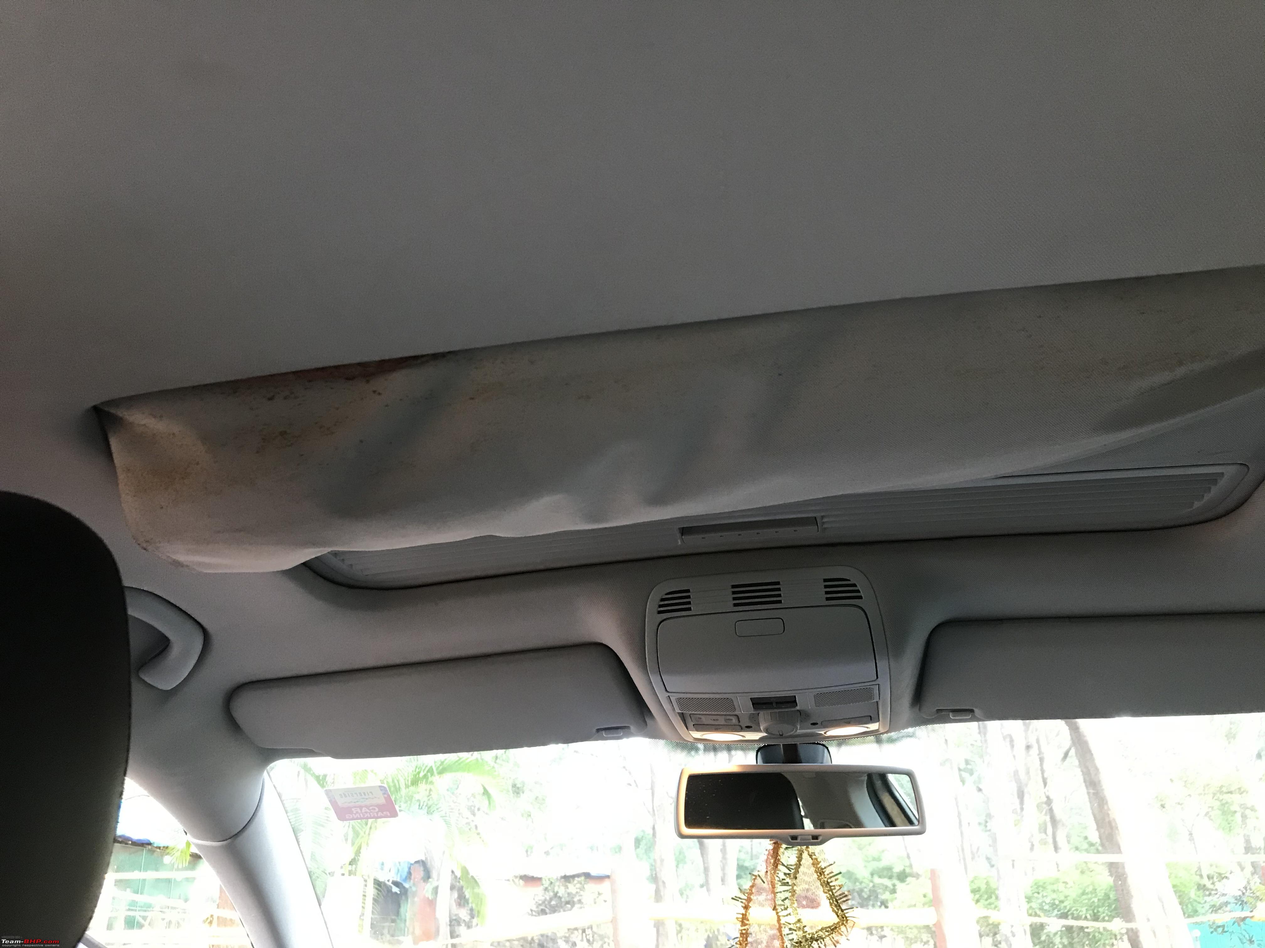

I was on journey from Hyderabad to Goa four days ago and my son tried to open the sunroof and the fabric came off. Please note that the entire headliner is in perfect shape but the fabric which covers the sunroof has come off. I do not want to replace the entire roof as it is in perfect condition. Will I be able to fix the fabric of the sunroof. Should I seek a car seat cover maker or 3M care guy who can stick the fabric using the 3M adhesive. I would like to know if anyone of you experienced a similar problem.
Between the two I'd pick 3M anyday - provided the outlet uses 3M products.
Extreme heat during summers will make the lining fall out again if treated with local adhesive at the 'seat cover' guys.
Are those water stains on the lining ? Did you accidentally leave the sunroof open a wee bit ??
No water stains at all but I saw some fine mud particles stuck to the fabric when it came off. May be it got accumulated there over the years. I was actually considering a sunroof servicing ( clearing the drains and greasing/lubricating the sunroof) at a webasto store near me. It’s surprising that sunroof maintenance is no way mentioned in the VW service manual. I am not sure if the dealership guys are aware/equipped for this job. I will be visiting 3M for the fabric work on 2nd jan 2020, will keep you posted.

Sorry for a late reply, I just checked this post of yours.
I faced same problem few months ago. I did these things:
1) Removed the top glass, removed the panel and again placed the glass back. (One has to remove the Sun roof glass to remove this panel.
2) Completely washed the panel as there was old adhesive over it.
3) Sourced fabric from local market costing approx Rs.300 for a meter. Though the fabric did not match exactly after fitting there is no visible difference.
4) Took the panel and the new fabric to a car seat cover guy. He charged some Rs.200 and carried the job to a satisfactory level.
5) Again removed the sunroof, placed the panel and got the job completed.
Note: Fitting Sunroof to its exact position and pasting the material are 2 of the most critical part in the entire job done.

Hi,
I got the sunroof fixed by mechanic who works for skoda showroom to fix headliners. He got a new fabric for sunroof and replaced it. It looks almost like the original one. He charged 3700/- in total. He also informed me that my roof fabric may also come off in a year or so and can be replaced for 10k.

My mechanic referred me to a person who works at the skoda showroom exclusively to fix car roof fabrics. He removed the sunroof fabric and replaced it with a new one which is almost identical. He did a very good job.
