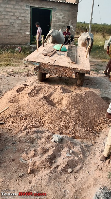

This was full of challenges. Sometimes heavy rains to lack of sand. Apparently, sand mining is banned and any tractor carrying sand can be confiscated. We had a water channel (seasonal canal) in our farm from where we could procure sand.
And that sand had to be brought on bullock carts as no tractor wala was willing to take a risk!

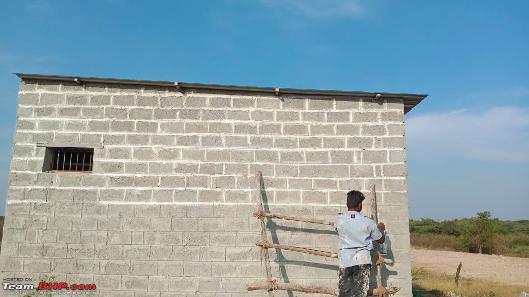

iii) Leaving exterior un-plastered with some grouting can give it a rustic look as well as save on costs. This is how it is coming up in my case:
Constructing a cottage on my farm | More reasons to drive-grouts-exterior.jpg
Even exterior plastering + plus a decent exterior paint is not so expensive.
Using above numbers, a 10'x15' room structure can be built for around Rs 1.2L.
