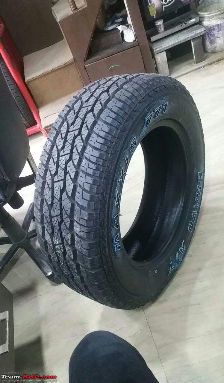

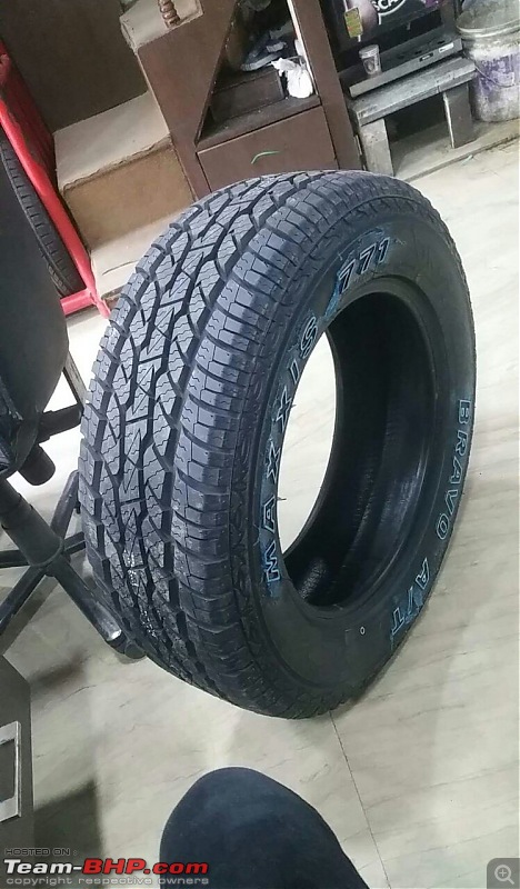

I did ask Siliguri BHPians for help and member johy and rahul_kej got back.[Thanks guys :)] As per the information they got, Pirelli is available in 2015 manufacturing date. The shops would take ~3 days to source it. One shop quoted a price of 12K and another at Rs. 11,200. The shop which has quoted the lower price, is suggesting to go for Maxxis. Here is the image.
All-Terrain Tyres for the new-gen Mahindra Scorpio?-622f5870199c4affac7e75689f6d2aaf.jpg
I am confused between both as going by prices, I assume, that Pirellis will be softer and Maxxis harder than Pirelli. BTW, Maxxis are quoted at 8K per tire. I am *not* looking to save $$$ especially as far as tire/s go. I have also asked a shop keeper to see if a Michelin Cross maybe imported.
My usage is highways, of all kinds, car would seldom be loaded to gills. Divider jumping [have to do this on frequent basis] and mostly on hard ground and mud/slush. Don't think will tackle rocks unless forced to.
