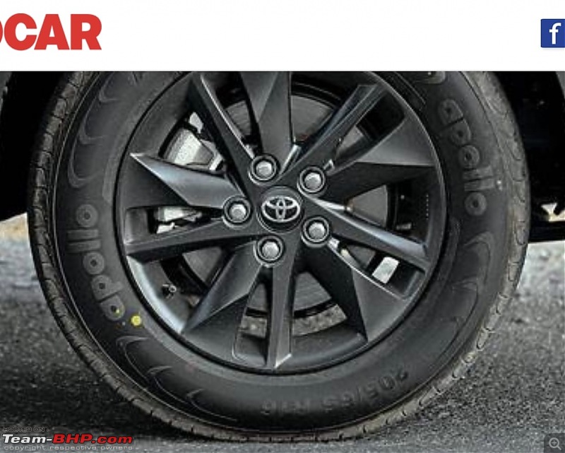

The challenge with finding the part number for 16" touring sport alloy wheels is that this type of vehicle was sold only for 10 months and touring sports variant sales itself is very low. And it becomes very difficult for the service advisor to find this part number without knowing the registration number of a Touring sport vehicle with 16" inch wheels. Luckily, the autocar review of Innova crysta touring sports was done on a car with 16" wheels. And the registration number of the vehicle was very visible on the photos as well. So, I just shared the details with the service advisor in Nandi Toyota and he could track the part number for the 16 inch alloy wheels.
Toyota Innova Crysta : Tyre & wheel upgrade thread-autocar_16_ts_tyre.jpeg

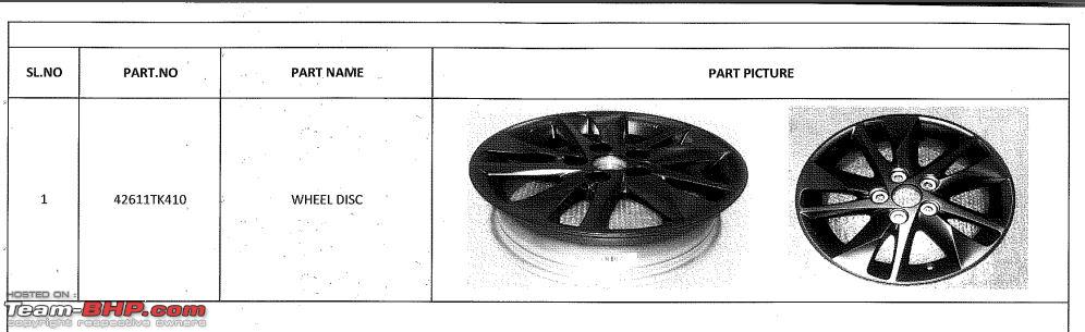

Part number for the 16" Innova Touring Sport Black Alloys - 42611TK410
Toyota Innova Crysta : Tyre & wheel upgrade thread-tyre_part_number.jpeg
The MRP is 17461/- per alloy wheel.

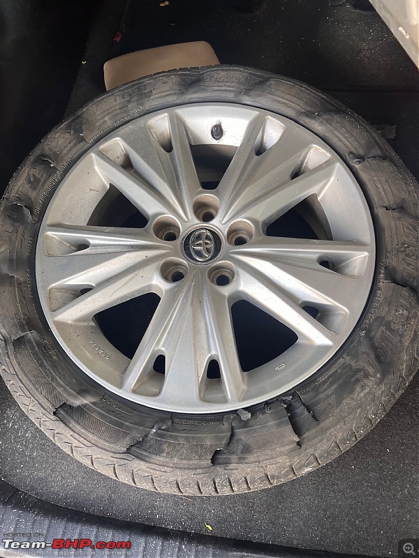

Toyota Innova Crysta : Tyre & wheel upgrade thread-p_20230603_182142.jpg
One of the tyres on my Crysta (Primacy 4ST in 215/60/R16 size) had a side-wall crack and the tyres have run only 32k Kms till now. It has been a very bad experience with the Primacy 4ST over the last 1.5 yrs. Too many punctures, even after maintaining a PSI of over 35 (recommended is 33).
Hearing about the good feedback about the UC6 from couple of T-BHP members, I opted for UC6. Was confused a bit if going with CrossContact LX2 in 215/65/R16 size would make sense as I had great experience with Primacy SUV Tyres in that size. However, opted against them as the primary objective was ride comfort and decided with 215/60/R16 size over the standard 205/65/R16 size, mainly for the extra width, even though there is a reduction of sidewall height by 1 inch.
I have been using Michelin Tyres for more than 12 years on all my cars and has been a satisfied user, but extremely disappointed with the latest 4ST compound. Just stay away from them.
