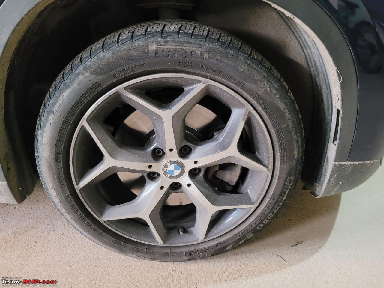

I never thought there will be a dedicated thread for BMW X1 Pirelli tyre woes. Then, I had my tyre bursts. One after another.
Incident 1: I has two tyres burst in Chorla Ghat, where there is no mobile network on trip from Mumbai to Goa. These tyres were original equipment that came with the car - BMW X1 Xline 2018 Aug model. Two tyres were right side front and rear., We couldn't even use a Stepney as two tyres had burst. These were Pirelli 225/ 50 / R18 tyres. (Runflat) More on this here
See pics of incident 1
I got both tyres replaced with the same make as there is a shortage of tyres of other variants (eg conti, michelin that fit). Finally, with two new tyres (Pirelli, P7, 225 / 50 / R18 - Runflat) which we fitted at the rear I left for Mumbai yesterday on 18.04.2021
Incident 2 With 60 kms to go from Pune, we had another tyre leak. While coming back I was driving around 80-90 speed maximum and avoiding potholes with every ounce of energy. The NEW tyre in the rear developed a crack and leaked. Can you imagine!! Thankfully a roadside punctre walla inflated the tyre to confirm the crack and helped change to stepney. I know we can drive only 80-100 kms on stepney but due to the lock down I had no other option. but to drive with family back to Mumbai. About 250 Kms at speed of 40 km/hour. While I am home and speaking to the Pirelli guys, it seems it is easy for these guys to claim that this was "accidental damage" and not manufacturing defect. They can deny any warranty based on that. Lets see. Pics attached
See pics of incident 2
Such a horrible experience with these tyres. Next, I will change all 4 tyres and to normal tubeless with strong sidewalls (NO RUNFLATS). I haven't decided about the brand.
TBH, it was hugely embarrassing to drive my family in BMW and both ways have to face such a tyre issue. Both BMW and Pirelli have let me down horribly. I am not the only one - there is a whole community, I realize of those who have suffered at the hands of such unreliable tyres.

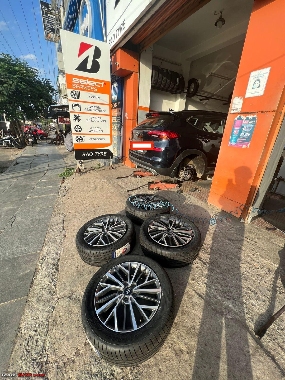

225/55R18 is the stock size on Tucson and one of our BHPians changed to the Vredesteins recently :-
Originally Posted by ramprakashr (Post 5377764)
Changed my Nexens to Vredestein Ultrac Vorti 225/55/R18 yesterday. Many thanks to BHPian RubberGuru1113 for reinstating the confidence on the Vredesteins.
Apparently the dealer's Apollo facility had a long wait time and he redirected me to their Bridgestone outlet to do the fitting, alignment and balancing. I had to pick the tyres in the passenger seat and drive to the Bridgestone outlet 3kms away.
I will let the photos do the talking.
Just before the drive to the tyre shop, with the old nexens :
Attachment 2344686
A look at one of the nexens after 27,500kms on the odo :
Attachment 2344681
The Vredesteins :
Attachment 2344682
Attachment 2344683
At the dealer's Bridgestone outlet
Attachment 2344687
The nexens were so very bad - inspite of the alignment, balancing and rotation every 7500kms. Two of the four tyres had 3 punctures each.
Drove a good 100kms with the Vredesteins. I understand the comparison might be odd given I'm comparing an old tyre to a brand new one, but the ride quality has improved multifold. The road noise has completely gone and there is good traction. Hope the vredesteins serve me well!
