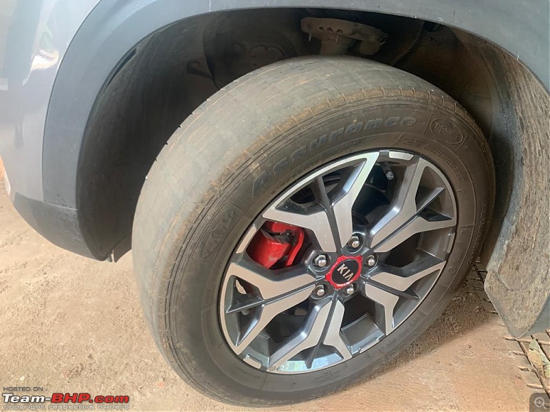

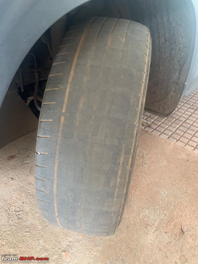

We have a Kia Seltos top-end diesel automatic in our extended family. It was purchased in Feb/March 2020.
The vehicle has been meticulously maintained and has completed 1K, 5K & 10K services.
The car has currently done about 17K kms and the front tyres are completely worn out.
Kia Seltos - Excessive tyre wear issue-whatsapp-image-20210105-1.24.31-pm-1.jpeg
Kia Seltos - Excessive tyre wear issue-whatsapp-image-20210105-1.24.31-pm.jpeg
Is there a way to address this to the manufacturer?

The outer side of the tyre is completely worn out. It is the same on both the front tyres? Get the alignment checked somewhere outside and see if the values are off. Next check would be the front suspension.
A RCA and rectification needs to be done before you change the tyres else the new tyres would wear off too.
You can reach out to the dealer but tyre is a wear and tear item. Not sure if they will cover under any goodwill warranty. The car has covered 7k kms since the last service, enough to wear out the tyre if the alignment is bad.

This seems like a wheel alignment issue (more wear in outer tread than inner tread).
Alignment goes bad if vehicle is driven on bad roads frequently (which is the case with most of the roads in India).
Goodyear Assurance tyres are using hard rubber compound so ideally they will have higher life (>35-40K KMs) than tyres with Softer rubber compound such as Michelin Primacy 4ST.

If alignment was skipped - this is the likely result. Your SA can essentially go do whatever to himself, go to a MRF Tyredrome or other MRF dealership, as these generally have top of the line Hunter and Corghi machines for alignment.
Since the alignment was done at Kia itself, you stand a chance to claim for the tyre though an alignment job can last only 5k kms provided the car is run on highways and not much of run in the hills etc.
Even after an alignment is done, it's a good practice to keep an eye on all the tyres regularly and check for abnormal wear, more so when you're on a long drive. A 1000 km is more than enough for a tyre to go from a very good condition to worse as seen in the picture.
You can push for a replacement under good will, or in worst case a 50% discount on new tyre. Guess it's a Good Year one which isn't a great tyre to start with. The tyre manufacturer also may honour a replacement, same needs to be routed through Kia itself I presume. Good luck.
