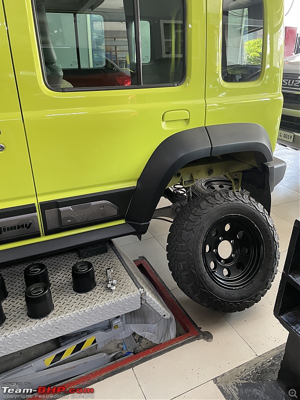

Installation wheel balancing and alignment at Madhus:
\Maruti Suzuki Jimny : Tyre & wheel upgrade thread-alloys-being-fitted-madhus.jpg

All in all very happy with the way the Jimmy now looks in the wheels department. Looks like a proper 4X4 (read Mini Bronco :p) now and certainly feels it too......:Cheering:
