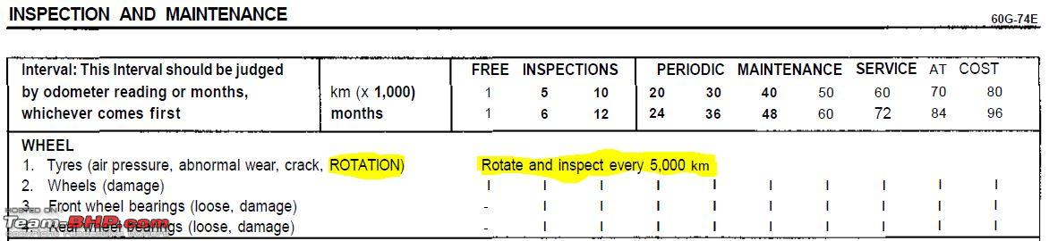

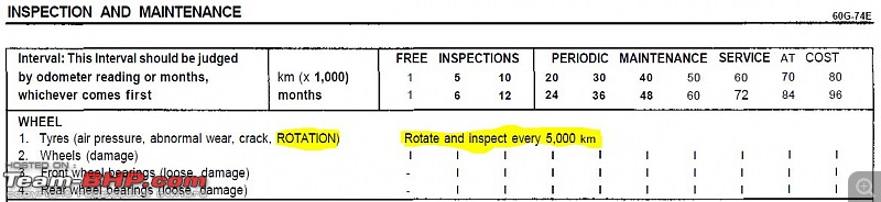

Well, they cannot use that excuse because the manual clearly indicates that rotation needs to be done as part of the periodic service(s).
Pasting below an extract from my Baleno's manual and I am sure it is there in the manual of all Suzuki cars.
You're right supremeBaleno. The manual does say that. Even my swift/desire manual says that. But wasn't done.
Have stopped counting in on these MASS and decided to get it done at a trustworthy place like Madhu's in Bangalore
