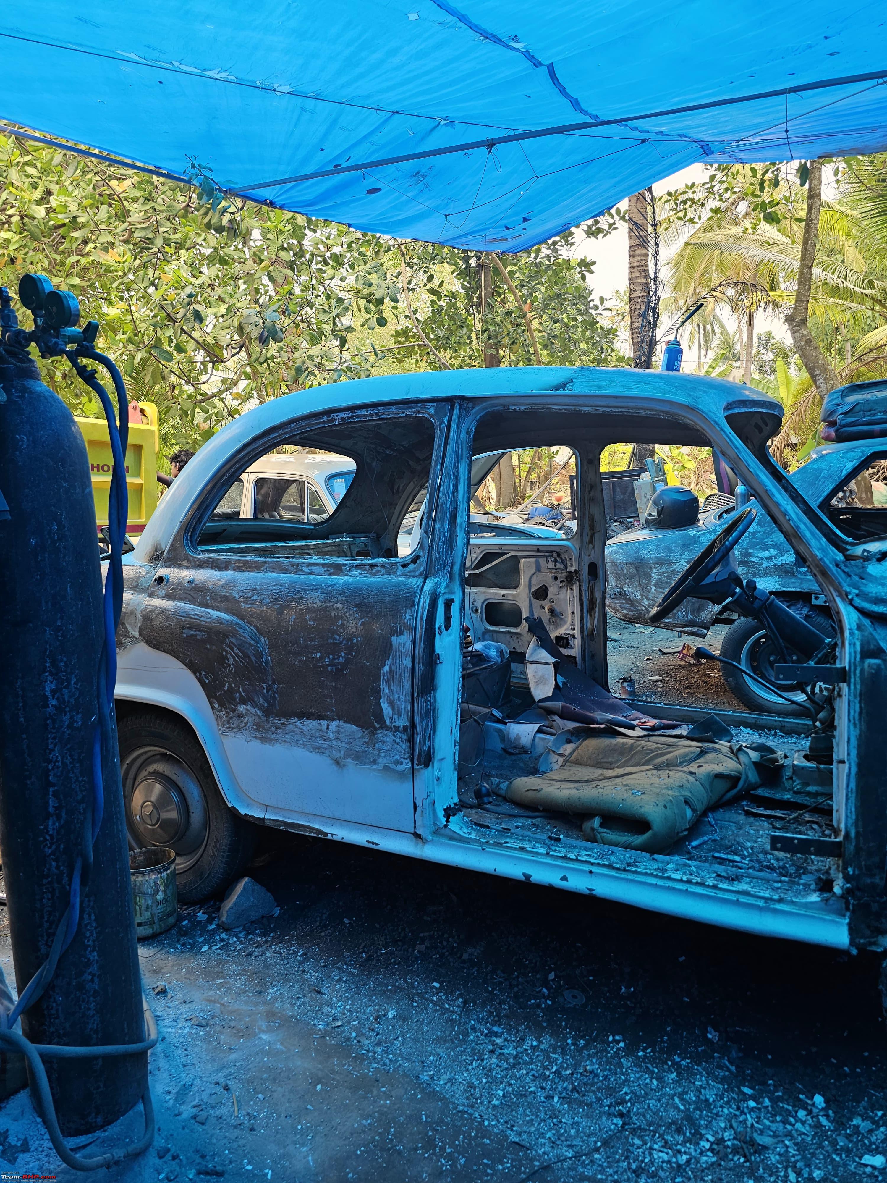

Bringing the Dream Back to Life – Hindustan Ambassador Restoration Begins!
Hi everyone, it’s been a while since I last posted, but the dream of restoring my Ambassador has never faded. Life, work, and other priorities made the past year hectic, but I finally made a special trip from the U.S. to visit Being Vintage in Trivandrum, Kerala. It was a fantastic visit—seeing their incredible collection of cars and spending time with family (not to mention enjoying some amazing seafood!).
After that visit, I made the big decision: it was time to send the car from Coimbatore to Kerala to finally kick-start the restoration project. The car is now on a flatbed trailer, making its way to its new home!
Vision for the Build
Since I’ll be bringing this car to the U.S., there will be some necessary modifications—like upgrading the brakes for modern roads. Externally, it’ll be a blend of a Mark 1 and a Landmaster, inspired by the Morris Oxford II. But one thing I refuse to compromise on is the column shifter. It’s how I learned to drive, it’s rare, and it holds strong sentimental value as a memory of my uncle.
Engine Swap Options
I’m currently exploring two engine options:
  • Isuzu 1.8L Petrol with the HM 5-speed manual column shift
  • Nissan SR20DET with the Nissan FS5R30A 5-speed (which can be adapted for column shift)
Does anyone here have experience with these swaps? Any advice would be greatly appreciated!

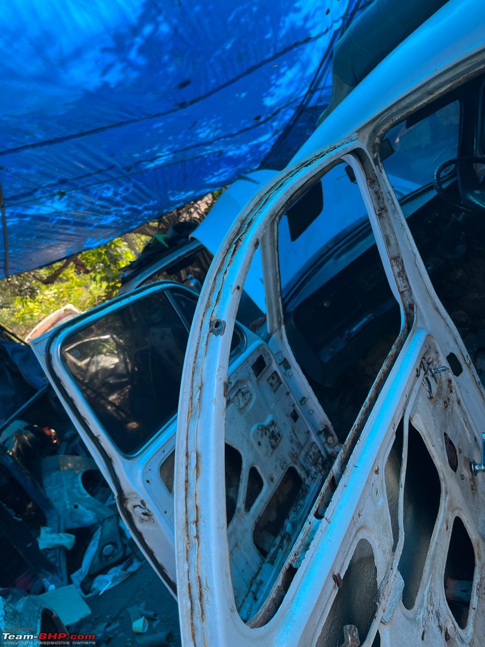

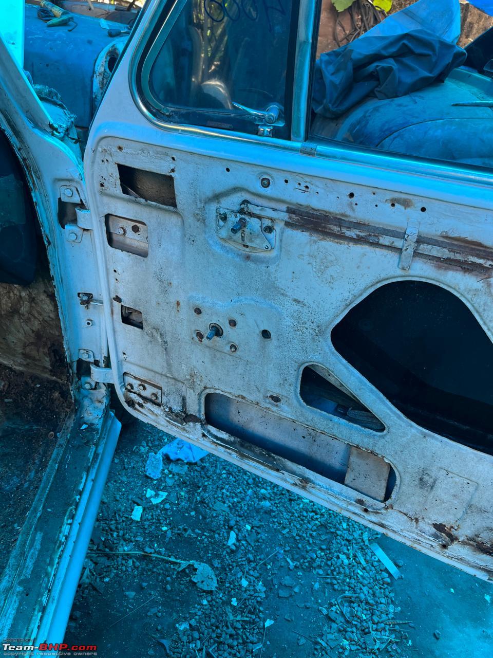

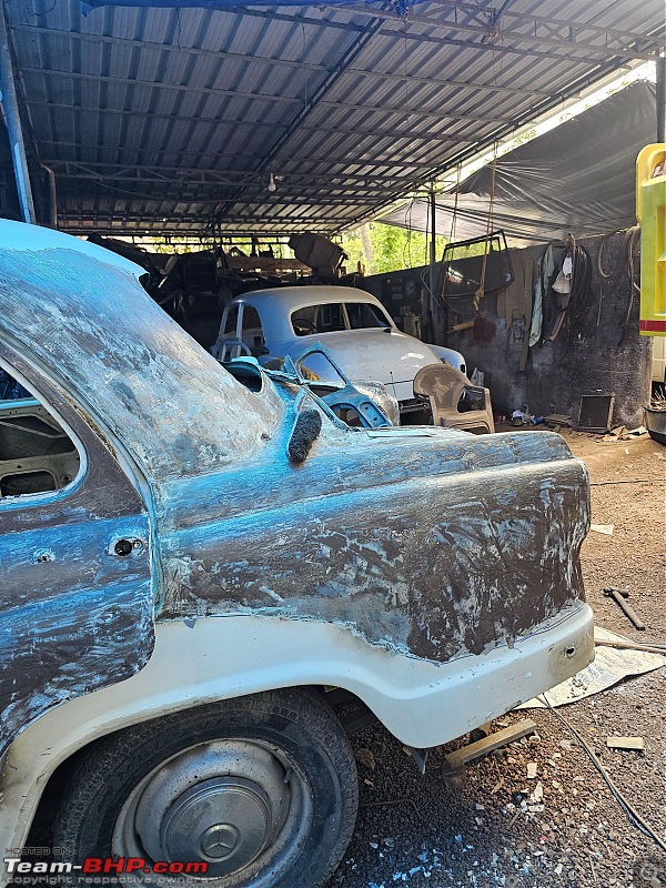

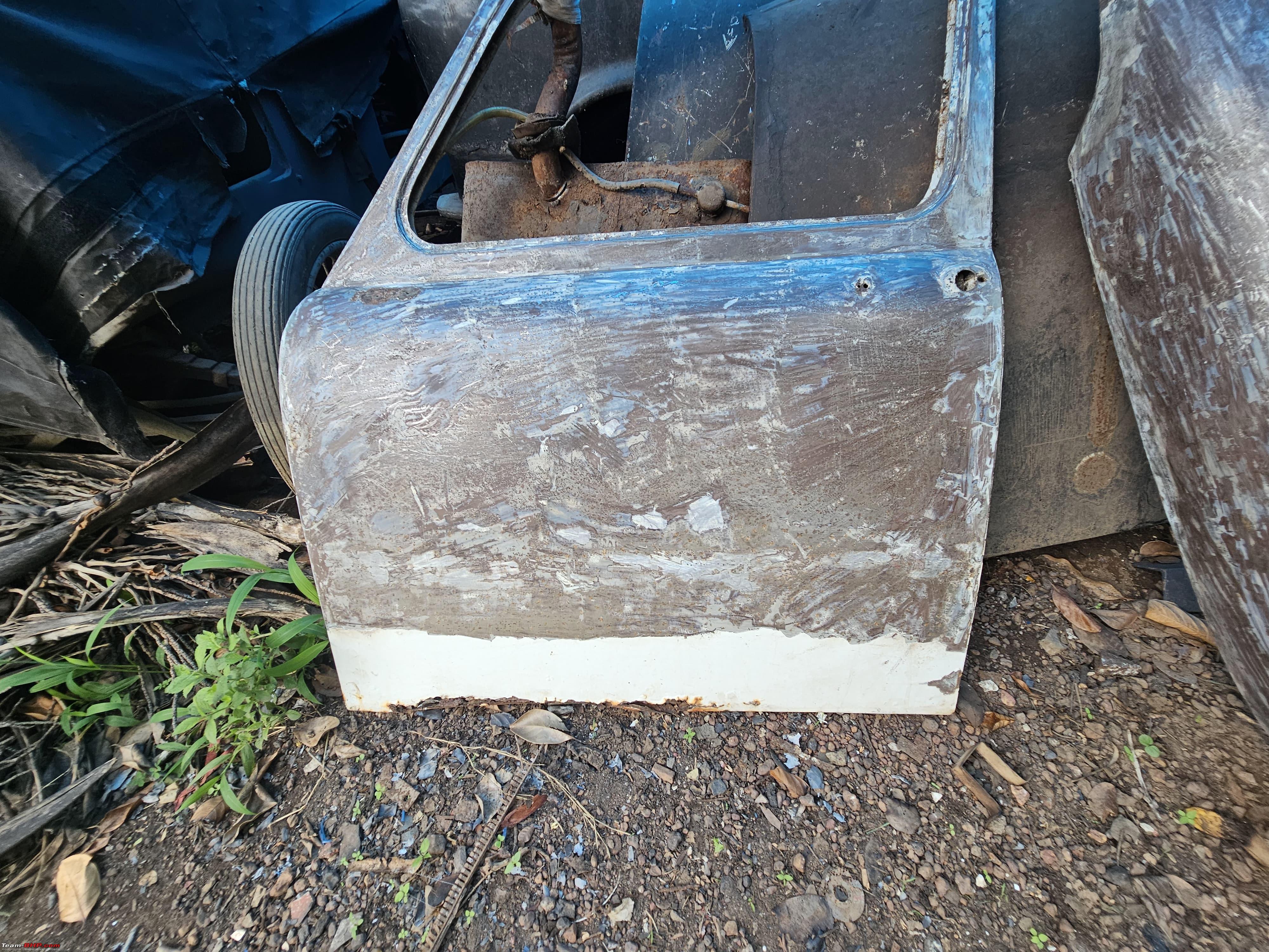

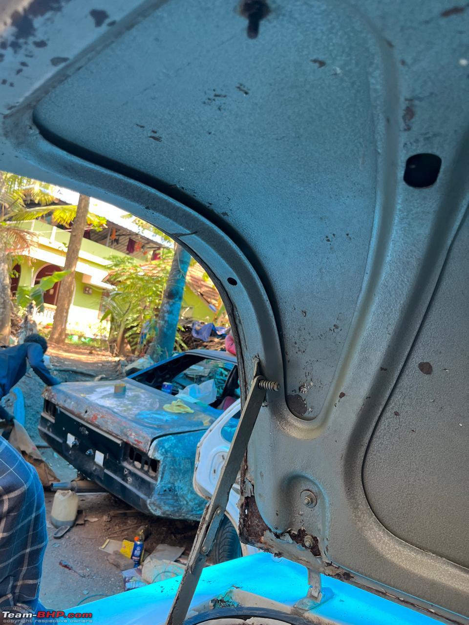

It’s been a while since my last post, and I’m happy to share that the car has now reached the workshop in Kerala, and work is progressing steadily.
Since arrival, the team has completed dismantling and begun full bodywork, which includes:
  • Rust repair, fabrication, and restoration of panels and critical areas) e.g. firewall, side box panels (where the door hinges mount), below the A-pillar and B-post, boot lid)
  • Custom fabrication of several sections too far gone to salvage
As the car is being rebuilt, we have time to lock in the final direction — which is to take the build closer to a Landmaster, inspired by the Morris Oxford Series II styling.
We are actively sourcing parts from within India as well as from the UK, Australia, or wherever available.
