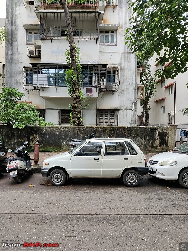

We saw a few cars listed online and a few more in person but none of them seemed to tick the right boxes. They were majorly rust buckets with multiple owners and expired paperwork. The fact that we wanted only a SB308 (Sold between 1986 and 1997) narrowed down the search greatly. One day while scrolling through a Facebook group I came across an ad for a 1995 Maruti 800. The Ad proudly mentioned that the car is a FIRST OWNER vehicle, being posted by the owner himself. It had its fitness and documents in order and was asking a very reasonable price. There was only one picture in the ad. The car seemed pretty decent going by that one image. I decided to send it to Chetan and he contacted the owner.
Restoring a 1995 Maruti 800 - Mission Impossible being made Possible-photo20230818105819.jpg
Purists would notice that the rims aren't original to the SB308 and are from the Type 2 model. But otherwise, the car seemed fine from this angle at least.

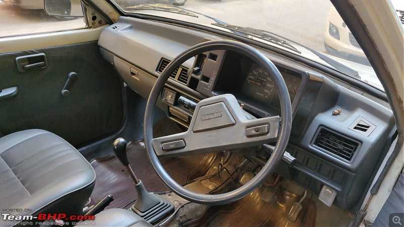

The car did look tired. It was dull, the interior had its share of wear and tear. The door trims were from a later model. But at least it was honest, unlike some of the others we had seen which had fat layers of filler putty painted over the rust to hide it and other hidden surprises. Note that this car was largely still on original paint apart from one of the doors and the bonnet which had been replaced at some point due to a small fender bender.
Honest opinion - Good base; mechanically seems good. Documents are sorted. Cosmetically needs attention.

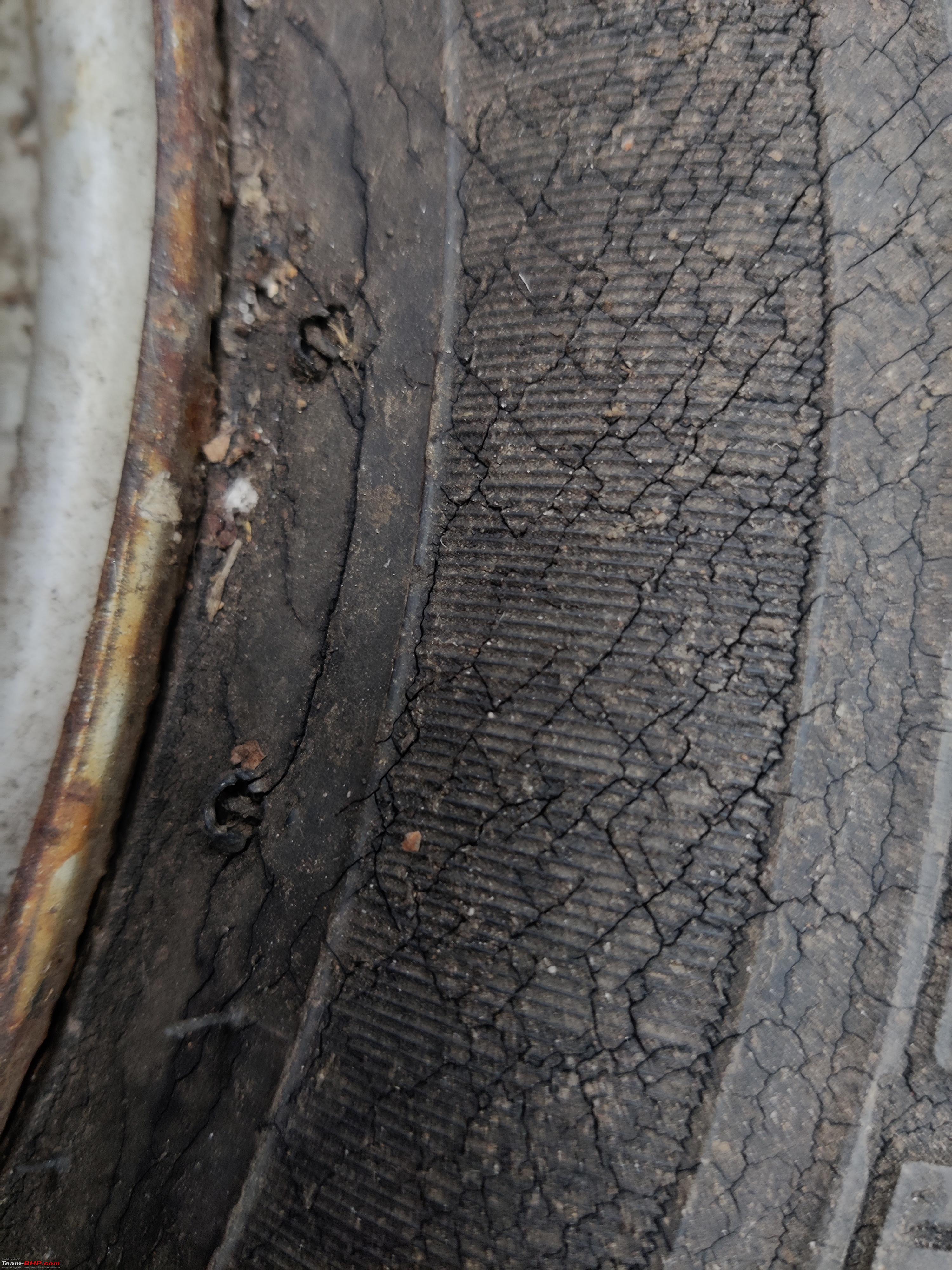

The absolutely atrocious condition of the old tyres. They were a set of Apollo Amazer tyres from 2007 and were way past their age a decade ago. I do thank my stars that neither of them burst on my way to the tyre shop. This also brings me to another point - About how changing tyres is often neglected by several people. People don't seem to understand the importance of having good tyres and the fact that in our Indian climate conditions, the rubber of the tyres does not last beyond 5-6 years at best no matter how much the car is used. Bad tyres will affect the suspension and in turn other components, furthermore it is dangerous. I have cried myself horse trying to explain it to some folks !
Once the new tyres were on. I heaved a sigh of relief. Finally the car would be safe to drive around and won't violently pull itself to the left. We aligned the wheels and went for a small drive in it. But alas, it continued to pull to the left; not as much as previously but it did not drive straight. That was strange. We decided to redo the alignment.

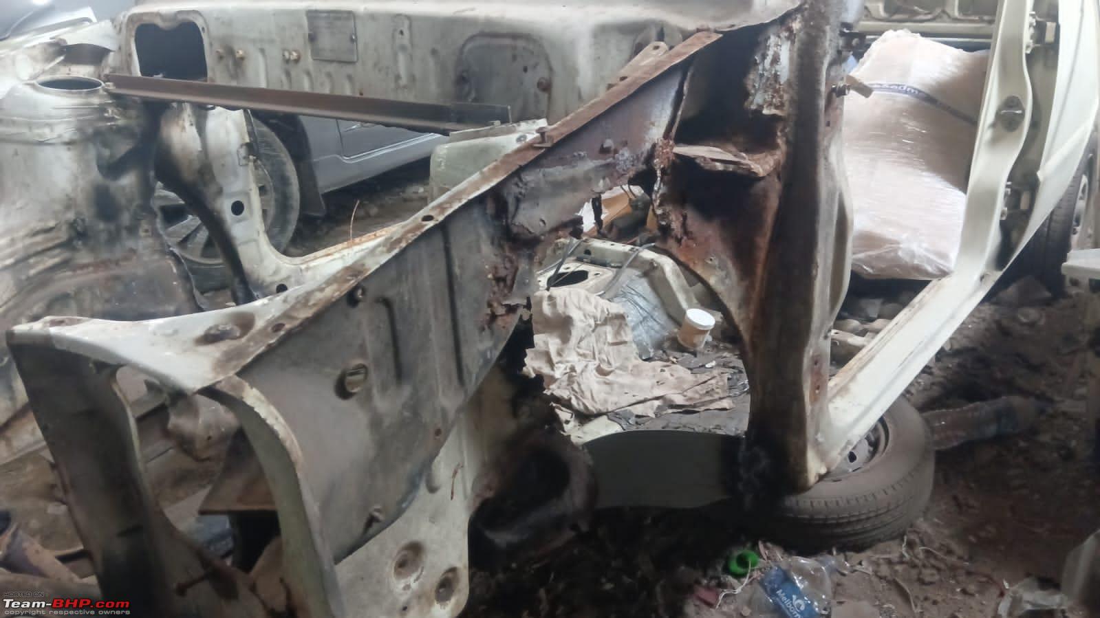

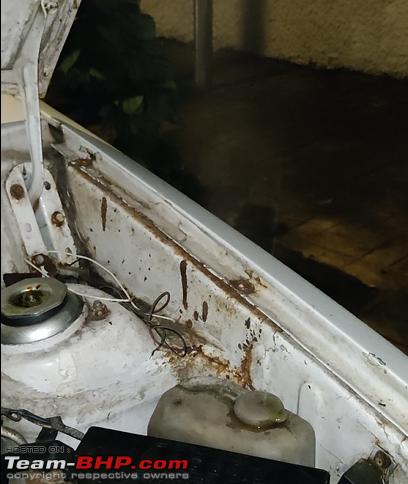

I decided to crawl under the car and have a look at how things look underneath. I did check the underbody the evening the car had arrived and it was okayish. Not as bad as I expected because the flooring and underbodies in old Maruti cars do rust and develop holes like swiss cheese if the rust is not fixe on time. This car however did not seem to have too much swiss cheese at all. OH, WAS I WRONG ?
Restoring a 1995 Maruti 800 - Mission Impossible being made Possible-e03654f939444be8b6e949609aeafc91.jpg
Restoring a 1995 Maruti 800 - Mission Impossible being made Possible-ff12711a4ecd44809d2efafa14df2b6d.jpg
And there it is ! Amidst the new suspension parts, the aprons on both sides were in complete tatters down below. This was a sure short death note for the car. Apron rust is an outright killer in old Marutis. I can cause the car to bend to one side and even if fixed, it may never drive straight again. Our car's LHS Apron was completely rusted out, and the rust had spread to the crossmember. No wonder it did not drive straight. I was dejected and upset seeing this. At that point I was reconsidering the entire project.
The tyre shop guys advised me to not take things forward. They said this kind off rust is impossible to fix and I quote - 'Sir, yeh gaadi banegi nahi, pura apron sadd gaya hai. Khalas hai !'
The comment was made in good faith and not to ridicule me. But I still felt ridiculed. I drove it home. Once again holding the steering diagonally. I wondered how I'd explain this to my friend and was ready to get an earful. I felt like such a fool. I wondered why didn't I just wait before going ahead with this car ?
I sheepishly sent the images of the rusted aprons and underbody to Chetan. On receiving a call from him I expected to hear a bunch of cusses. But on the contrary, he was quite cool. He said that we have now buried our hands deep into a pit, but it is not endless. So we must continue and try our level best. So with that dose of motivation I decided that the show must go on !
So I decided to use the car while commuting to short distances. I did not take it beyond 5km away from my area. Sure the tyres made a difference and so did all the new parts. If only it wasn't for the rust !

I had to rip off the RHS doorpad because the glass kept falling down and was a headache to roll back up as the winder would keep getting jammed. So I just did it manually with my hand.

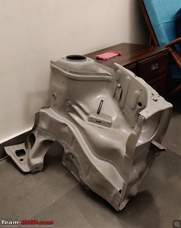

The most vital part which would help save our car. This is the apron. The LHS was found on Boodmo. I was lucky to also find the RHS a week later via a helpful agent at Sai Service who directed me to a supplier who luckily had one in stock.
One of the biggest advantages of restoring an SB308 800 is that the inner panels are the same for all the cars produced between 1986 and 2014. So finding them may still be possible. In case of the ss80, it would be much tougher.

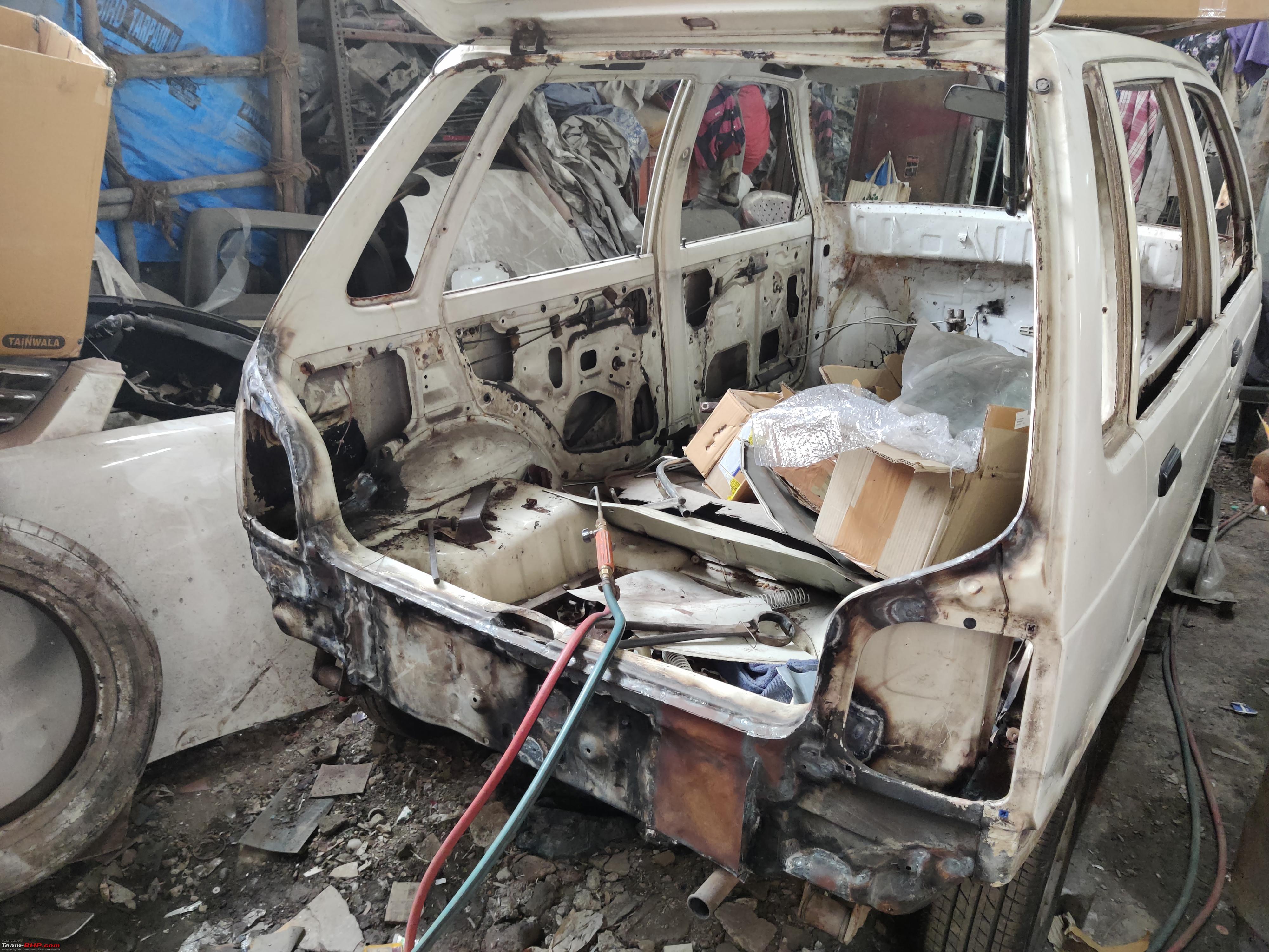

Rajesh called me two days later and told me I should go over to his workshop to have a look at what we had in store for ourselves. He mentioned he would prefer if I was present while the car was being stripped down. I arrived there at noon on a Saturday and the car was taken apart before my eyes within 45 minutes. I stood there with my jaw wide open looking at the efficiency of the guys, but also because of what stood in front of me.
Restoring a 1995 Maruti 800 - Mission Impossible being made Possible-img_3473.jpg
Attachment 2581370
Attachment 2581329
Restoring a 1995 Maruti 800 - Mission Impossible being made Possible-img_3472.jpg
Restoring a 1995 Maruti 800 - Mission Impossible being made Possible-img_3475.jpg
Restoring a 1995 Maruti 800 - Mission Impossible being made Possible-img_20231114_150414.jpg
Restoring a 1995 Maruti 800 - Mission Impossible being made Possible-img_20231114_152732.jpg
Restoring a 1995 Maruti 800 - Mission Impossible being made Possible-img_20231114_150501.jpg
Restoring a 1995 Maruti 800 - Mission Impossible being made Possible-img_20231114_151102.jpg
Restoring a 1995 Maruti 800 - Mission Impossible being made Possible-img_20231114_150427.jpg
Restoring a 1995 Maruti 800 - Mission Impossible being made Possible-img_20231114_150536.jpg
Restoring a 1995 Maruti 800 - Mission Impossible being made Possible-img_20231114_155550.jpg
Restoring a 1995 Maruti 800 - Mission Impossible being made Possible-img_20231114_152452.jpg
Gosh. That was bad. It was scary to see how the corrosion had made a nasty meal of the bodywork. Everything was jammed and needed to be welded out. I was initially skeptical about how the car would feel after the old aprons were cut out and new ones were welded on. The tinwork man named Rehaan assured me saying - Brand New jaise banegi .
The following day, I received some images from Rajesh. Clearly, he and his team were working hard. They had already cut off the old rusted front end dash panel and readied the new one to weld it on.

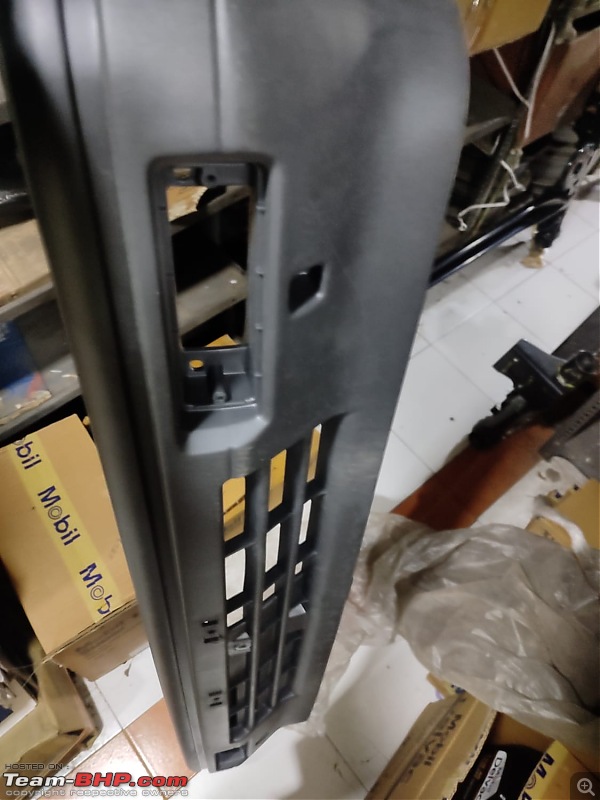

The grill was alright. But we decided to get another one to stock up.
Restoring a 1995 Maruti 800 - Mission Impossible being made Possible-img_20231023_233508.jpg
I also got hold of the pre-facelift grill which came on the SB308s from 1986-1995. Just for the heck of it. Post 1995 cars got the grill our car has.
