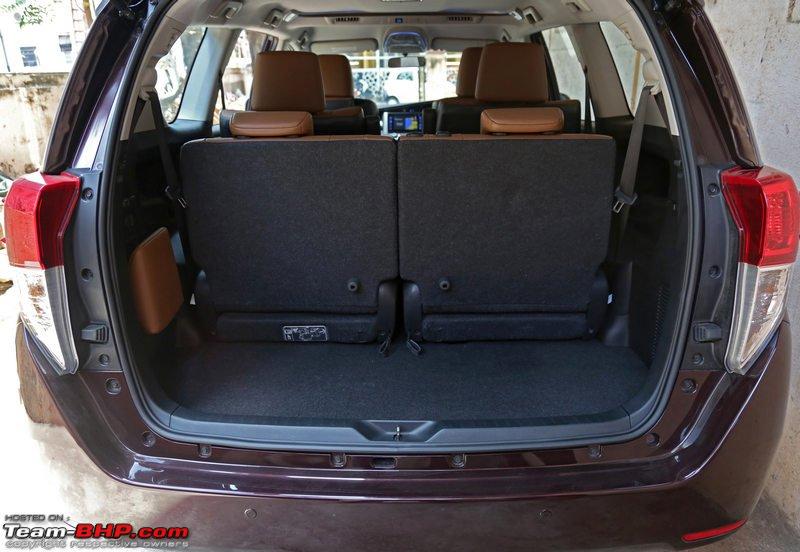

- 2nd row seat must have the 'tumble & fold' feature. This will allow for easier access to the 3rd row (remember you have to haul yourself inside and secure both kids to the child/booster seats)
- Make sure the car has atleast 200 litres of bootspace with all 3 rows up. That way, you get minimum (200+400) litres of cargo space. Also, vehicle with large boot is safer for 3rd row passengers in case of rear impact
