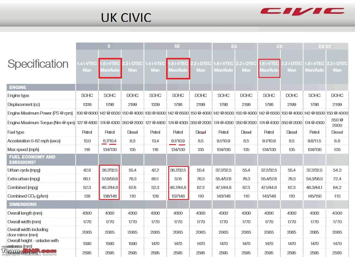

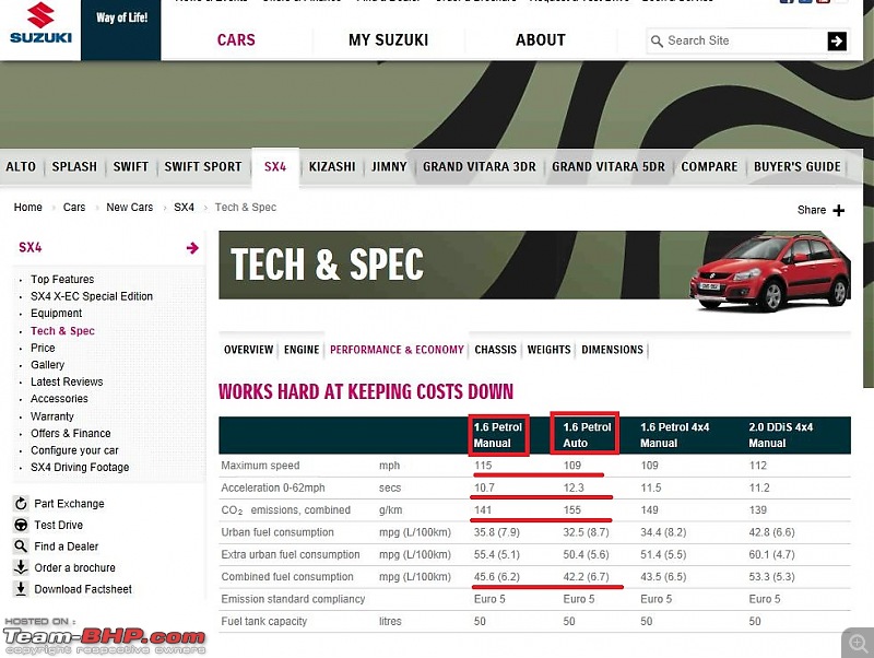

I agree with your view on 'ease of driving' as you mentioned above.
BUT, it is not understood on what basis it can be said that AT is faster that MT in 99.99 cases. And the word "at least in 99.99 cases" and "modern computer controlled auto box is definitely faster" are not justified till its basis and concepept are made clear. The expression 'At least' or 'definitely, sounds like an assumption which may the on the concept that - what is modern or computer controlled must be faster/top most.
But it is a matter of energy which cannot be generated without any basis, there must be some reasons, if there is none - no power is there. Power comes from same engine - on the contrary kerb weight is not less than that of its MT version.
AT car's kerb weight is more - 50kg or above. A part of power/torque generated by engine is used in torque converter (a part in auto box) to control the box to shift gear to the next higher/lower gear suitable at the power generated at that time and speed of the car. Computer's role is mainly to regulate the engine according to pressure on gas pedal.
Shifting to lower gears (especially when at or below 3rd gear) by pressing brake pedal - which also consume power through torque converter.
Nearly 15% to 20% power is used to run Auto Box. Where comes this power from?
Moreover, in AT only sequential (1, 2, 3, 4, 5) gear shifing is possible whereas in MT we may shift from 1 to 3, 3 to 5, etc to save time for speed since the raised question - which is faster?.
FACT IS:
1. Kerb Weight of the Car with AT is more 50kg or above. (Weight reduces FE)
2. MT attains 100 kmph nearly 2 seconds ealier (nearly at ratio of 12:10).
3. FE in AT is less than 1.5 to 2.5 kmpl than that of AT. (power used also in torque converter).
4.Gear Ratios are defferent where AT's overdrive is prominant though RPM cannot cross normally RED LINE in Tacho. Less Top speed in AT.
5. Moving and shifting in AT are at sufficiently higher RPM to avoid failure and/or to ensure run with power.
6. Top speed is less in AT. (Indicates also low top RPM inspite of overdrive gear ratio at 0.551~ (comes below 0.6~) where as MT's ends with 0.7~/0.8~.
7. Carbon emmission is higher in AT. (Reducing FE, power).
8. Overall better performance.
9. AT only gives our comfort, ease of driving especially in city ride.
Following are the basis and facts are in support of the above:
Regarding comparion see the following image (RED LINED portion) of extracts from wiki and specification of disclosed by manufactures (Suzuki UK for Swift, SX4 & Kizashi; Honda UK for Civic, Honda India & Thai for City.)
