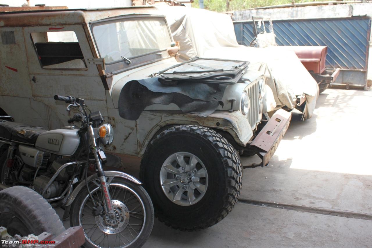

There is a problem in selecting axles , the front 57"axles will hit the mudguard with the bigger tires , suggestions needed.
Posting the pics of the JEEP with 33" tires kept next to the fender.

Frankie the 33" tyre is overkill for such a vehicle, trust me on this. 31" is more than enough.

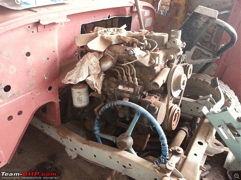

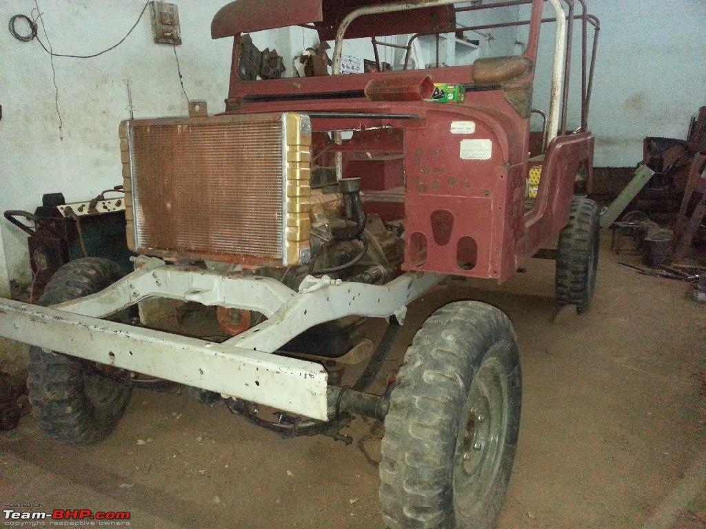

A late update. Body work is almost done . The engine i choose finally was the isuzu 4bd 4.L 4 cylinder engine with the kmt 90 gear box with aluminium transfer case.
The 4 engine mounts and 4 gear box mounts are almost done. 4 inch rugged ridge lift is installed. Fly wheel weight is around 36kgs . Got this engine from an excavator (Hitachi ex 60).
It revs upto 4500rpm and develops 22kgm + torque right from idling .
Posting some pics with 31 inch NDMS tires .
Pending work .
Power steering
Roll Cage
35 inch tires
Seats
Fuel tank etc.
Any suggestion and scope for improvement are welcome .

What was the approx weight of the engine+starter+alt? Can the chassis take it?
