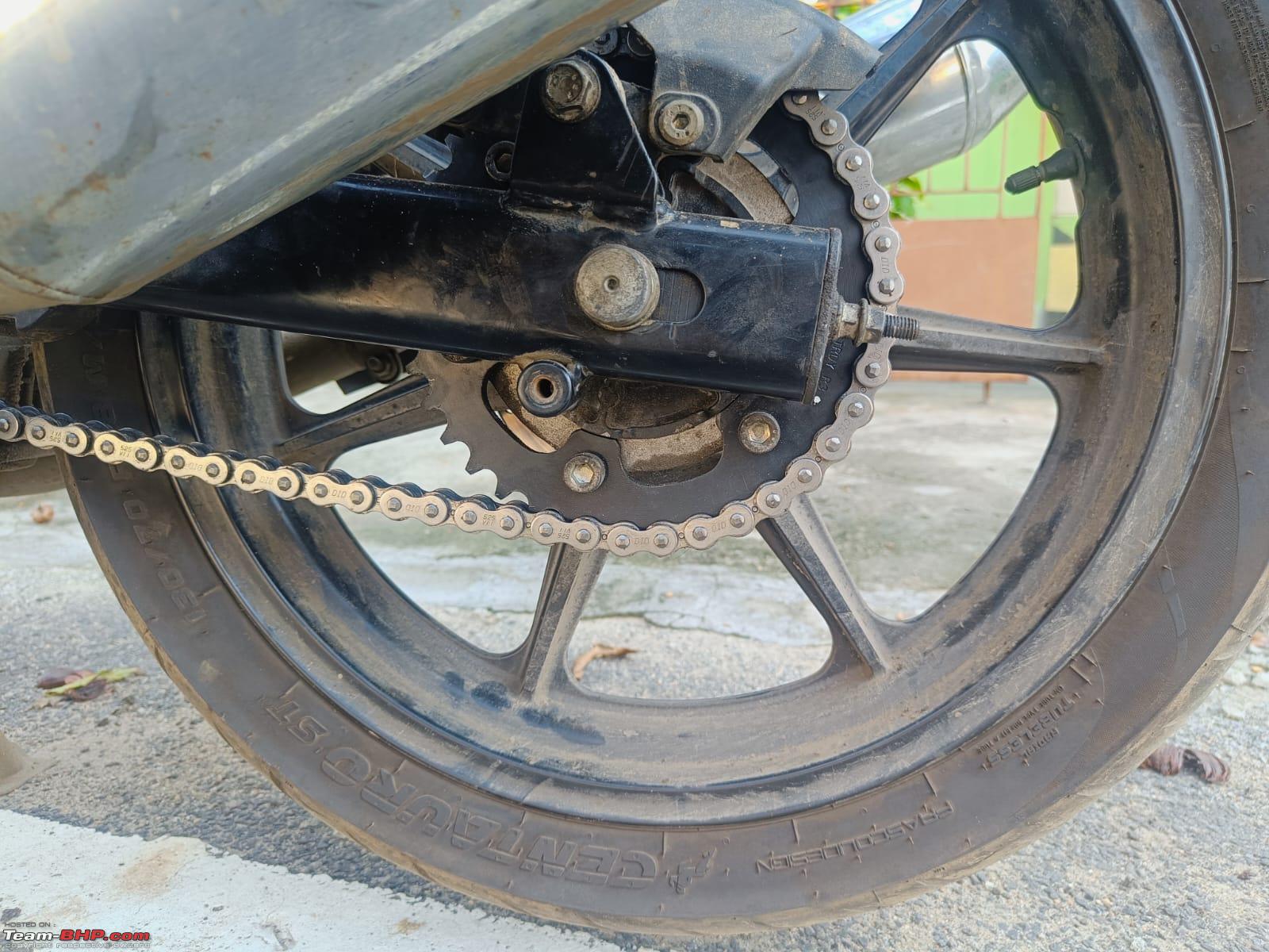

This is not an issue with the adjustment but is an issue with the actual chain.
I've faced this with my previous bike (Apache 200.
The tight spots on the chain are caused due to 'dead links'. These are jammed at a particular angle and do not move like they should. You can find these by parking the bike on the main stand and slowly rotating the rear wheel whilst checking movement between links.
The best solution is to get the entire chain out, soak it in a solvent (diesel), lube it and put it back.
I haven't tried this since I am apprehensive about tinkering about with the master link.
I focus my attention on these dead links, clean them with a bit more gusto and try to get them to move about a bit freely.
You also want to keep the slack on the higher side to account for the extra stiffness in the chain

Oh!! ASC does a fantastic job, I had tightened it last time & observing this issue, so it's mostly me & not the ASC
This cannot be done on CBR250R or Interceptor {R15, Ninjas etc} as they've endless chain unlike Rx or perhaps Apache, not sure. I think even Apache has endless chain. To change the chain, one has to remove the swing arm to change the chain for these motorcycles.
I'll keep you update, IF, I take it to ASC to fix this issue on both chain as well as gear slots

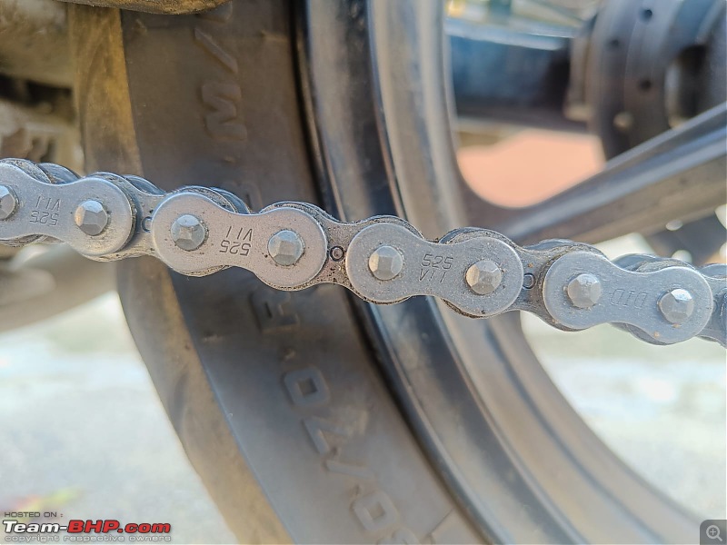

What you said is absolutely right! We had an upcoming ride to Coimbatore, so we went to ASC to check if everything is OK including the cables. Quite surprisingly ASC said the chain had dead links like you said exactly & said that was the reason for the gears getting struck. Although I was still skeptical, there was one sentence the ASC guy said that turned on my faith. He said the chain links are good for another 1000-2000 odd Km, just that it needs to be cleaned well & asked me not ride too fast {mind voice: then why did I buy this motorcycle, I could've bought TVS XL}. So he did what he had to & surprisingly we never encountered the gears getting struck through the ride
Dutifully, I came back & asked them to replace the chain & guess what, after that I've never experienced the gears getting struck. It was a shocking learner to me.

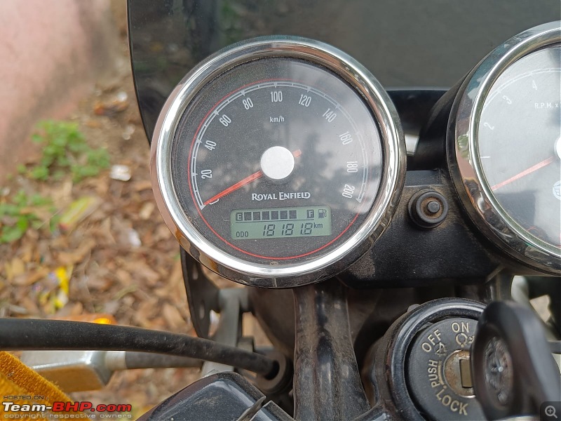

And then this happened
Intercepting the Drag to Downtown | My Royal Enfield Interceptor 650 Ownership Review-b1.jpeg

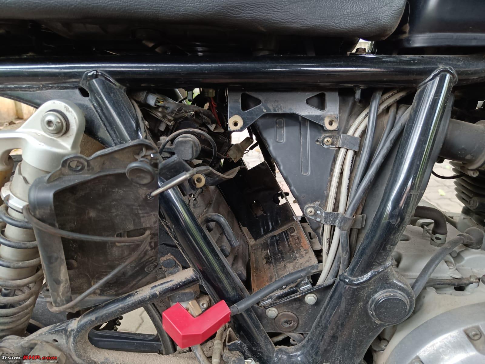

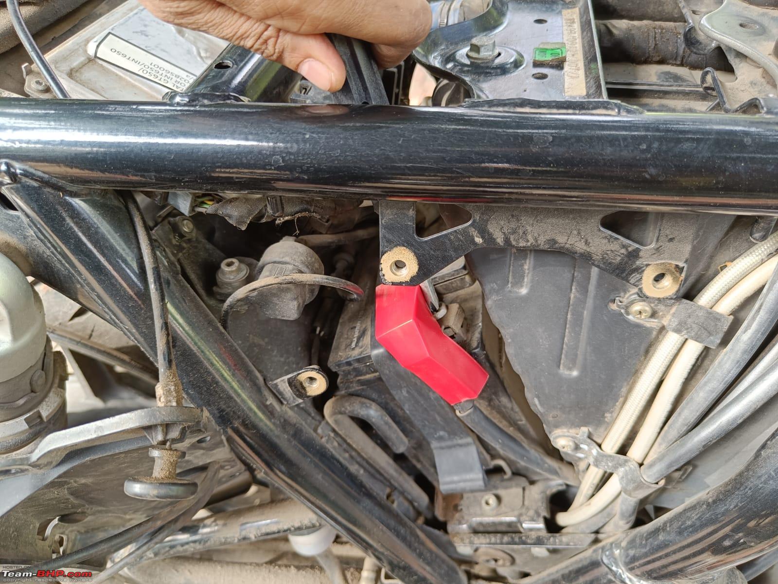

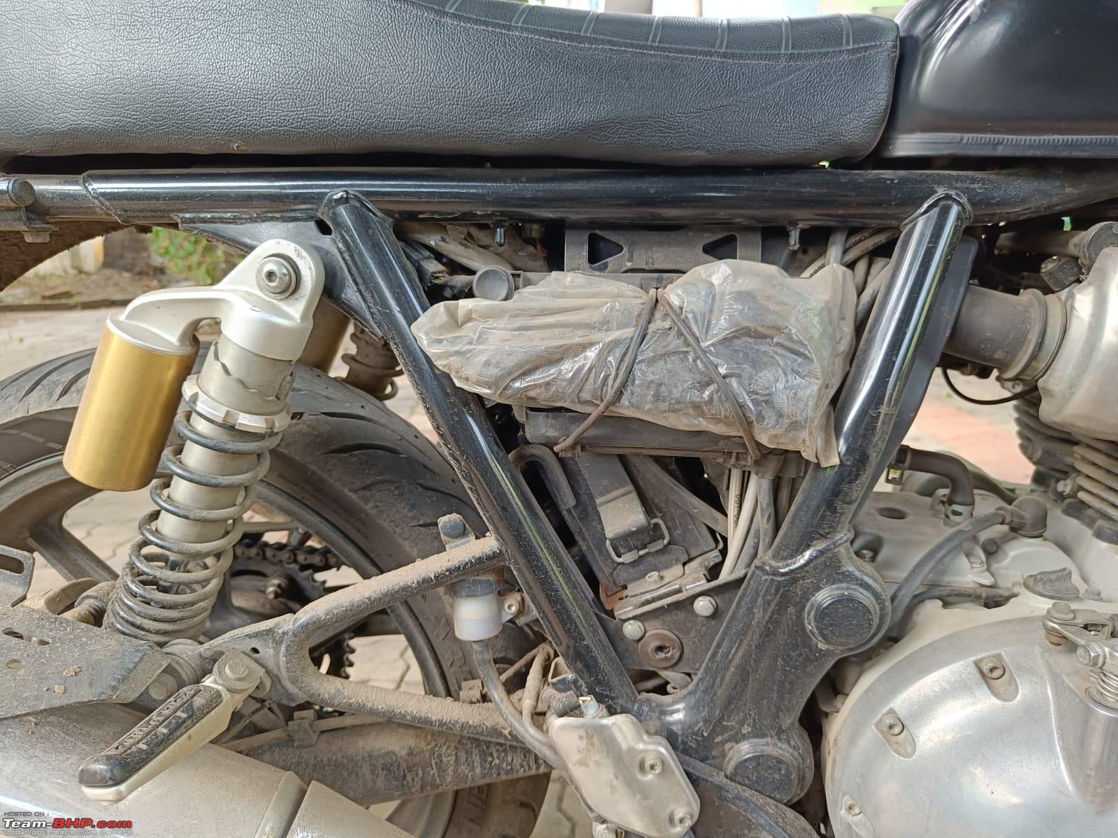

And then somewhere around 182xx, the battery gave up just like that; headlight turns on, neutral light, abs turns on, but doesn't crank; that signals for a new battery. OE battery lasted for 1024 days.
With help from YouTube, took about 2:28 hours to replace the old with a new battery
Remove the RHS side cover
Intercepting the Drag to Downtown | My Royal Enfield Interceptor 650 Ownership Review-b2.jpeg
Remove the toolkit
Intercepting the Drag to Downtown | My Royal Enfield Interceptor 650 Ownership Review-b3.jpeg
Remove the seat
Intercepting the Drag to Downtown | My Royal Enfield Interceptor 650 Ownership Review-b4.jpeg
Remove the toolkit holder
Intercepting the Drag to Downtown | My Royal Enfield Interceptor 650 Ownership Review-b5.jpeg

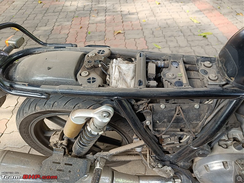

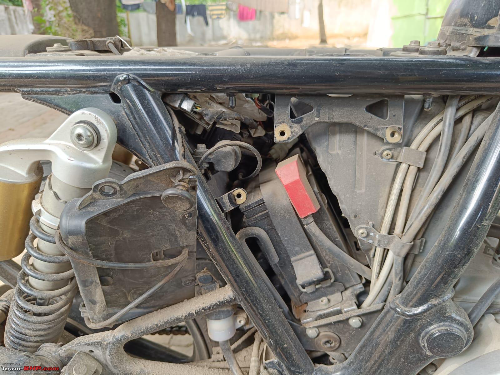

Remove the LHS side cover
Intercepting the Drag to Downtown | My Royal Enfield Interceptor 650 Ownership Review-b6.jpeg
Good opportunity to check if airfilter is clean or not
Intercepting the Drag to Downtown | My Royal Enfield Interceptor 650 Ownership Review-b7.jpeg
Remove the + terminal
Intercepting the Drag to Downtown | My Royal Enfield Interceptor 650 Ownership Review-b8.jpeg
Remove the - terminal followed by the connector
Intercepting the Drag to Downtown | My Royal Enfield Interceptor 650 Ownership Review-b15.jpeg

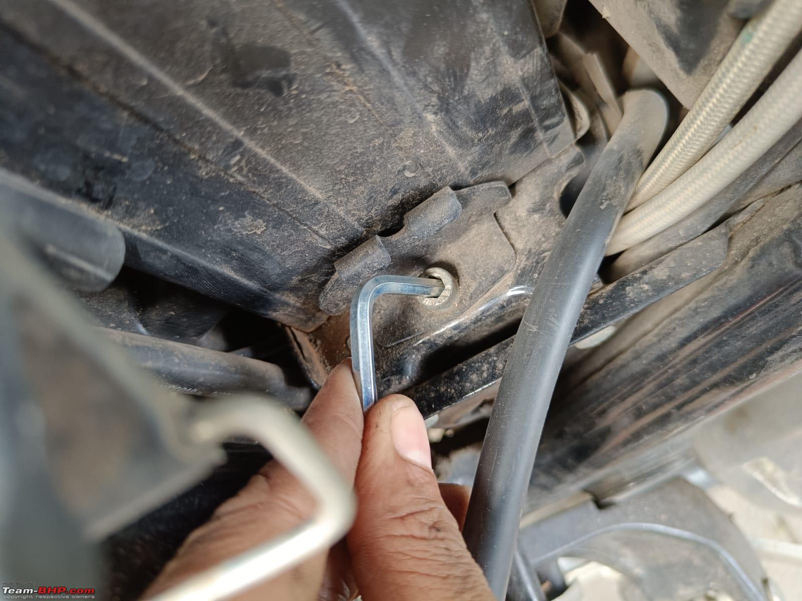

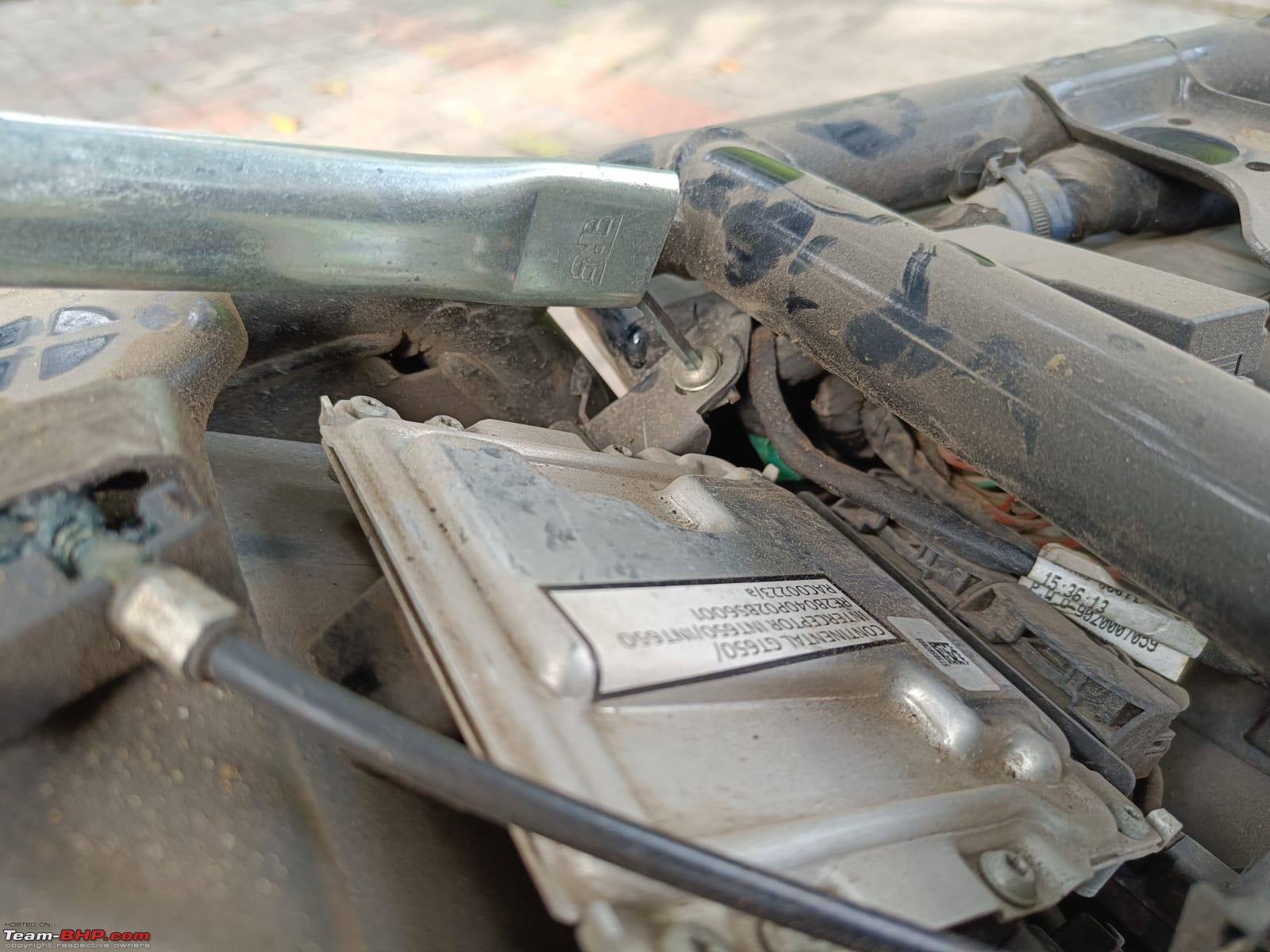

Remove the battery holder; the standard Allen key from the toolkit could not be used for removing
Intercepting the Drag to Downtown | My Royal Enfield Interceptor 650 Ownership Review-b9.jpeg
Thankfully, I've a bunch of them in different sizes
Intercepting the Drag to Downtown | My Royal Enfield Interceptor 650 Ownership Review-b10.jpeg

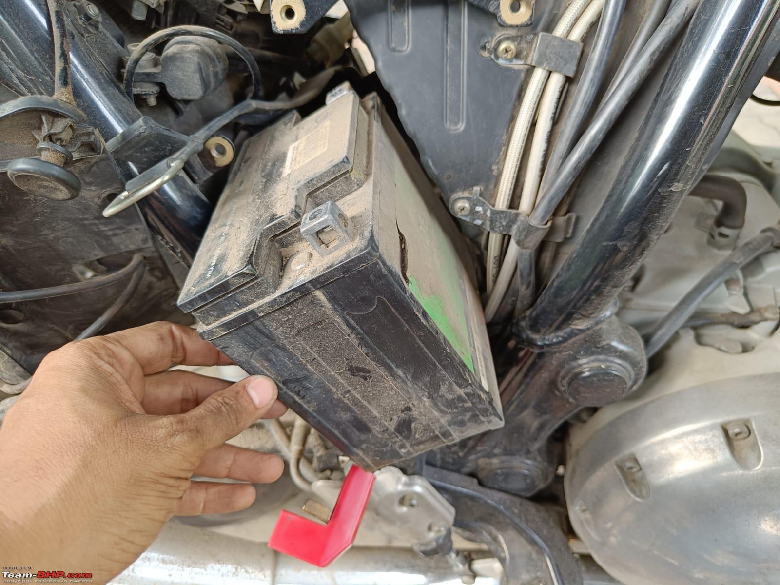

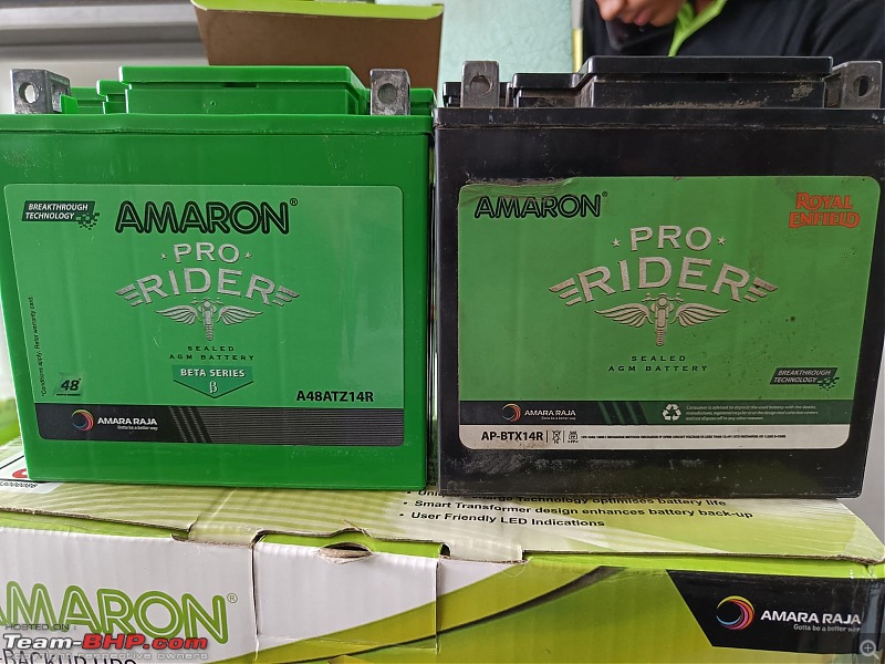

Remove the battery
Intercepting the Drag to Downtown | My Royal Enfield Interceptor 650 Ownership Review-b11.jpeg

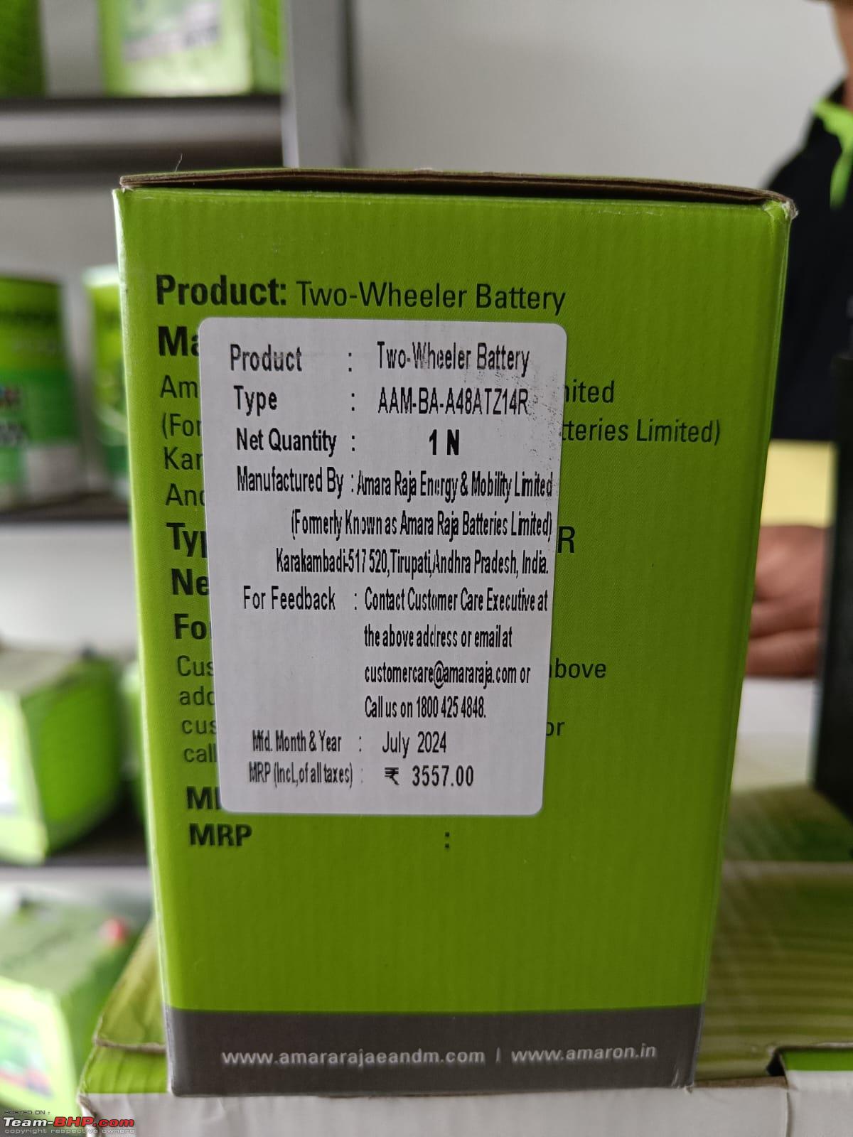

Notice the change in the model number; I was told AP-BTX is OE make while A48ATZ is the one available for public use
Intercepting the Drag to Downtown | My Royal Enfield Interceptor 650 Ownership Review-b12.jpeg
There's an interesting incident that happened & hence I took the picture of the MRP, which I shall detail in next post
Intercepting the Drag to Downtown | My Royal Enfield Interceptor 650 Ownership Review-b13.jpeg
Time to put the new one
Intercepting the Drag to Downtown | My Royal Enfield Interceptor 650 Ownership Review-b14.jpeg
Insert the battery, fix the battery holder, connect the + terminal, connect the - terminal & do not forget to connect the connector; fire the engine & voila its sheer brilliance!

Battery Hunt
Being a fan of Amaron & finding the OE was also from Amaron, it was no brainer.
Went to Amaron shop 1
Response was exceptional, he showed me this thing & said everything is the same. Cost was 3K & with exchange Rs 2700
Intercepting the Drag to Downtown | My Royal Enfield Interceptor 650 Ownership Review-bajranggbatteryandelectronicsdeokaliayodhyabatterydealersteslapowerusaceoevwyjwg1.jpg
Asked him why there's no Amaron for which he convincingly said this is the latest model & the green Amaron one's are not available. When asked whether he does not have or company does not ship, he said company ships the green ones only to ASC & he started lengthy stories which affirmed my suspicion that he's trying push what he has rather than give what I want. Looked into his eyes & gave him a metaphor of Exide IT 500 inverter battery versus the rest which should've given him that I'm a little informed customer. Now he changed the words saying the green Amaron ones are supplied directly to RE ASC rather than to dealers. Thanked him & said I'll check with ASC & get back to him
Now to Amaron shop 2
Response was good; he showed me what I wanted, price was 3600 & 3300 with exchange of old battery. I was OK with it. They didn't have computer bill & gave me manual bill which was fine by me. As he was preparing the bill, I asked him what's the difference between the Power Zone & Pro Rider, he said Power Zone is low cost model to face the competition; when asked why to launch a new product line while they could do with the existing product line, he gave some dumb answers. Attempting to find the answers myself, I saw the MRP which was 3557 & asked why he's charging me over the MRP. He immediately said, he can bring down the price to 3500-300 = 3200 which was fine by me. Later as I was leaving he asked for extra 50 & when I asked him the reason, he said it will make him happy. I smilingly said, he has made me happy by forgoing the 50 & walked away with the battery
I'm assuming the Power Zone thing is a little lower on quality compared to the Pro Rider series; I had a similar experience for my CBR in the past. I had to buy an Exide that was little lower on the cost post COVID time & that battery lasted precisely a day after the warranty period got over. I vowed not to touch such lower cost batteries again.
