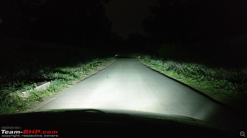

Sorry on going OT here. Here are the fog lamps on my Swift (They are Bi xenon projector - 35W & 4300K):
Car makers ditching the lower bumper front foglamps?-img_20170705_2217081024x576.jpg
I have aligned them lower than the headlight low beam cut off so the light is on the road than on the eyes of the oncoming users. It is aligned lower than Level 1 of the headlight.

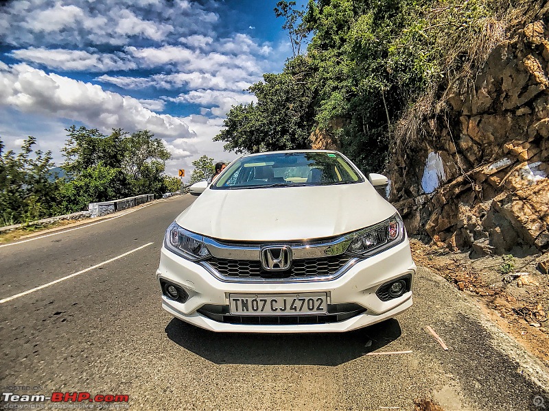

Same applies to the new Honda city. Though they provide LED headlights, they still provide extra LED fog lights since the headlights are again reflector based which may not give the coverage that the fog lamps will.
