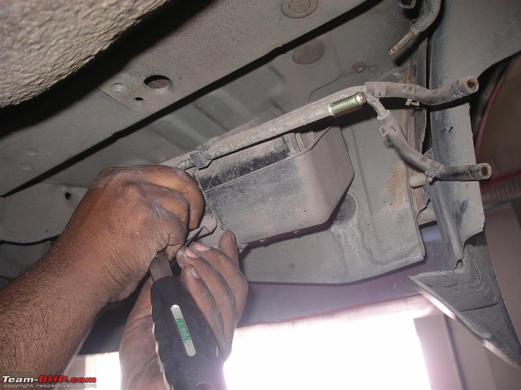

So this charcoal canister is part of the fuel supply path ?
If it is part of the path, then the petrol is going to go through the canister ( & hence the charcoal) each time you till fuel, and will get contaminated.
Originally Posted by 1self View Post
The system sits alongside the fuel tank, at the rear of the vehicle.
Does any one have a figure / diagram / pic of this set up ?

1self's Avatar
Posts: 629
Thanked: 335 Times
Re: Problem in filling petrol with "Auto Cutoff" feature
The first 2 pics are of my Sonata. I had the EVAP canister removed for blowing air. The last pic is a general diagram of the system. Please note that this is ONLY for PETROL vehicles. Diesel fuel does not need this system as it does not evaporate at room temperature.
