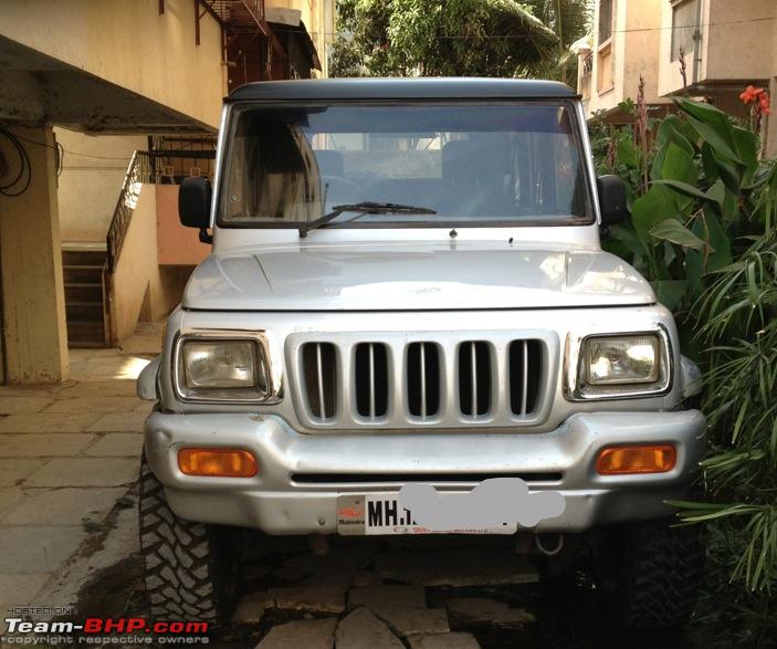

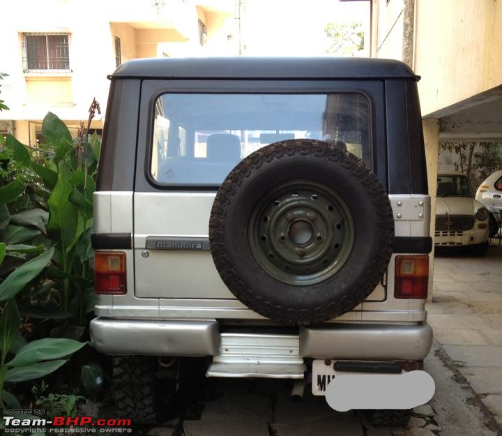

Hi,
This Bolero of mine was not having AC,PS.PW,Head rest,Rear foot rest,Bolero Type Rear bumber,Foot step,Door cladings or soft beige color on trims. I build it to SLX spec and was the first Bolero SLX with DI Turbo 4wd.Pics below.
Also in 2004 Bolero came with DI super engine with Rigid axle on the front.This was having seal inside the door pads as "Cheap Bolero"

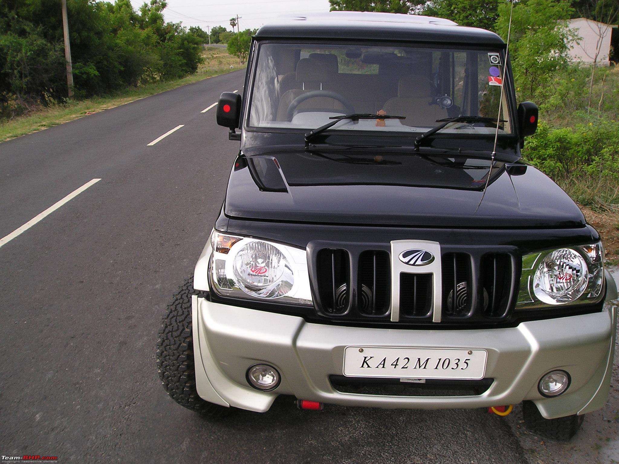

Your Bolero looks smashing from the front. Did you change the Had lights, bumper, grille etc also?

Hi,
If your asking me the question, answer is NO. I didnt change the front etc. This is a 2008 model from factory.
That would make it the DGSD rate contract/ be L1 in a tender/ stay as close to Marshall/ Commander budgets as possible.
Did you buy it from some government department?

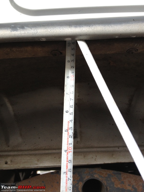

Hi guys,
The other day was checking for wheel travel, in fact should i say wheel drop when the body is lifted. I noticed that the OE shocks are too short restricting the wheel to drop by at least 1.5 inches. Which shock absorbers are longer than the bolero ones, was thinking of the tata 407 or tempo traveler ones. Posting some pics of the test.
Got the jeep lifted with a high lift jack
With the shock fixed.
Shock absorber disconnected.
