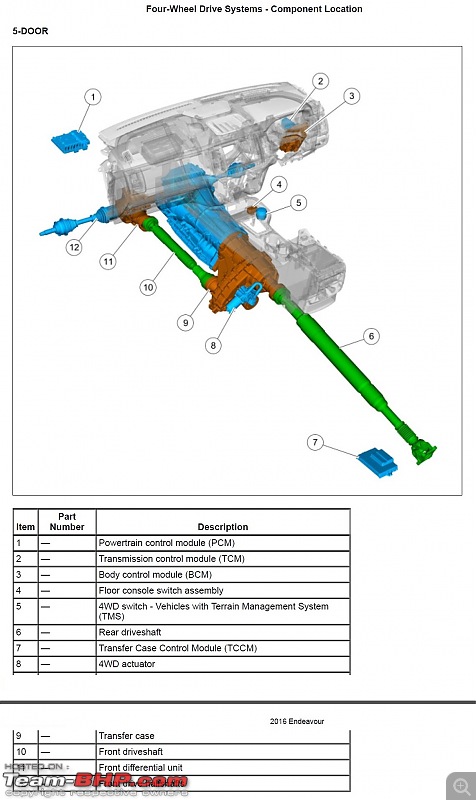

Transfer case:
A transfer case is a specialist component of the drivetrain of a 4WD vehicle and one of the most important components. The transfer case transfers power from the transmission to the front and rear axles by means of drive shafts / propeller shafts. It contains one or more sets of low range gears for off-road use often called as 4x4L or 4L. Low range gears allow the vehicle to drive at much slower speeds while still operating within the usable power band / RPM range of the engine. This also increases the torque available at the axles. Low-range gears are used for very inclement road conditions, towing a heavy load slowly, driving on tough terrains and extreme off-road manoeuvres such as rock crawling. This feature is often absent in AWD vehicles.
Source: Autodata Training

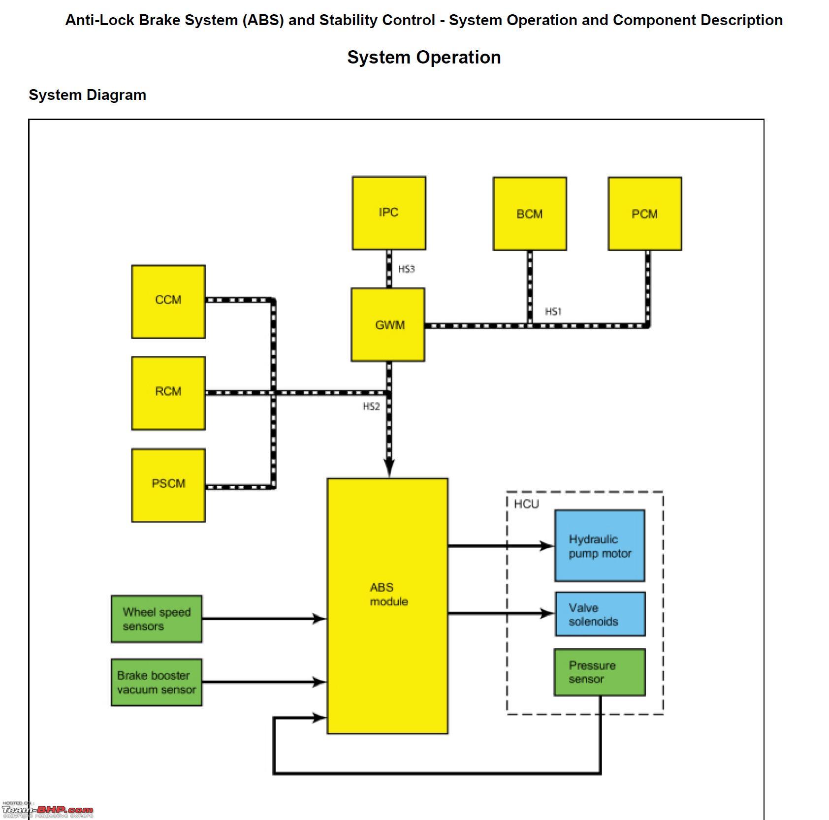

ABS:
Anti-Lock Braking System (ABS) prevents your wheels from locking when you have to brake suddenly. ABS electronically ‘pumps’ the brakes several times per second when sensors detect the wheels locking to modulate brake pressure. This is a very good safety feature and introduced in budgeted cars as well. From April 2019, ABS has been made mandatory on all cars and two wheelers above 125cc sold in India.

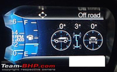

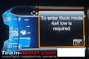

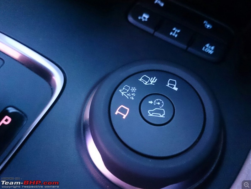

Terrain Management system:
Terrain management system is an electronic system that adjusts engine torque, traction control, all wheel drive system, and other settings to provide better off-road performance on a particular surface (gravel, mud, snow, sand).
Land Rover introduced a Terrain Response system on its Discovery in 2005. Later this technology was borrowed by Ford and by other manufacturers.
The Ford Endeavour’s Terrain Management System offers four driving modes designed to enhance the vehicle’s capability in differing types of terrain types. These modes are Normal, Snow/Mud/Grass, Sand, and Rock. In addition the Endeavour has low range gearing, and the TMS incorporates a Hill Descent Control function.
Power distribution. Gives a faint idea when the vehicle is moving.
4WD system of the Endeavour

Q4) How do the electronics in my Endeavour regulate the ABS,ESC, SC etc?
A4) The ABS module is the main module that governs traction control, ABS, EBD, Brake Assist etc. The ABS module receives info from various other modules and sensors. Eg. yaw rate sensor, lateral accelerometer, longitudinal accelerometer and roll rate sensor. Wheel speed information is received by the ABS module using 4 wheel speed sensors.

A6) As mentioned earlier 4L can only be engaged in NORMAL and ROCK mode. For tricky offroad terrains, slopes, steep descents, water crossings you must engage 4L. In 4L, the traction control switches off automatically. But which one? That’s the Engine Traction Control, the Brake Traction Control still remains effective.
Q7) When should I engage ROCK mode?
A7) ROCK mode can only be engaged once you engage 4L. ROCK mode is for slow speed crawling on rocks, difficult inclines on dirt tracks etc. It should not be used on wet surfaces like soft mud etc., as the vehicle will dig in further. When you engage ROCK mode, Traction control is automatically shifted off by the ECU. On the other hand, the transmission is locked in 1st gear, unless you manually use Sports mode and change to 2nd, which you may mostly never need.
Name:  4x4 l req.jpg

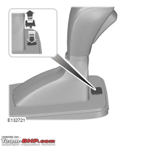

A29) With ignition off, apply the parking brake fully. Lift up the cover in the center console next to the transmission selector lever with a suitable tool. Push down the locking button in the slot and simultaneously move the selector lever out of park (P) and into another gear.
Name:  P to N.jpg
Source: Ford Owner's manual.
