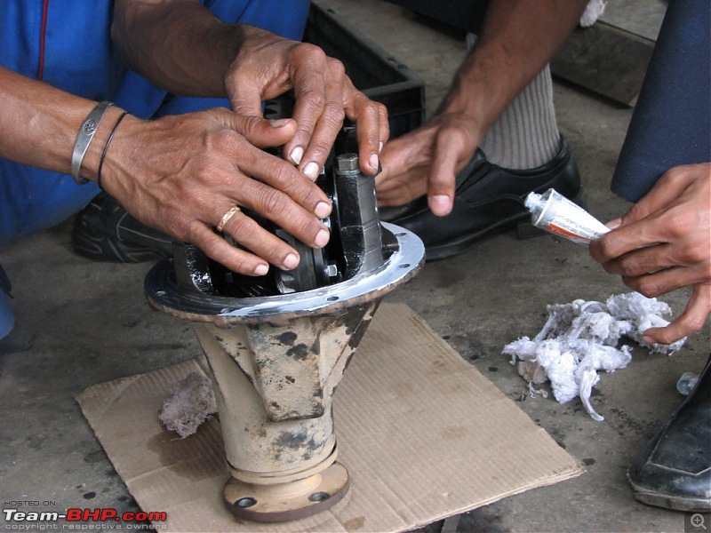

The diff ready to be put in the housing, so the liquid gasket being applied to both the diff and the housing

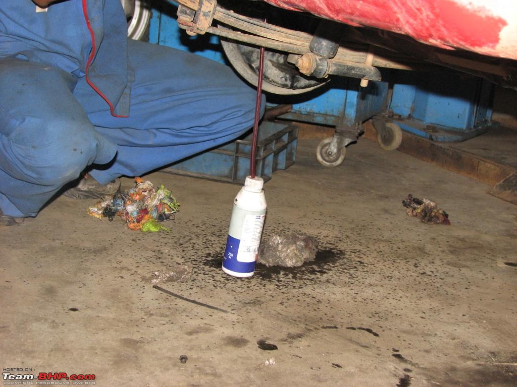

The brakes being bleeded
