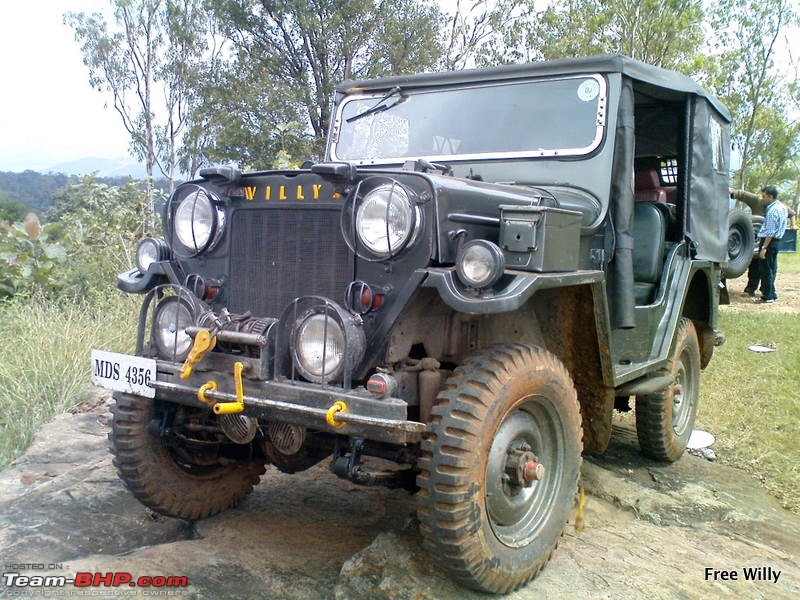

See the attached pics:
Option 1 - betrween the headlights - most preferred

The current fogs have been removed since there is a rhino hook behind the right fog and interferes during towing.
The other pic i have attached is something i liked and wish to copy.
6. How to mount? 99% of the Jeeps i have seen have their fogs vibrating / rattling / pointing towards the moon / etc. What is the best strategy to mount and on what?
If mounting them on the fender, I would recommend building a cage for them, such that small rocks and the like dont hit and break the glass. You will also have to build a fog housing and bolt that housing on a metal clamp affixed onto the front fender. The housing will be bolted onto the flat clamp on the fender unlike a small wedgy clamp which is what most regular fogs are fitted with.
in this position light will reflect from jeeps hood & will not help as desired (my opinion )

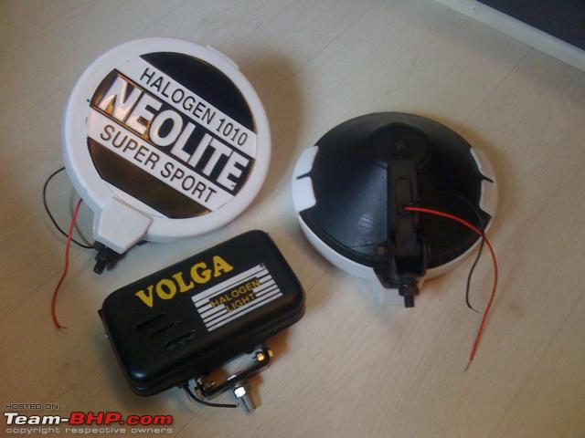

I had lights positioned exactly as he did. (See the first pic). However, that interferes with the standard rhino hook that is attached on the classic. The first time my car needed to be towed, the fog light got damaged.
I bought a set of Neolites from Opera House for 900 bucks and one single Volga one for the rear for 130 bucks.
I was earlier considering Rallye or Hella, but i didn't want to spend 7000+ on lights. If they get damaged, i won't feel too bad.
As for the brackets, i have a design in mind. I'll go to my local welder and get brackets made first to see how it can be mounted between the headlamps.

Where did you get these lights from at Opera House? Im going there tomorrow for the very same purpose and to get myself a Hazard switch, the kind that has the blinking lamp built in as part of the switch. Press the red part (soft transparent rubber/silicone) and it comes on. I think Premier Padmini Deluxe (floor shift) cars used to be equipped with that kind of switch.

Got them from the same lane as atlas motors. his shop has all car tail lights displayed. don't remember his name. Even getting a jumper cable specially made for Rs.668.

Tejas, The lights youve bought wont give much light!! I have experience with these aux/fog lights. The neolite that you bought will give exactly 1/3 the light a similar hella/cibie would give. Also from my rally experience, I think aux lights need to be spot lights, since you need them on the vehicle route/line and not at the surroundings to save a lets say an animalcoming onto your car[thats not the speeds you do in otr]
True. But i need a spread out beam for the OTR. Also i'm replacing the 55W bulbs with 100W.
And frankly, i wanted this as a trial. If i am not satisfied, then i just loose 900 bucks and not more. My main issue is that they need to withstand abuse and water.

Take some fevibond (rubber based adhesive not superglue) and make a layer around the reflector and casing to make it water tight take care of the wiring routing points, to make em water proof.
