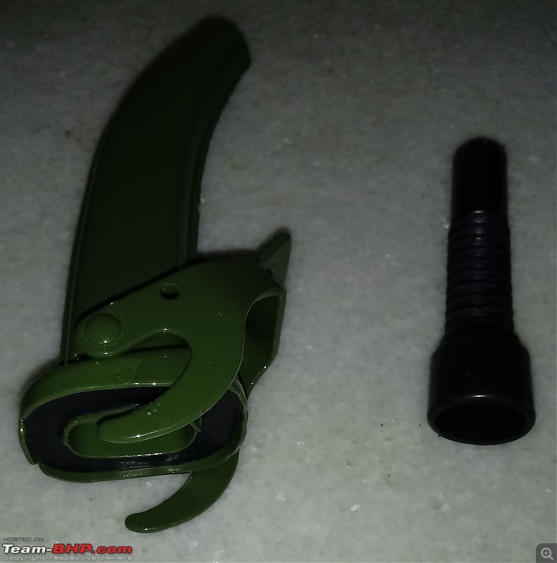

Chanced upon this thread while going through old TBHP topics.
Let me add my experience, even though you all might have sorted out the issues by now -- I have been carrying 20 lts of petrol always in my Nissan Jonga, in an army surplus metal jerrycan, as the vehicle is a 'gas-guzzler' with an inaccurate fuel meter. The jerrycan simply lies on its side at the back, and is routinely used as a footstool by back passengers sitting on the bench seats. Sometimes it is buried under mounds of luggage. In emergency situations it has even been used as an extra seat, with a thick cloth or rubber mat on top. It has never leaked (not supposed to, by design) and so no fumes were ever produced. It is always left inside, even if the vehicle is out in the hot midsummer sun, and has not ever bulged.
Many a times I think of fashioning a retaining strap (out of old bicycle tube) to keep it upright and secured to the low wall/partition between the front and back (the Gypsy does not have this partition though there is a height difference between the two compartments), but have been too lethargic to do so !
In its present condition the can does go 'bump' when going over speedbreakers or on rough roads, and the moving around does rub some paint off, but that is all.
The whole point is -- army style jerrycans are absolutely safe, leakage or fumes wise, to carry inside. If your back door, rear bumper, or roofrack can carry them without worry for theft or weight disbalance, it may be better in some ways.
I feel the new age plastic cans will be just as secure. Some flat ones claim to be as strong as to be used as sand ladders for recovery !
