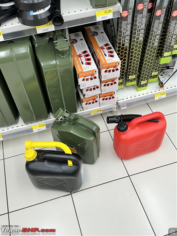

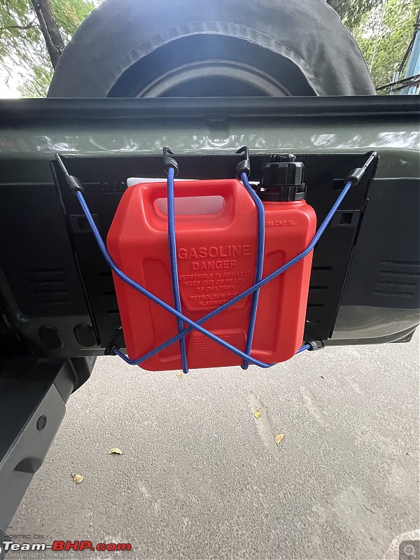

I have bought this 5 litre Jerry can and mounted it on the inside tailgate of my Thar. This is purely for emergencies. It is always empty and will be filled only if I am sure Im going somewhere where I will have challenges in easily finding petrol.
It is of good quality and available at Rs 1799 on Amazon. Comes with its own nozzle and filler tube.
Similar ones are available in UAE at Carrefour in the car accessories section and at ACE Hardware too and cost about 45 AED to around 100 AED. I have seen a number of Jeeps and off road vehicles fitted with these but of a bigger size.
