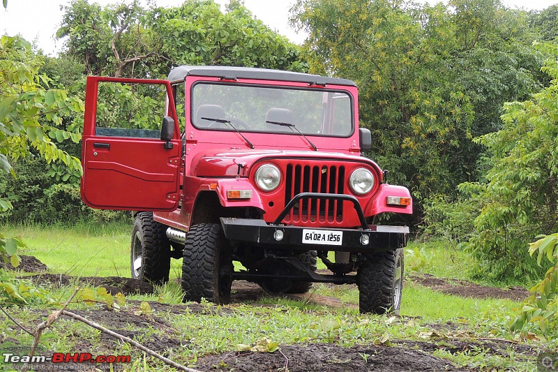

A day out on a bright green hillside.
My MM540 4X4 Build: new shell, SOA, PS etc-dscn1146.jpg
My MM540 4X4 Build: new shell, SOA, PS etc-dscn1162.jpg
My MM540 4X4 Build: new shell, SOA, PS etc-screenshot-20140911-110346.jpg
4x4Roadie is offline   (2) Thanks
