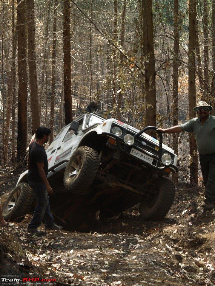

Last year was pretty dull for me, due to various unavoidable things at work blah blah blah etc. Spidey was being used occasionally, mostly in some local small events or doing some recce etc. Finally the annual otr stuff started and was kinda happy to bring him out.
First attempt was a swamp and i royally got stuck.
And when he is stuck, its stuck for good! It took a while to recover and in the process realized that rear tow hook is needed badly. Was using the chassis to tie the tow rope, works well but takes out the rear bumper and tail lights in the process.
Soon got the hang of it and started fooling around. Found a good climb and it was time to show off. First tried crawling which obviously did not work and then...
Managed to climb but rear landed up on a tree and ouch!
Tail gate was displaced and torn at the upper hinge, luckily it did not swing open. So carried on for the day. And did this...
Something was amiss and i was getting khat khat sound from transmission just like when mounts are cut, while in low ratio. After this day it started coming in normal 2 Wheel drive also, under acceleration.
Back again to Suraksha with a long list including, fixing tail gate damage, tow hook which will fit D shackle for tow rope. Transmission sound - 1) The yokes were tightened by some heating or something? and 2) Bent gear box stay was replaced. Apparently this was bent earlier and repaired once.

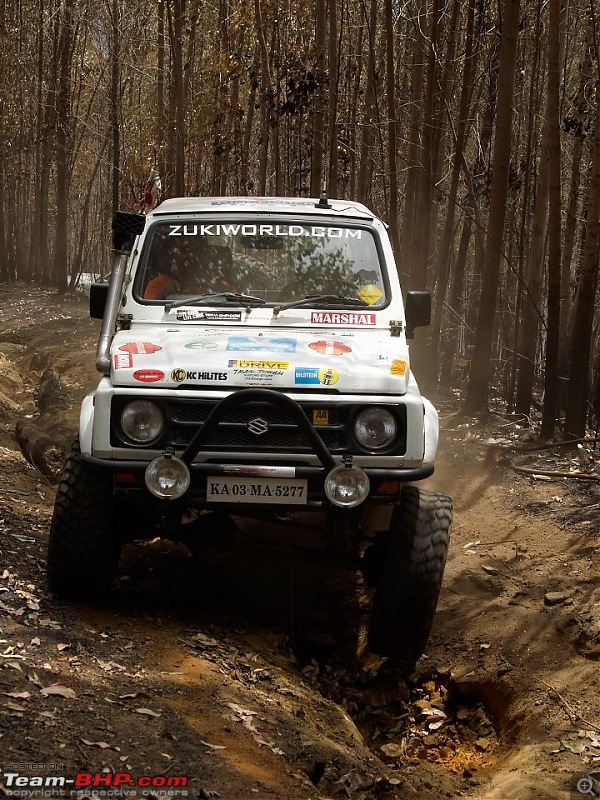

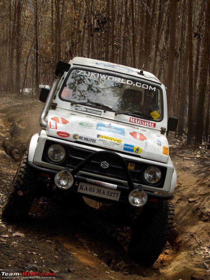

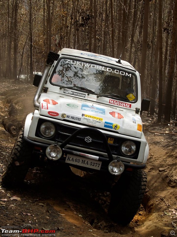

Easter weekend, too boring to be in BLR, Its hot too! Lets drive to Kerala... and so it was! A weekend off, with family and some close friends, boy it was a weekend well spend!
Started off with boulders, followed by rock climbing, rut conquering, more boulders, crossing barely existing bridges and finally clearing off fallen trees! Just few pics to share.
No animals were injured or vehicles towed back. So its both environment and offroad friendly.
Anyone has idea if the gypsy lighting circuit alone can be replaced? Giving few issues at the rear end, so thought of changing the whole thing since its about 10 years old.

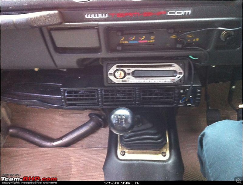

All parts + fitment charge came to 24,000/- the insulation material was additional which came to around 160/sq feet IIRC. I paid them (the installation boys) a tip of 500/-
Hi,
Can you share the details of this blower ? I am planning for an AC in my jeep this blower looks good and I think it can be fit in My Jeep CJ7 type dash.
