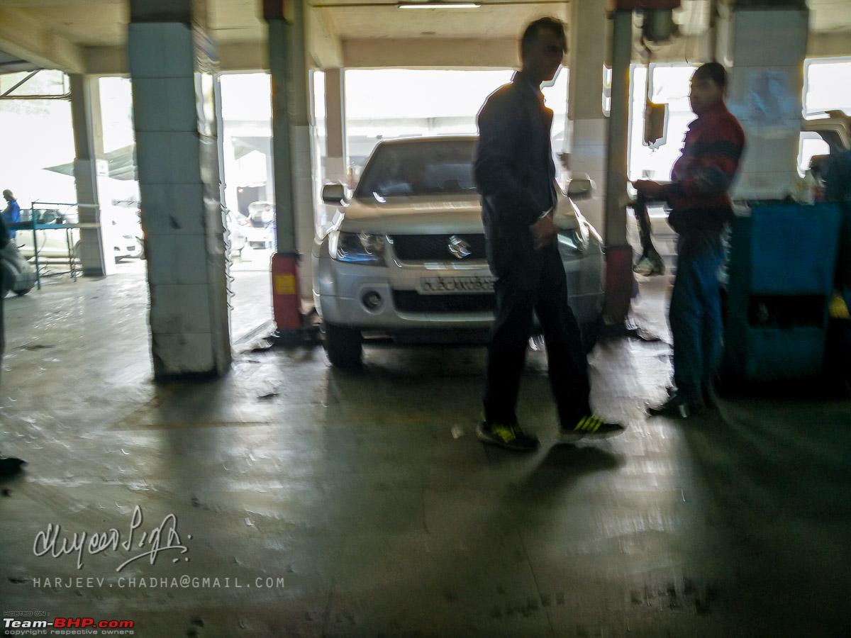

As I'd mentioned in yesterday's post that I was off to the workshop for getting some work done.
Reached the wokshop at 10AM sharp and work was started immediately and by 1140AM the vehicle was ready. I was myself surprised that so much work was done and such a little span of time. No complaints here.

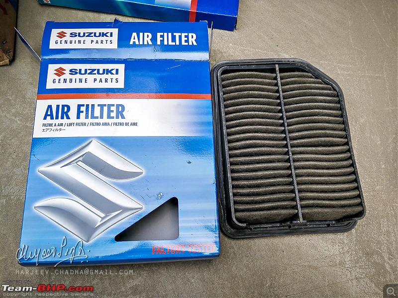

  • Both the filters were in a very pathetic condition. Look at the pictures enclosed below.

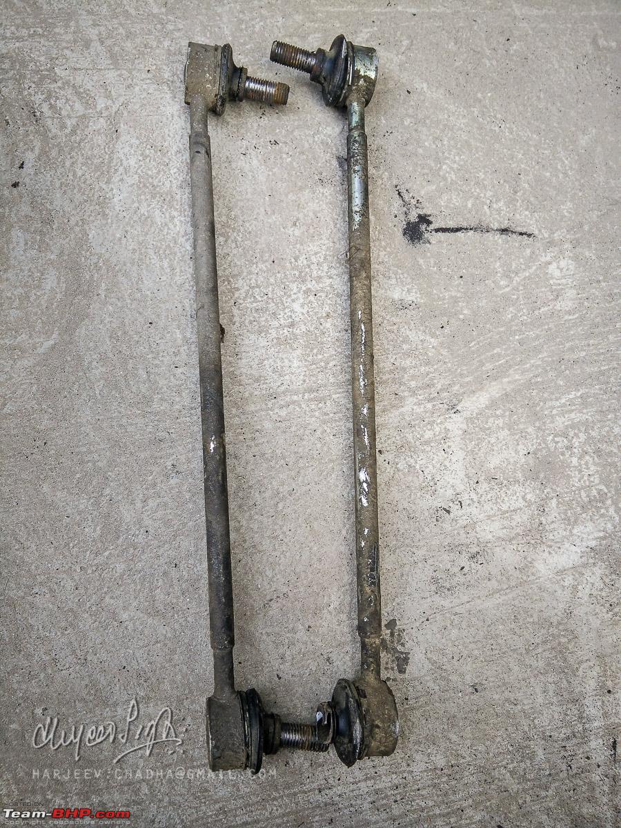

  • So were the condition of the Idler Pulley and the Tensioner Bearing Assy.

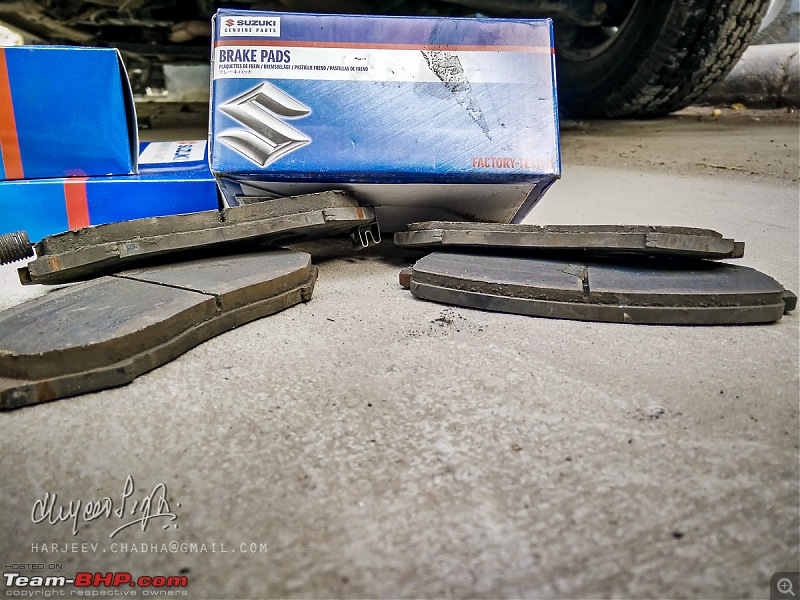

  • Brake Pads were also changed. One surprising thing was the brake pads had an uneven wear. Out of the four pad, two had much more life than the other two. Now I don't know whether in the past only two were changes or there is any issue with the brakes. Anyways, will check after 10K kms and take a call. At the moment, the breaking is perfect and there's no pulling either side while breaking.

Link Rod Replacement
The Red Devil makes way for the Silver Fox - My 2008 Suzuki Grand Vitara-link-rod-img_20160124_102612.jpg
Link Rods OLD
The Red Devil makes way for the Silver Fox - My 2008 Suzuki Grand Vitara-link-rod-img_20160125_112326.jpg
New Brake Pads Mounted
The Red Devil makes way for the Silver Fox - My 2008 Suzuki Grand Vitara-brake-pad-img_20160124_102623.jpg
Brake Pads OLD (Look at the uneven wear)
The Red Devil makes way for the Silver Fox - My 2008 Suzuki Grand Vitara-brake-pad-img_20160125_111942.jpg
