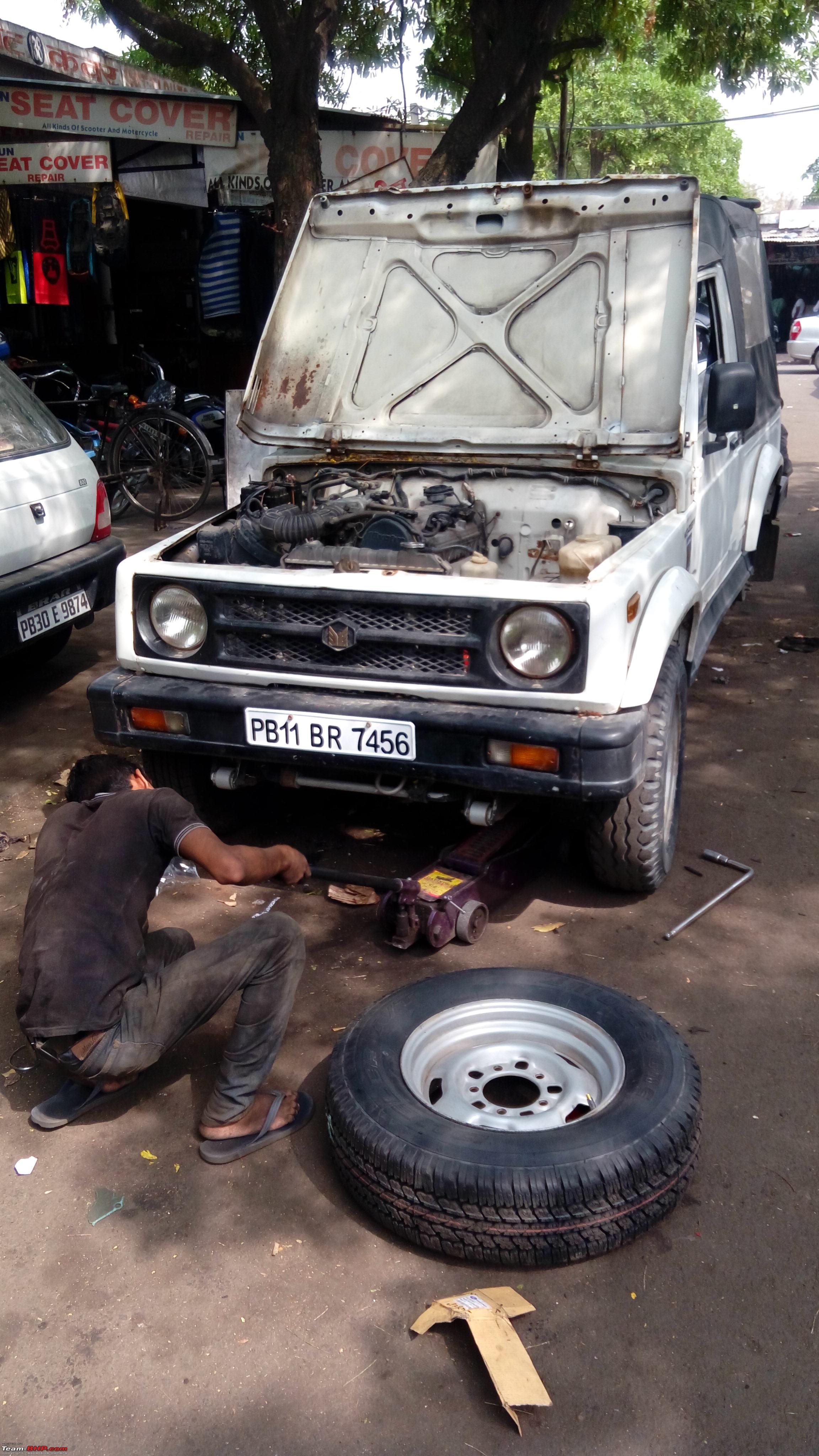

New shoes coming in. Bridgestone dueler 215/75/R15. The old ones were all cracked up except one which had sufficient tread depth to qualify as a spare. 6k saved there

Getting a good service. All oils were changed and the bearings were also checked. No problems there
