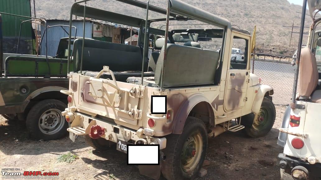

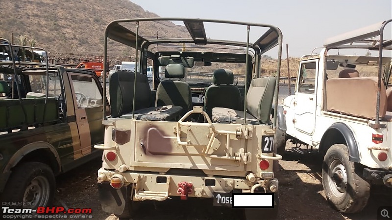

Some pictured of the Cream one:
I however wanted a second opinion on the vehicles. So, after a quick souple of calls, found out a that friend of my brother-in-law, Mahesh, resides in Pune and has good contacts too. The only caveat was Mahesh couldn't go to the dealer's yard until the next day as he was busy with some of his commitments. I then called the dealer back and said I would pay an advance right away but would need both Jeeps to be blocked for me until Mahesh would go there the next day and take a call. With another condition that the advance would be returned if we didn't like either of them. The dealer was fine with this and I transferred to his account, a token advance. Another couple of calls to finalise on the next day's action plan and couldn't sleep that night due to the excitement

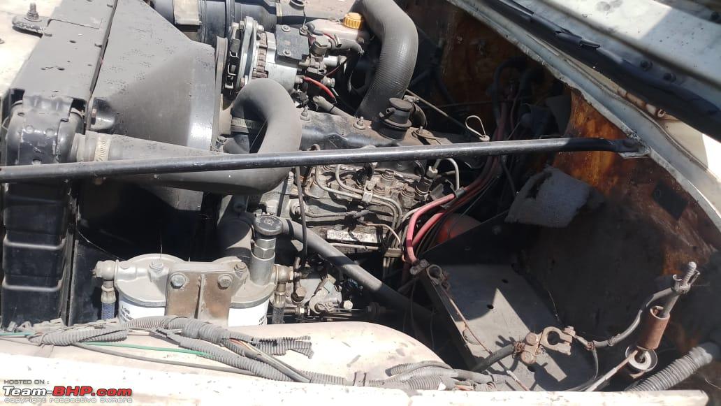

I was about to call it a day and go back better prepared the next day. That's when I realised, there were so many trucks in the yard and there was a chance that one of them would have a Jump start cable. Asking around, I found that there was a resident Mech/Electrician in the yard itself and he agreed to help. He got a jumbo battery and jump started the vehicle and also put a wire straight from the battery to the Headlights for them to work!

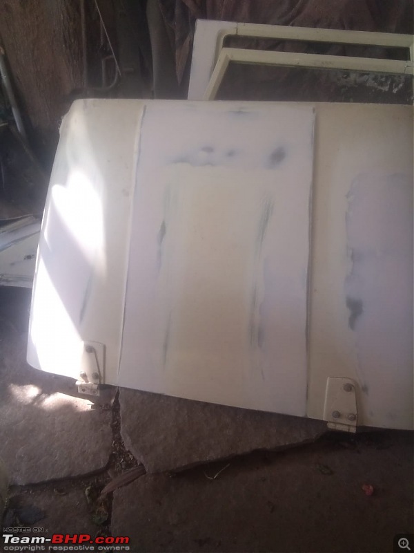

The mech had a couple of vehicles on his plate and I had to wait for a couple of weeks before he could start working on my Jeep. I had no choice but to wait. I would call him every couple of days to remind him. IIRC, somewhere in the middle of April he started to work on my Jeep.
Below are some Work-In-Progress pictures. Apologies for the quality of images. All of them are shot from mobile and some from my mech's mobile
Work starts

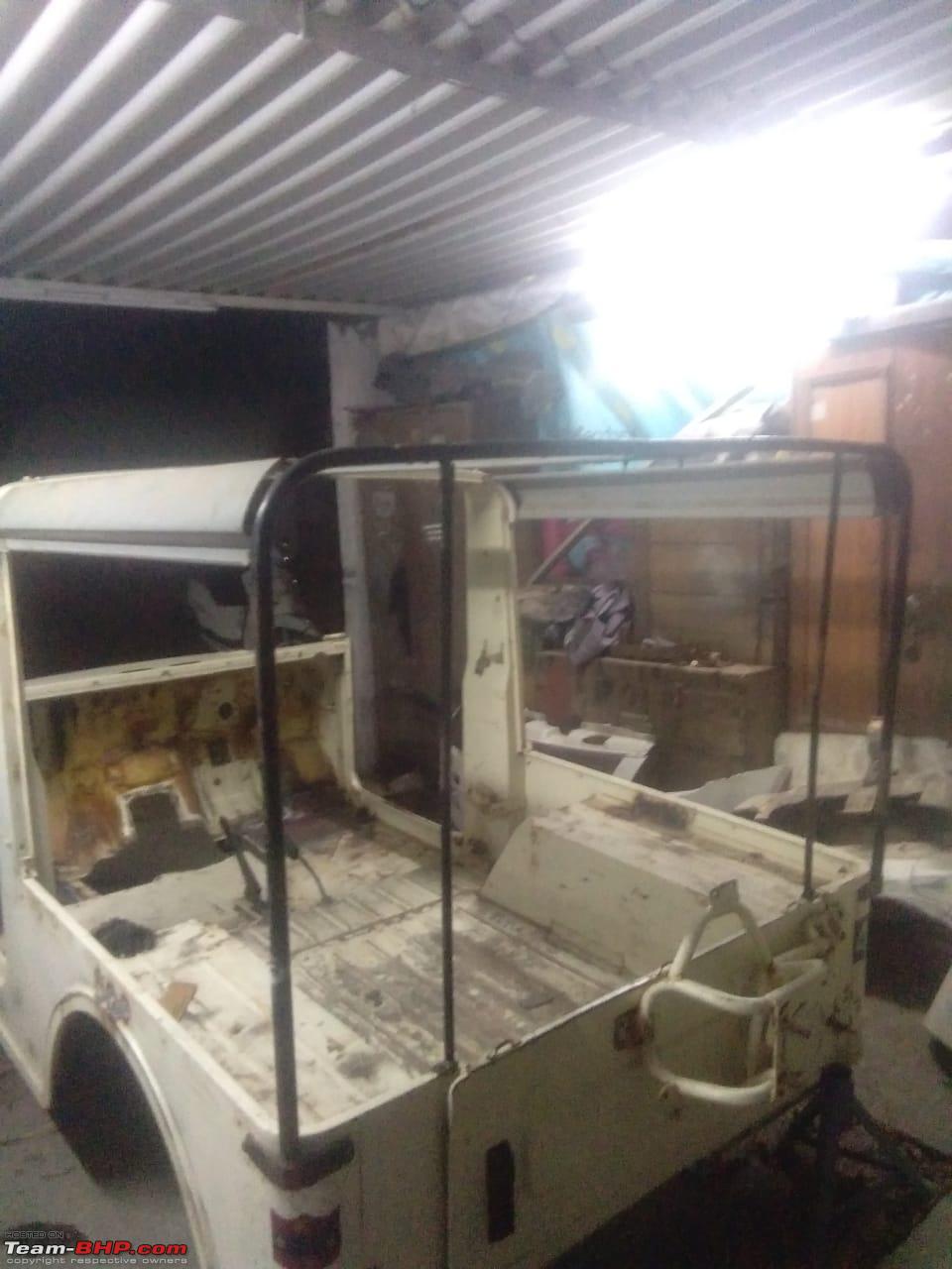

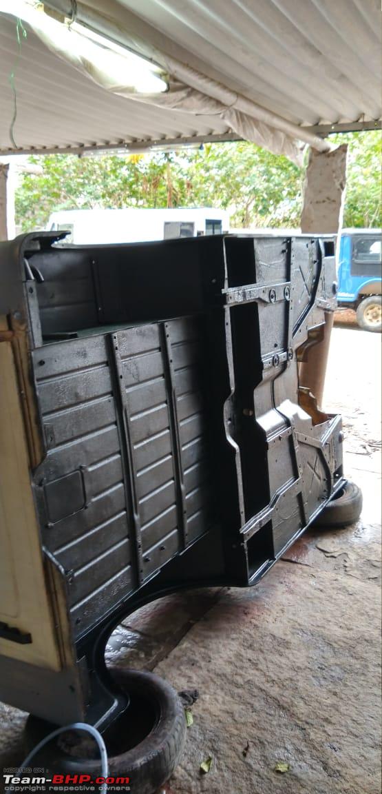

Although the body tub was in a good condition, I didn't want to take chances and wanted to ensure that the chassis is also in a good condition. Hence asked my mech to take it down.
The body Tub
The Chassis - No dents/bends/welds
An 8-year dream realised! My ex-army Mahindra MM550 NGCS-10.mount-replaced.jpg
Except for this mount that was rusting; Replaced!

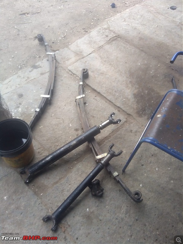

An 8-year dream realised! My ex-army Mahindra MM550 NGCS-11.-leafs-shafts.jpg

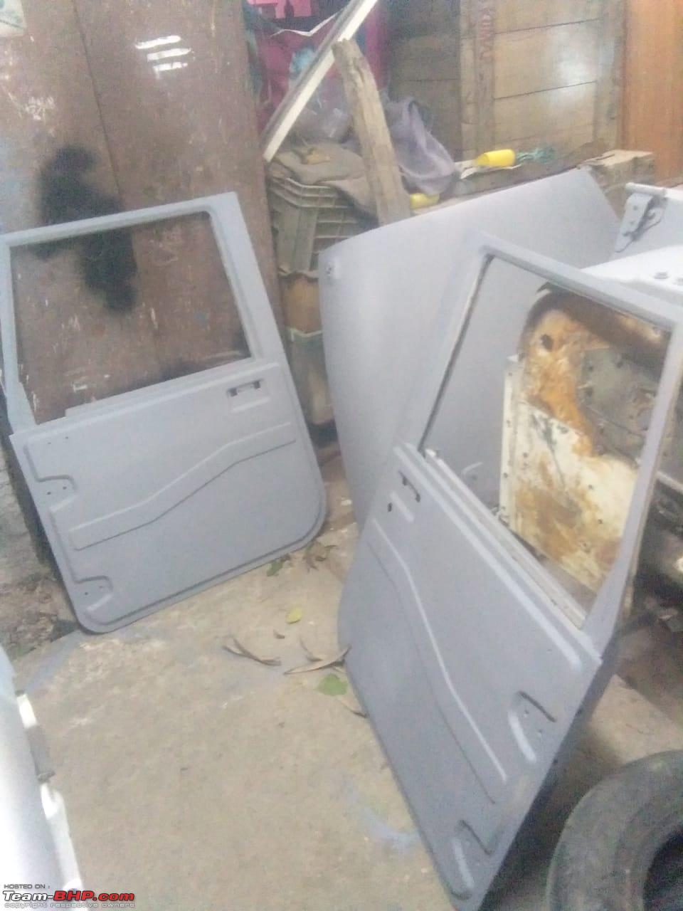

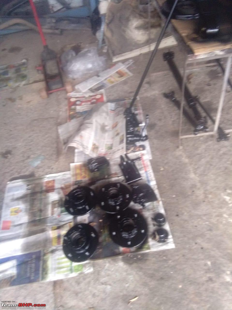

I wanted all the under-carriage parts to be sanded (although lightly) and painted again. Some pictures of the process.

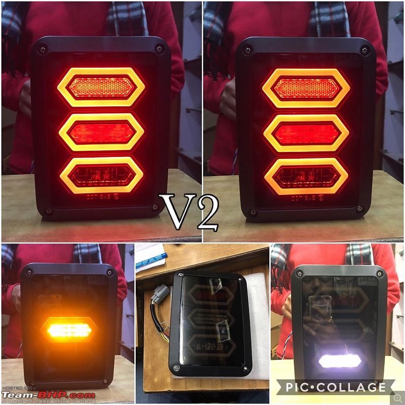

There are about 8 varieties of wrangler LED tail-lights at prices ranging from Rs.1600 to Rs.7000 and this is what I liked the most
Realised that they weren't a direct fit after they were delivered. I had two options, to cut the body and then fit it or to make a frame to mount it on, and chose the latter.

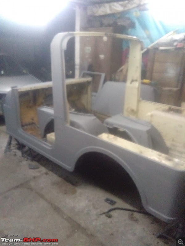

An 8-year dream realised! My ex-army Mahindra MM550 NGCS-38-chassis-ready.jpeg
Meanwhile the chassis was ready to meet the body

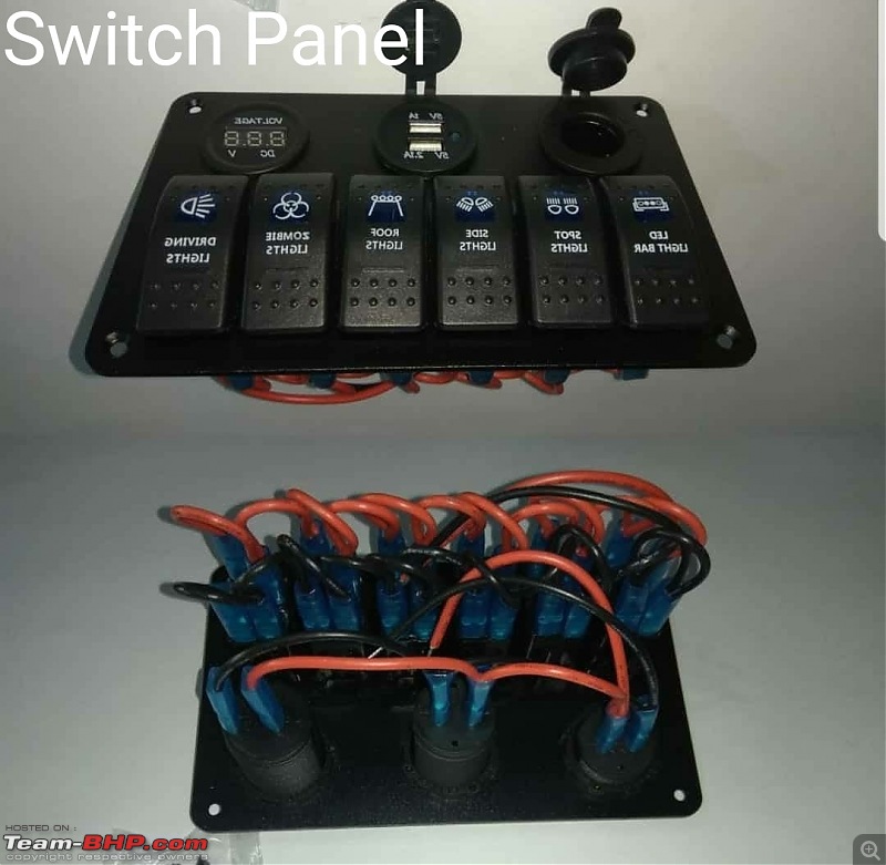

The switch panel: We improvised a bit here. The dashboard didn't have enough space for the switch panel to be fit as one piece. We hence split it into half and put it in two places. The socket's and voltmeter went under the gauges. The switches came to the right where it's very ergonomic.
