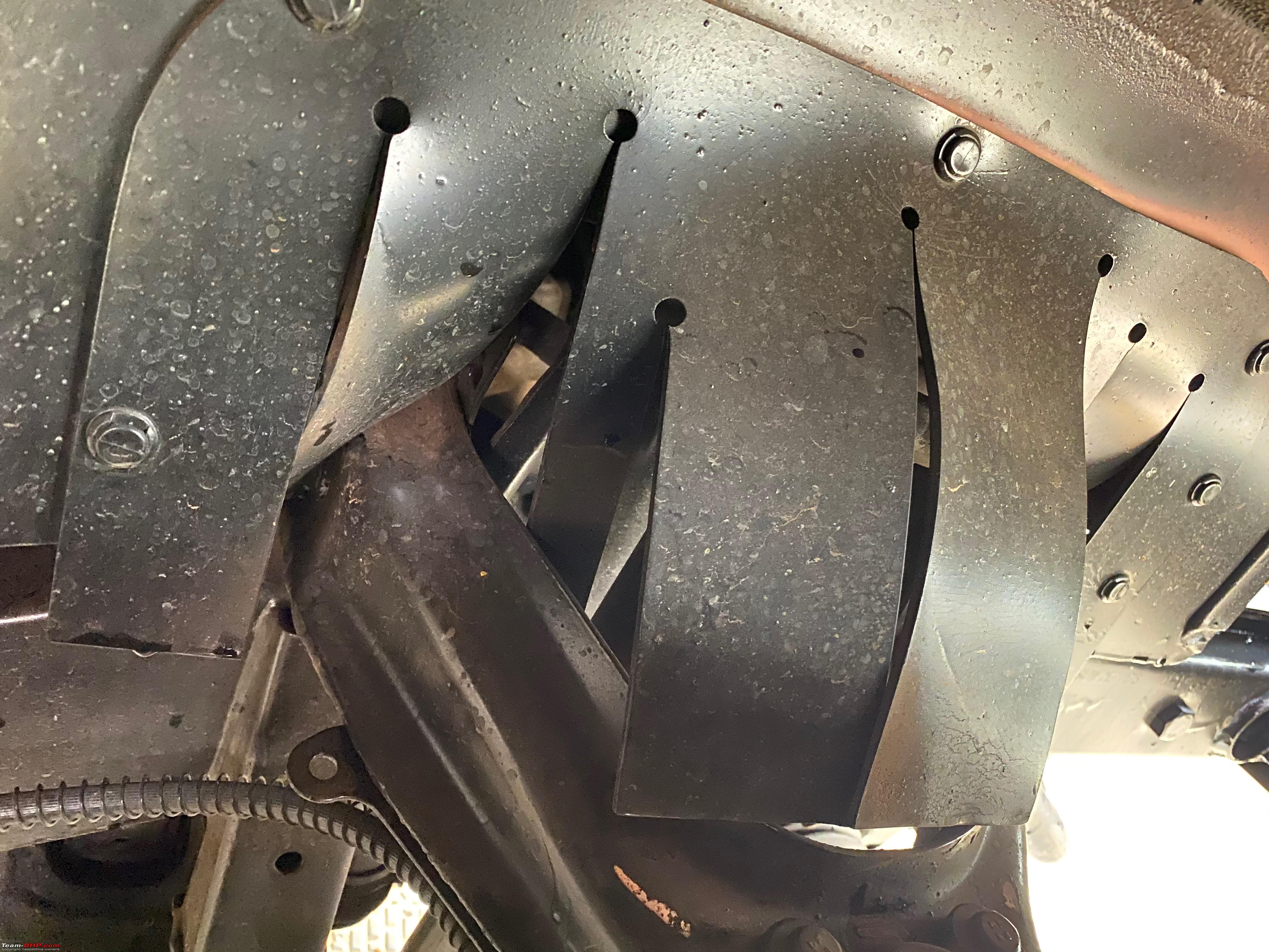

Now, I do have a question, I hope you could help. A friend was looking into getting a Thar for some time now. And we happened to look into a specific 2015 model Thar CRDE 4x4 model. It was not stock, had custom wheels with upsized beefy A/T tires on them. The car in itself was in good shape, clean and properly coated underbody and exhaust, smooth engine (cold start and progressive revs, did not drive the car), did a head to toe visual inspection ourselves but there was something that caught my eye, I am hoping if anybody could chip in.
I found these cuts on the thick metal plate with vertical cuts and bends in a very weird way just in front of the steering knuckle(I think this is the right term). This was the case on both sides, but the cuts are in no way uniform on both sides.
Location:
Now I have no idea why it is, also no idea if this came in from the factory like this or was done as part of a mod job because of getting bigger tires and possibly a slight lift(ride height did not seem stock). Either way seemed like a very haphazard type of job.
Attaching pictures for better reference.
Any inputs would be appreciated.
Krishna

Dear Krishna,
These rubber flaps are fitted from the factory and are common to all generation of Thars and also to IFS Boleros. These are kind of a localized solution (from the factory) for the problem of fitting an independent suspension setup on a MM540 series body fenders originally designed for solid leaf sprung suspension. The metal fenders had to be cut to accommodate the movement of Independent suspension arms and the cut is covered up by these rubber flaps to prevent ingress of dirt and grit from the wheel well into the engine bay.
Oh, Ok. Honestly, It did not feel like rubber at all. I tried to flex it a bit but was rock solid and very cold to the touch, you know like touching a metal bit.

Hello Krishna, I don't have much info on your question but i feel the info provided by samwagon is correct. My car has the same flaps and your description of them being a bit on the harder side matches. So please don't worry about it as it is genuinely from the factory. Hope this helps.
