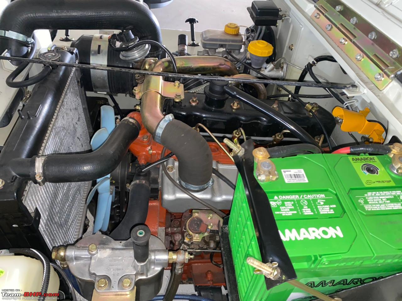

Engine Bay.
Legend Reborn | Mahindra Major 4x4 (CL550) | Found in the ravines of Chambal-engine1.jpg
Engine Bay.
Legend Reborn | Mahindra Major 4x4 (CL550) | Found in the ravines of Chambal-engine2.jpg

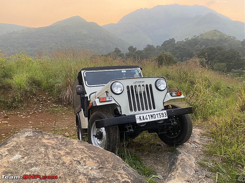

Wayand hills.
Legend Reborn | Mahindra Major 4x4 (CL550) | Found in the ravines of Chambal-wayanad2.jpg
Wayand hills.
Legend Reborn | Mahindra Major 4x4 (CL550) | Found in the ravines of Chambal-wayand1.jpg
Wayand hills.
Legend Reborn | Mahindra Major 4x4 (CL550) | Found in the ravines of Chambal-img_6606.jpg
Wayand hills.
Legend Reborn | Mahindra Major 4x4 (CL550) | Found in the ravines of Chambal-img_6603.jpg
Wayand hills.
Legend Reborn | Mahindra Major 4x4 (CL550) | Found in the ravines of Chambal-img_6605.jpg

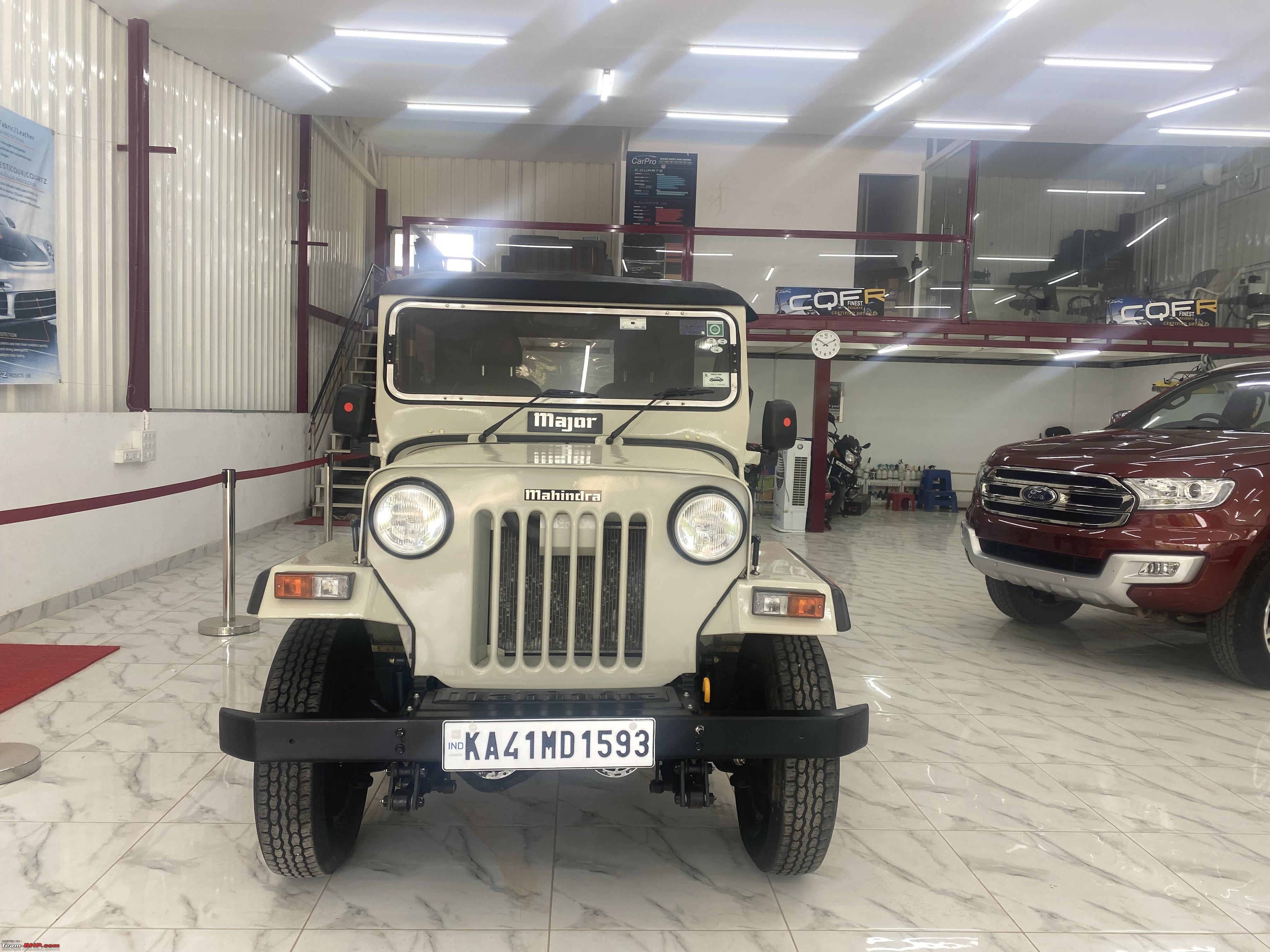

After a quick spa at Bengaluru.
Legend Reborn | Mahindra Major 4x4 (CL550) | Found in the ravines of Chambal-img_6557-1.jpg
After a quick spa at Bengaluru .
Legend Reborn | Mahindra Major 4x4 (CL550) | Found in the ravines of Chambal-img_6556-1.jpg
Legend Reborn | Mahindra Major 4x4 (CL550) | Found in the ravines of Chambal-img_7240.jpg
Legend Reborn | Mahindra Major 4x4 (CL550) | Found in the ravines of Chambal-photo20210206091058.jpg
